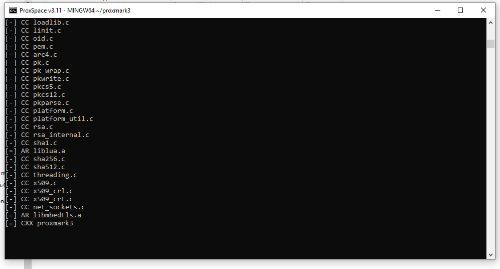

The first time I typed the command correctly but the process froze…, now I have recreated the situation and
the job freezes always at the same point (see attached)

well, I made it, the only way was tu use the “make clean && make all” command without the -j8 parameter, i don’t know what this is for but it did freeze the building process… now the client is up & running,

The -j parameter (for jobs) controls the degree of parallelism when building the target. Essentially it is the maximum number of build steps that can run at the same time.
If you omit the -j argument, the build will only operate on one file/step at a time (essentially as if it was -j 1). If you are getting freezes with -j 8, then you might be oversubscribing your processor. My general rule of thumb with make is to use a jobs value that is one less than the number of logical cores my system has. You can find this number by running the command nproc in Linux, or echo $env:NUMBER_OF_PROCESSORS in Windows (Power Shell).
