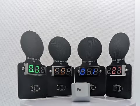

(*****) 13.56Mhz Field Meter by MidWest Gadgets
Love this picture, one of the funniest product photos I’ve seen
INTRODUCTION
These field meters are tuned to detect any standing NFC field. They will display a value of 1/10vm or 1mH (megaHammy).
They come in 4 different colors (Red, Orange, Blue, Green) that will be selected at random. (if you put in your order notes prefference i will do my best to accomodate).
I cannot guarantee accuracy. But i can guarantee that the meters are accurate to themselves. Meaning each meter will display the same value across each other. If in the future i can get my hands on more precise NFC field testing equipment i can zero these in more and will update with future version releases.
TESTING INCLUDING Mega Hammys shown
PM3 RDV4
PM3 Easy (hf tune)
2892 mV / 2 V / 5 Vmax
Flipper Zero
ACR122U
TEARDOWN
nope
PROs
• see what was previously unseen
• Small, portable, powered by 2032
• Comes in a selection of colours
• Can be used like a field detector for optimum placement of implants of Repeater stickers
• .stl for case already available
CONs
  • Can’t measure phones (that is more of a failure of the phone, not the Field meter)
  • Fragile, due to exposed components (i personally like that look and feel)
  • CR2032 that will not be included
    ( I was struggling to find fault, its a simple fix, and no alternative due to shipping regulations) But its like getting a toy at christmas without batteries, So make sure you have a 2032 handy
PRICE
USD$50
BUT
SUMMARY:
A thing that didn’t exist, now does. (Thanks Hammy)
We can now measure and see the field strength of a variety of readers, allowing you to compare readers to visually determine if a reader could likely work with an implant , which adds another tool for fault finding to our RFID toolbox.
Locate antennas and find best placement for implants and/or repeaters

I am really disappointed that I couldn’t get this digital version to measure field with low duty cycles so I’m working quick to get a version out that will have both an analogue meter and digital meter so you can more precisely take measurements of all devices. The hold up I have is waiting on a supplier to send me some of the actual analogue meters so I can get measurements for assembly holes.
Once those come in it will be a pretty quick turn around for me to get a version of this out that can measure phones, most battery powered readers and low powered devices.
But with that aside I’ve had a lot of fun playing with this.
pffft, as I mentioned in my review; you made a thing that didnt exist, and measures all but one thing, I still think that is pretty awesome.
If it makes you feel better, ai was going to give you 4.5 :star: , but I cant do halves, So ai rounded up to 5.
So there you go, I hope you feel bad :wink:
That’s even more important than the product; You made it, you enjoyed it AND you shared, it doesn’t get any better than that
Thanks
