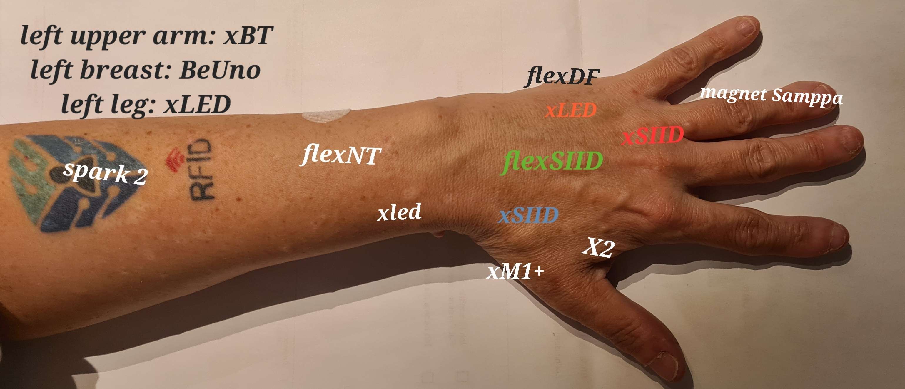

Has anyone implanted 2 implants into the webbing of their hand? I’m planning to implant a xSIID right next to my xEM like this
i’ve got 3 sharing that space in each hand, as long as they’re at least 5-10mm apart you shouldn’t have issues with them knocking into each other especially after they get encapsulated by your body.
having a Low frequency (xem) and a High frequency (xsiid) in close proximity to each other will cause no problems with interference of signals

You have all the answers you need above, nothing much I can add, except I "made my own “xMagic” before they existed as a 2in1 " and they shared PO with an xM1 and and xEM and I never had any issues
I had a Spark there and moved it, to make space for those 2.
Which I subsequently moved to make way for an actual xMagic.
If you wanted to go for 3, you could probably only realistically go for an xLED and since you have an xSIID, an LF xLED might be an option
You could probably put them closer together than your picture ( as mentioned >= 5mm ) but remeber to corral them, by placing a chuppa chup stick between them and tape it down whilst the new one encapsulates.

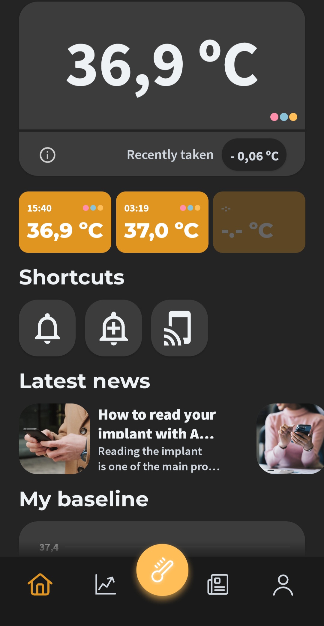

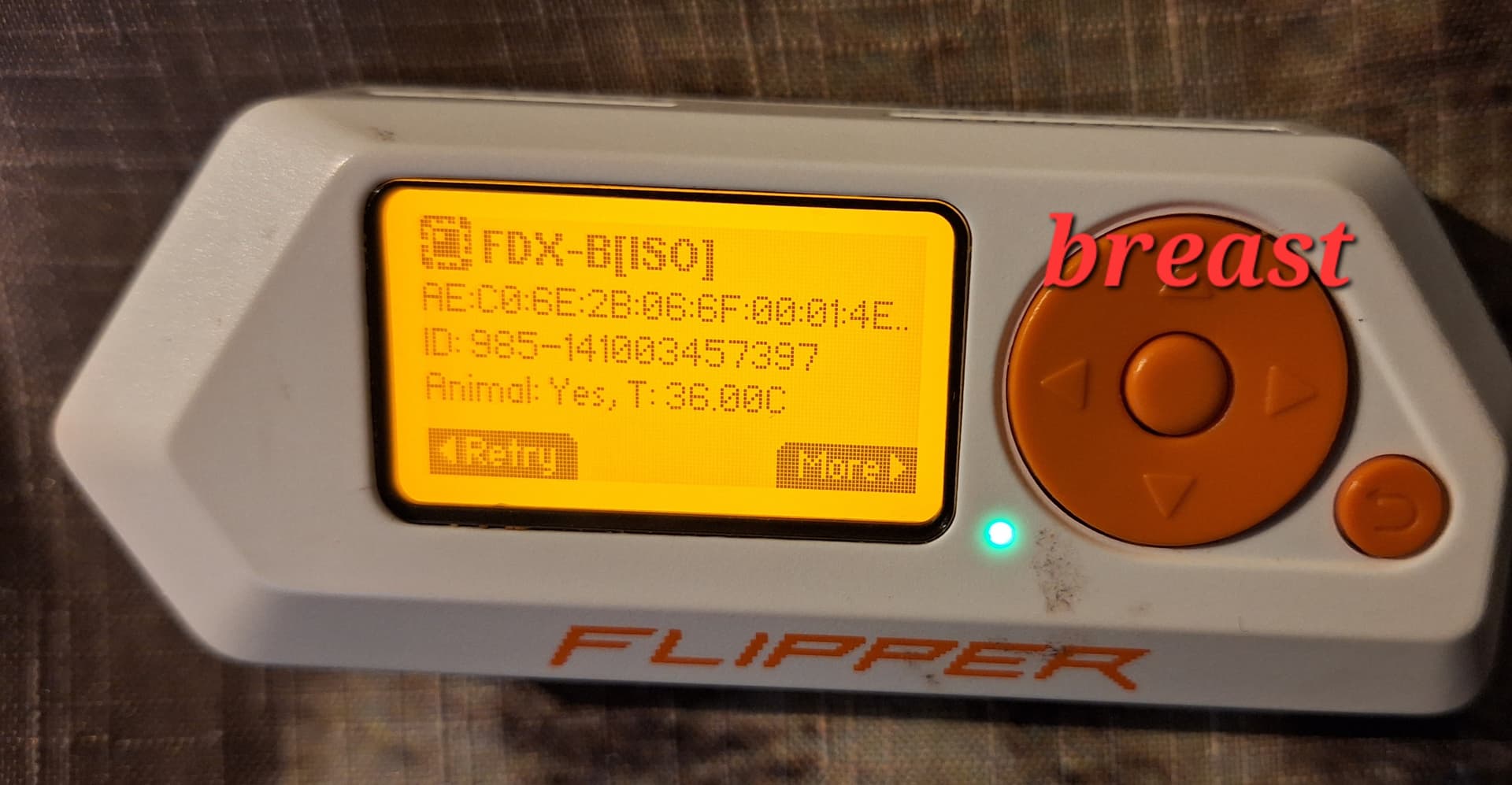

How far off are the variances betwene the XbT and beUno?
I will make pictures when I’m at home. I will rwad both xBTs and my BeUno

Do you have any posted photos of the 3 implants together in that position?
I got a pair of xleds blue and red and was thinking to install them close to my xsiid in left P0 and my xmagic in right P0. Would be cool to have 3 shinning leds in my left too though ![]()
