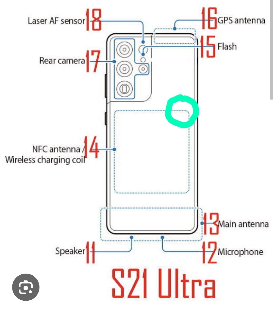

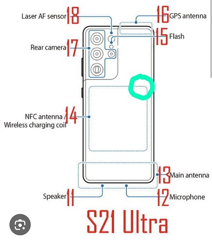

A couple of things
Heres the NFC antenna location.
(Amazing what google will tell you)
I have drawn my best guess
BUT

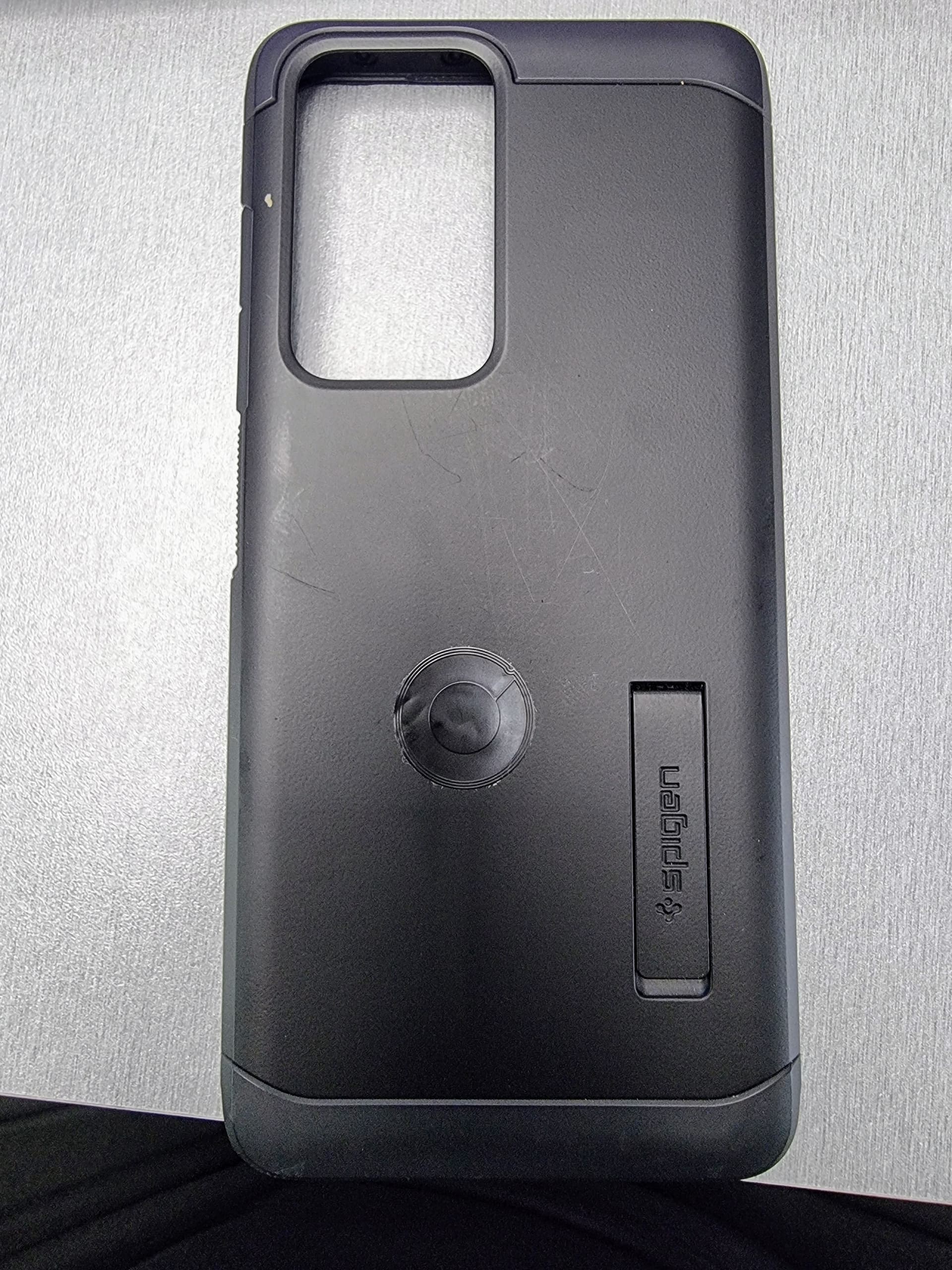

That case looks like a battery case which may significantly reduce your performance.
I have the Samsung 23ultra+
my repeater sticker is where you’ve marked with a green circle and works quite well!
Can I stuck them? Like, put one on the phone and one on the case
Its not a battery case, but its a very thick case
