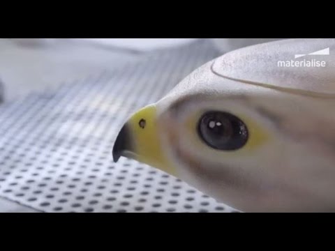

Robird RPAS (Robird Remotely Piloted Air System), industrial quality artificial bird with a powerful flapping wing flight principle, the same weight and there same appearance as a real bird.
