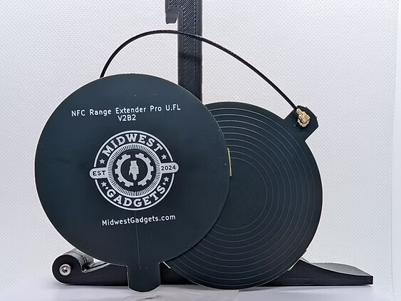

I “recently” got the U.FL (IPEX) version of the Extenders
(I also have the JST and SMA version; See the top post where I reviewed these )
I now have both the 60mm Pro and the 27mm Pro Implant version along with the 150mm cable plus 300mm cable. I played around with the combinations.
Borat Great Success GIFs | Tenor
The results were close enough to identical to my above testing ( VERY GOOD - but I fucked up my post and lost the testing data) and as you would expect, the implant version works better with implants and this is the version I would recommend to the cyborg community.
If I was to further recommend, it would be, choose the version that suits your purpose, if you are trying to do a low profile discreet install, go for the U.FL (IPEX) version of the Extenders, whereas the JST and SMA versions would likely be more suitable for a robust project.
