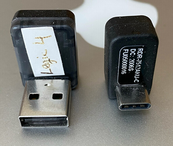

Rdr 7511aku is likely what you want
First digit
6 =125
7=13.56
Last digit
1=keystroke
2=sdk
I’ll post some better info I found
First digit
6 =125
7=13.56
Last digit
1=keystroke
2=sdk
Yep I just figured out a few of their digit’s meaning. And no, that’s totally not what I want
I want a 6311 ![]()
6 → 125 kHz
3 → HID Indala
1 → Vertical
1 → Keystroke
I think…
What I’m wondering is if it only does HID Indala, or if all readers do a few “usual suspects” like EM as well.

I got a reply from the Wave rep. Nice guy, pretty helpful answers to my questions too.
The short of it is:
Which sucks a bit for the price, I’ll have to give a good hard think about which one I want to get, particularly as I want more than one.
