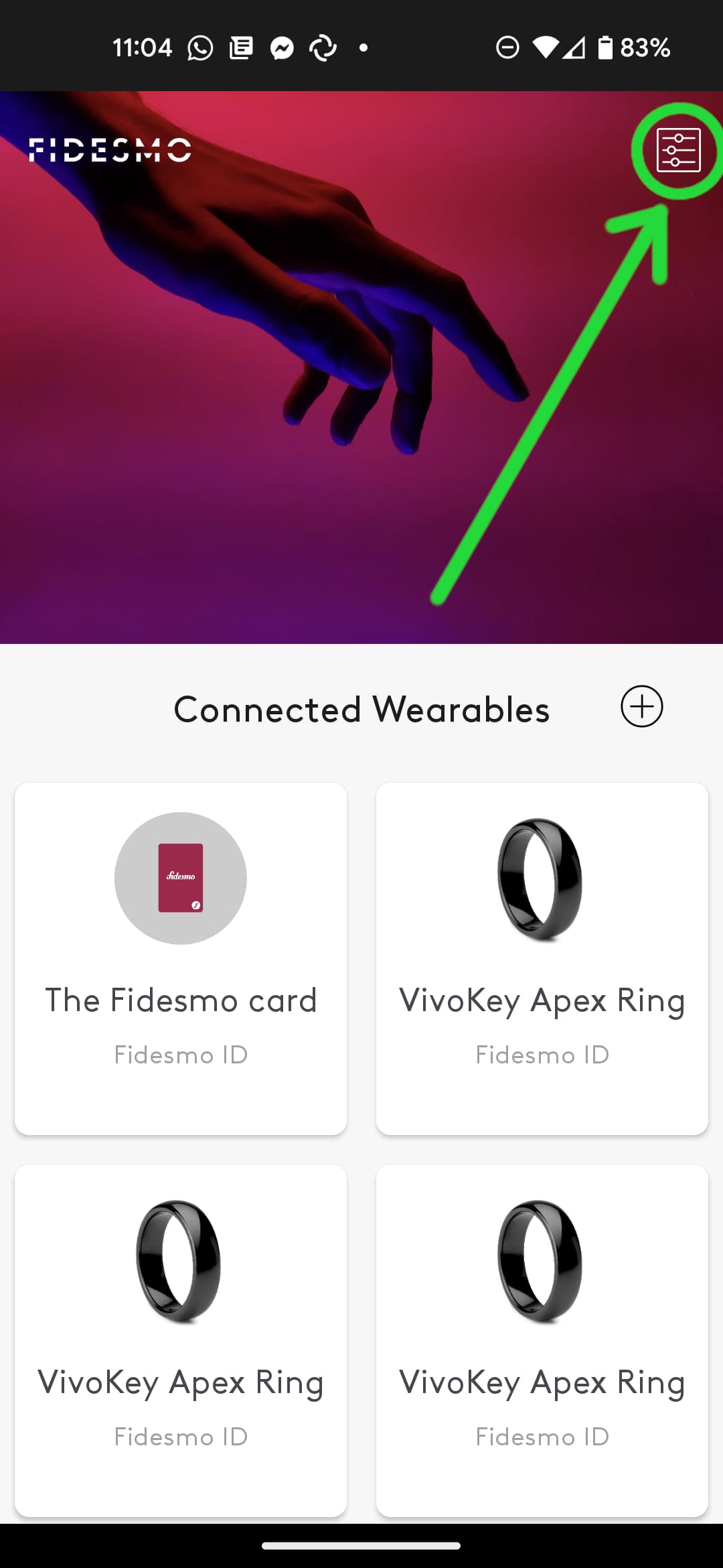

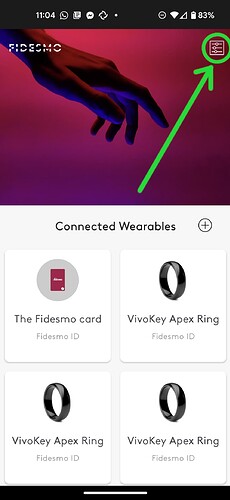

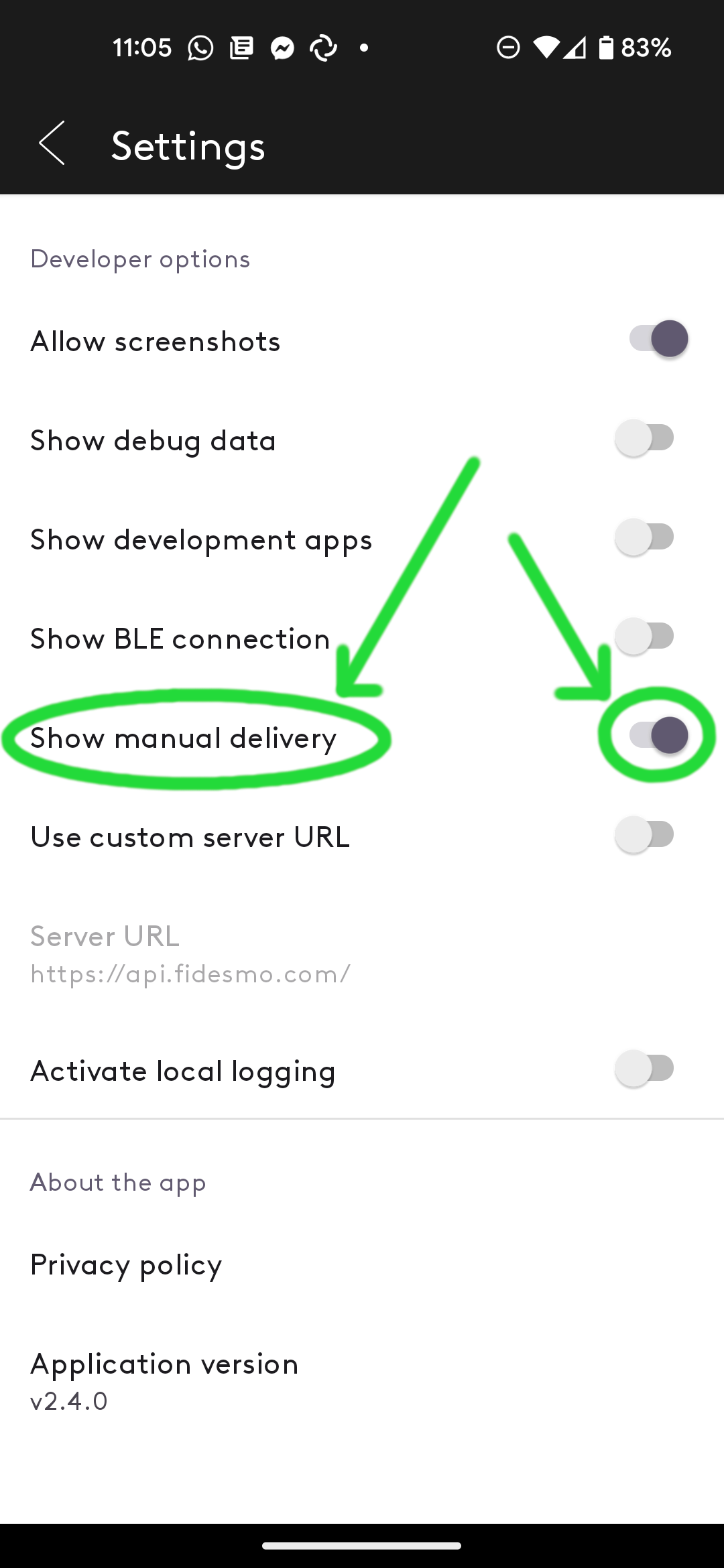

Open Fidesmo app on your phone. Go into “Settings”.

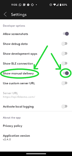

Enable the “Show manual delivery” option.

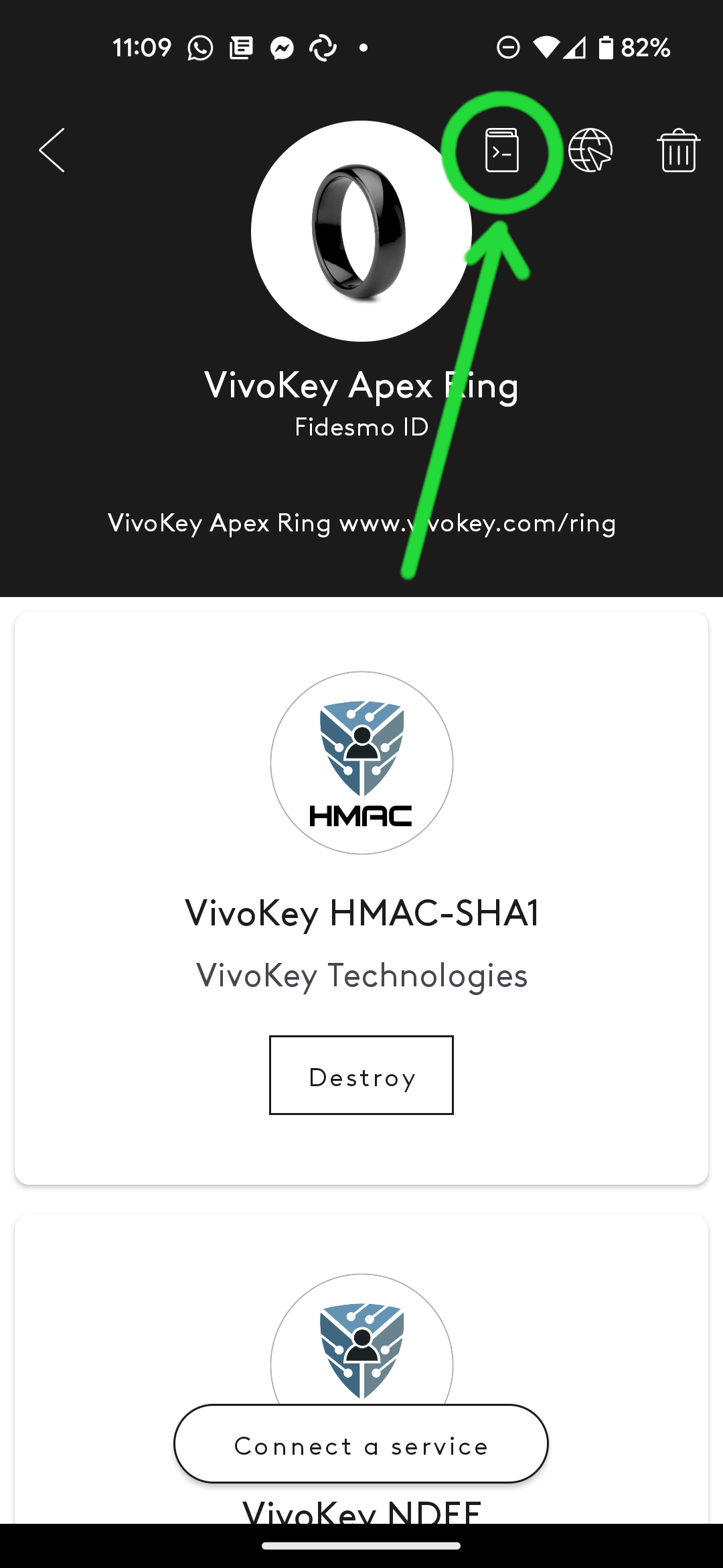

Scan your Apex to enter the device menu. Tap the manual service delivery icon.

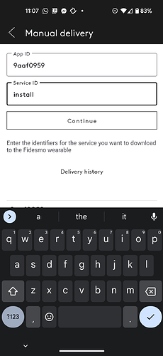

Enter the following values; App ID = 9aaf0959 and Service ID = install and tap continue.

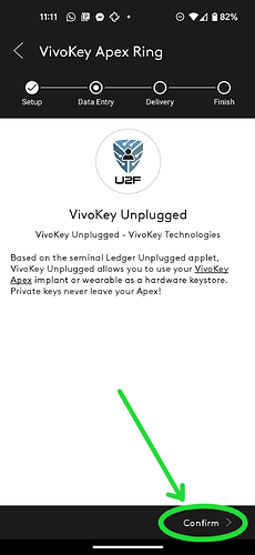

Tap confirm

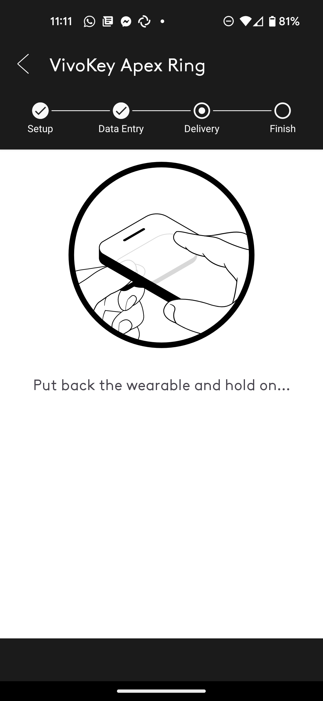

Hold your Apex to the phone.. for a very long time.. a very. long. time.

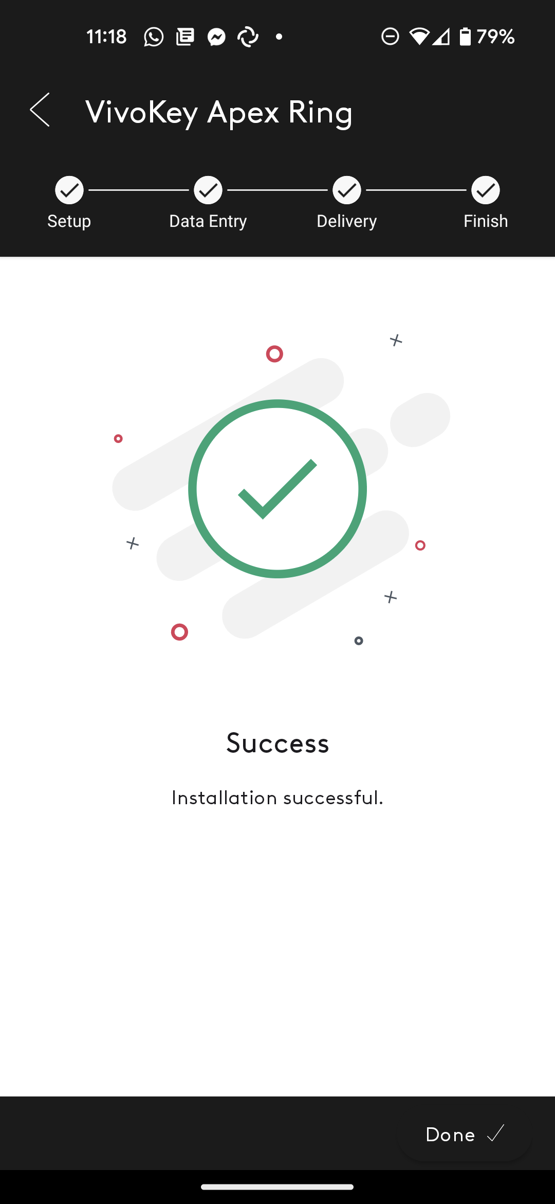

After a significantly long time, you should see a success screen.

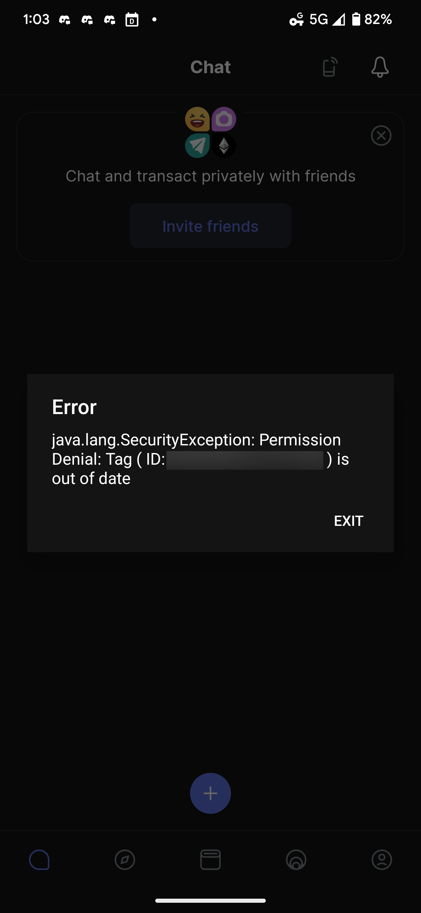

I’m getting this error after not using the Status app for a while. Any ideas?
Hmm no ideas… might have to ping status app discord?
I got the same error!
