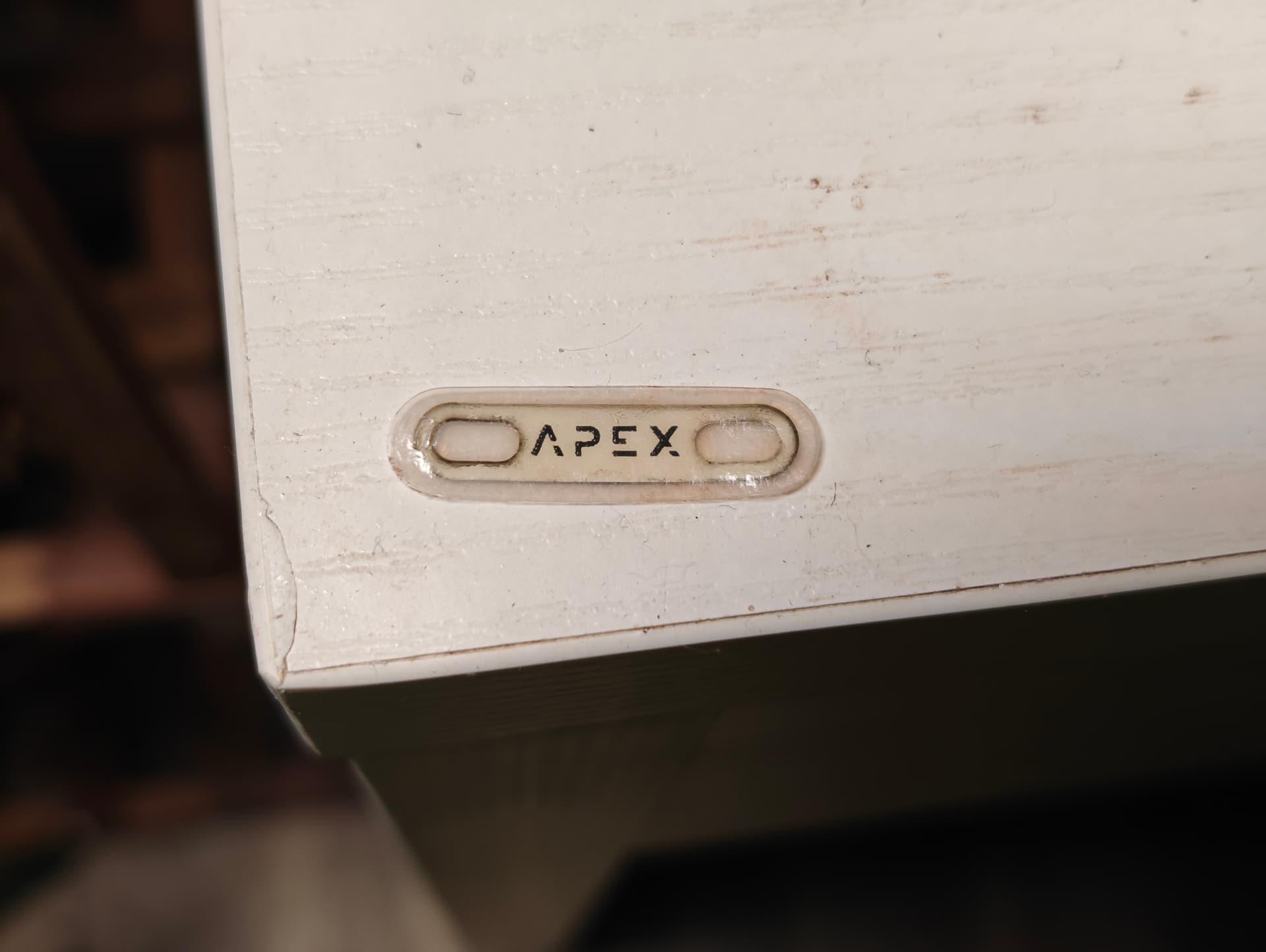

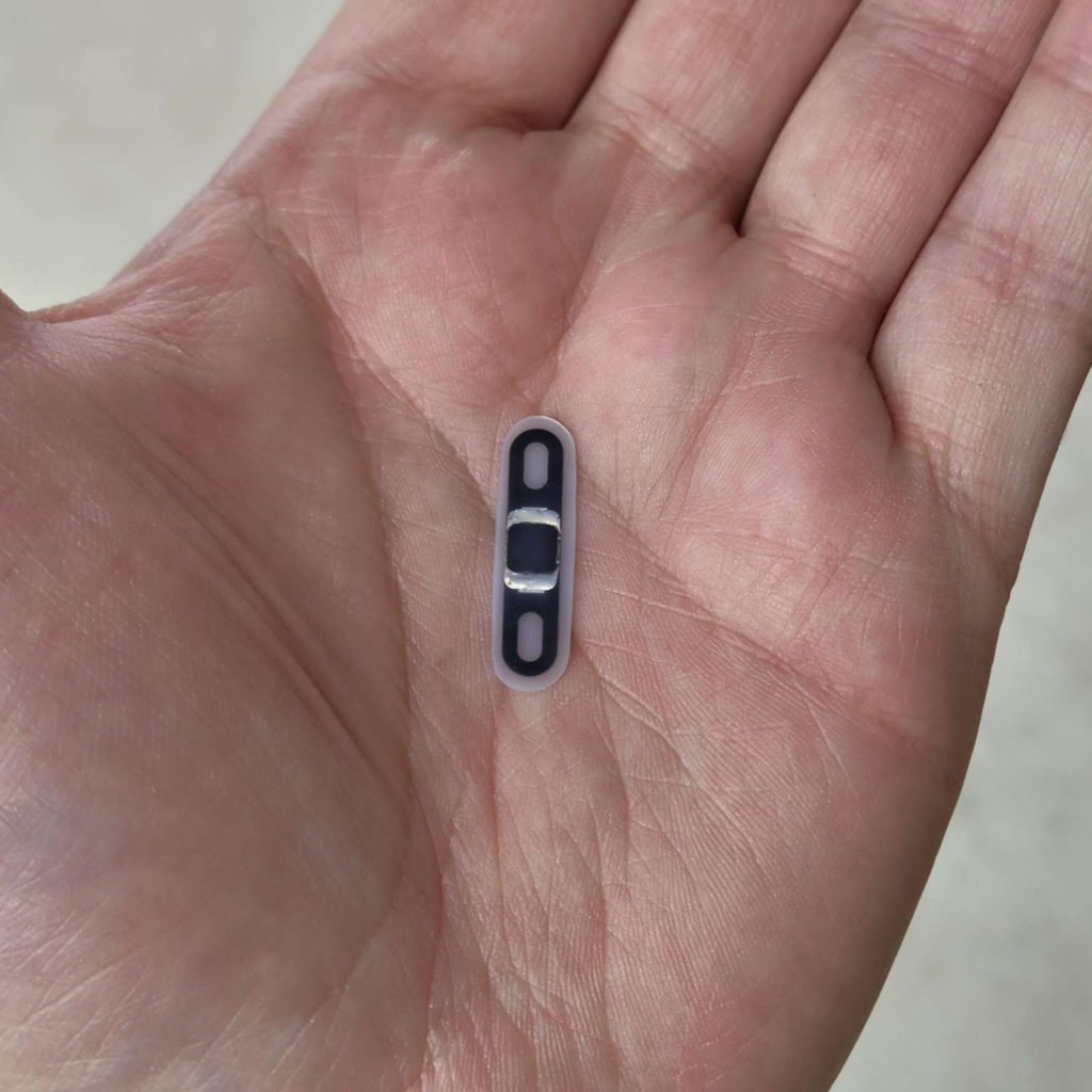

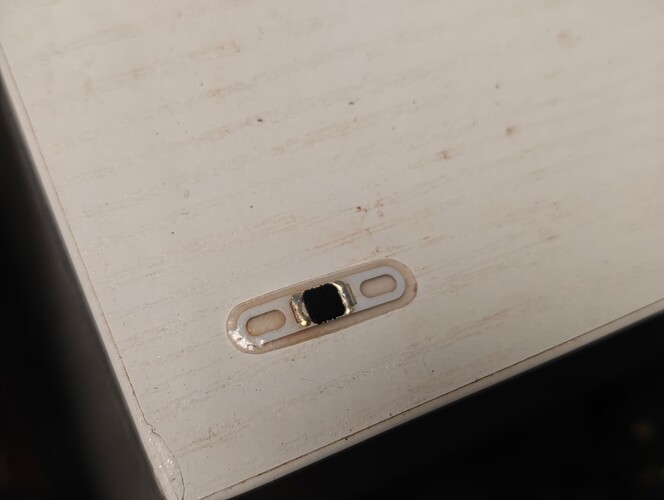

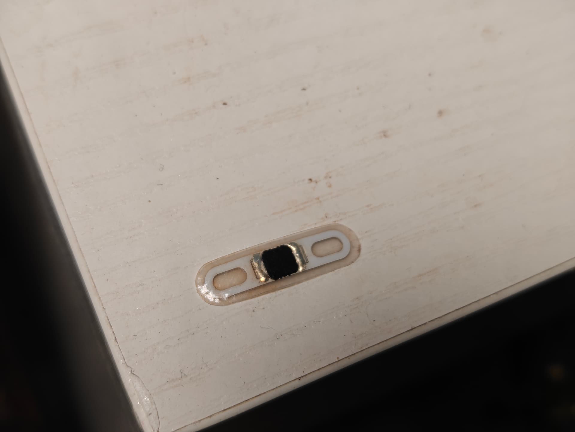

I am curious to see what it looks like when removed. I had an identical experience about one month ago. Used my Apex daily for over a year, and boom, dead.
Table is dirty but the implant was wiped with alcohol thoroughly. The mark on the left side of the first image is from forceps during the removal.
Thankfully DT made it right and the new one is working great.
We are looking forward to putting a collection of failed flex through x-ray inspection later this year to determine failure modes and see if we can improve the design.

My hunch is the copper pathways in the polyamide flex PCB which make up the antenna traces are probably fracturing inside the PCB. The x-ray inspection should reveal this. Second possibility is a break in one of the vias on the board.
Untented vias can be filled with solder to make them stronger and filled vias are also available from some fabs although I’ve never used them. But who am I kidding, Satur9 probably told you about these options already.
We’ll see what the x-ray inspection reveals and work toward solutions… but yeah options are out there.

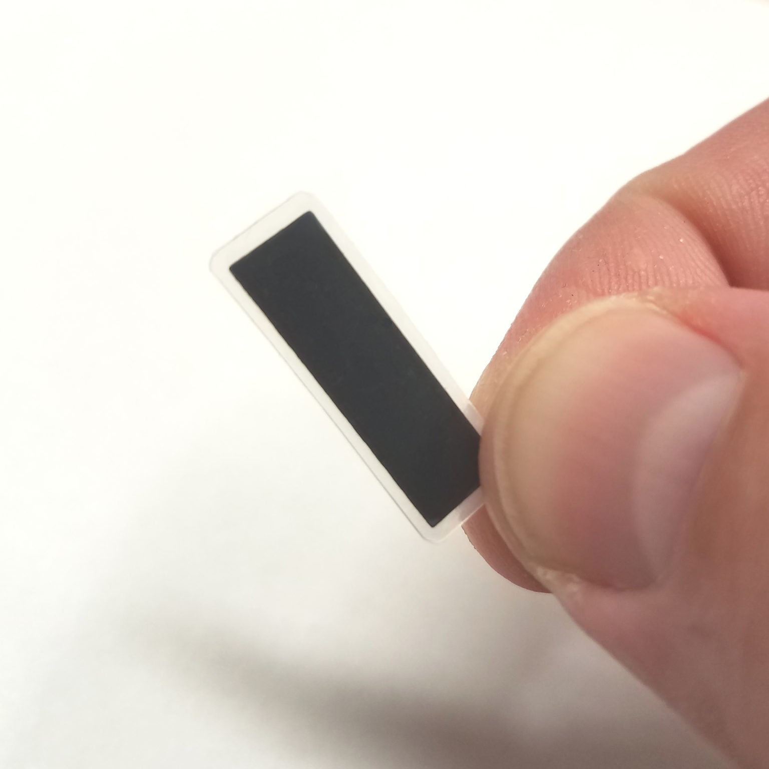

Where and what is this bad boy? :heart_eyes:
Can I just appreciate how nice your nails look. Even after a manicure mine are never this smooth. My poor thumb has so many indentations from poorly judged Hammer blows it looks like a discarded amazing box.
FlexM1gen2 P1-R
Ha, Pulled from the DT webstore…Those are probably Amals pretty nails
