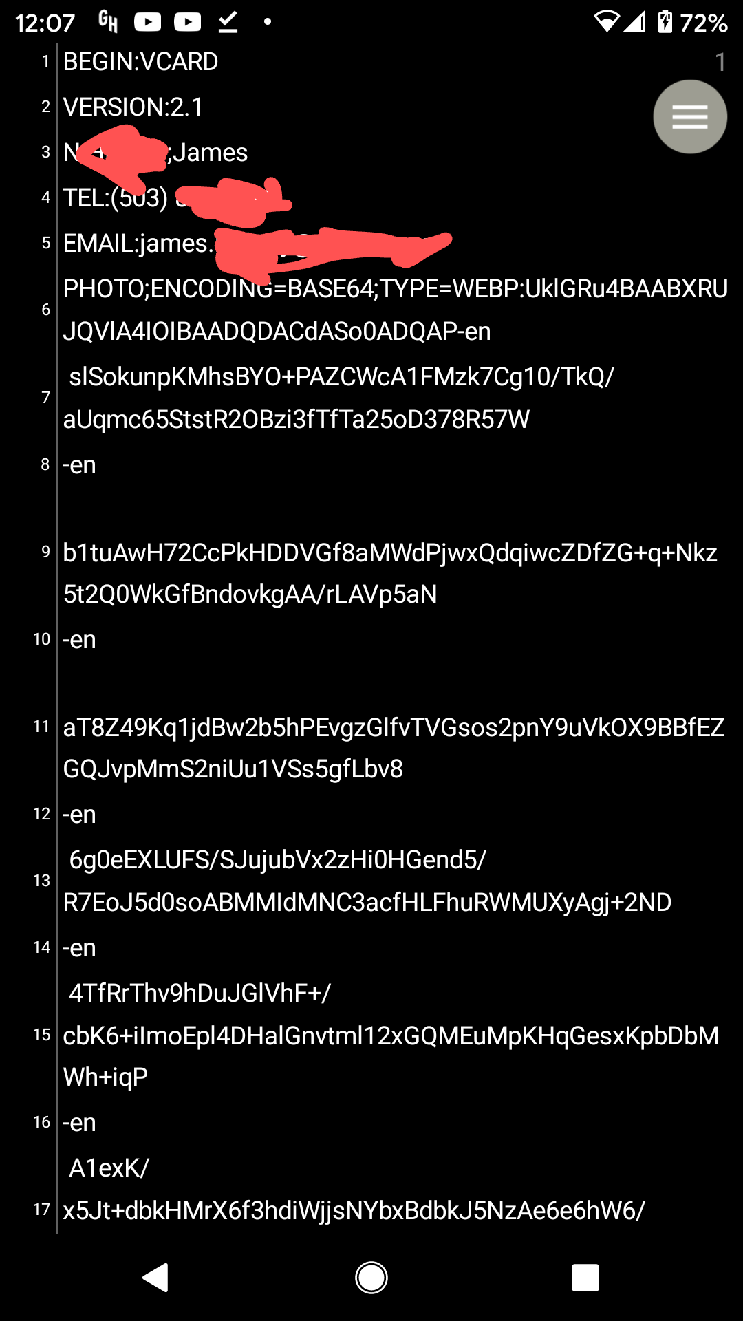

I haven’t done too much digging yet, and I’m just comparing the jpeg+webp script, not your new one, but there are some differences in my output compared to yours.

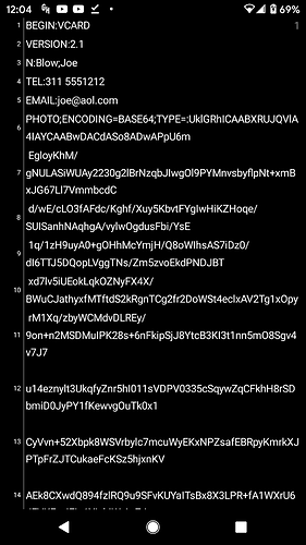

Yours:
Mine:

In those two screen shots, I’m mainly talking about the base64…webp, yours doesn’t have that for some reason. Also all of the -en tags that mine does have.

There is a line in the script;
echo -en “\n $L” > > vcard.vcf
This is adding a new line with a -en in it. You can see these in the screenshots I posted before. These need to be removed, which also lessens the space, then I was able to run the ndeftool command and rebuild a new .ndef file:

I didn’t mean that line needs to go, I just mean, I removed the -en and then deleted the empty line (see the screenshots) I just manually edited my output to look like yours and now the picture works.

Hmm I’m very confused… You do run this script on a standard Linux box with bash on it right?
Because the -n in “echo -n” disabled the automatic LF. If yours inserts one, that would create empty lines, but it’s not normal.

EDIT2: if your shell isn’t bash, or some messed up version of bash, try “echo -e -n” instead of “echo -en”. The -e switch enabled special characters, and the -n switch disables the normal echo linefeed. Normally it’s okay to specify both flags in one argument, but if your shell is dumb, it might take -en for something it needs to display - hence your LF-terminated “-en” lines.
