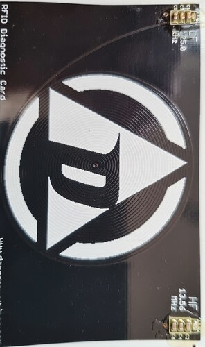

So, since you don’t currently have any diagnostic tools, what you could try is:
Illuminate your card from the back, and try to identify the antenna
If it is HF, it is likely a rectangular antenna that runs the perimeter of the card.
:card_hf:
If it is LF, it is likely a circular coil in the middle of the card.
:card_lf:
All of my issues LF cards have been rectangular
The only visual key, was that the LF antennas were thick and chunk wire, and the HF was thin with a lot more wraps
This is the reason I said Likely and not certain
The only exception in my collection is
HID Prox II
Even if they are not circular, hf cards usually have a more squared off antenna with less tunes than the rounder antenna of an lf card (at least that I have seen)
