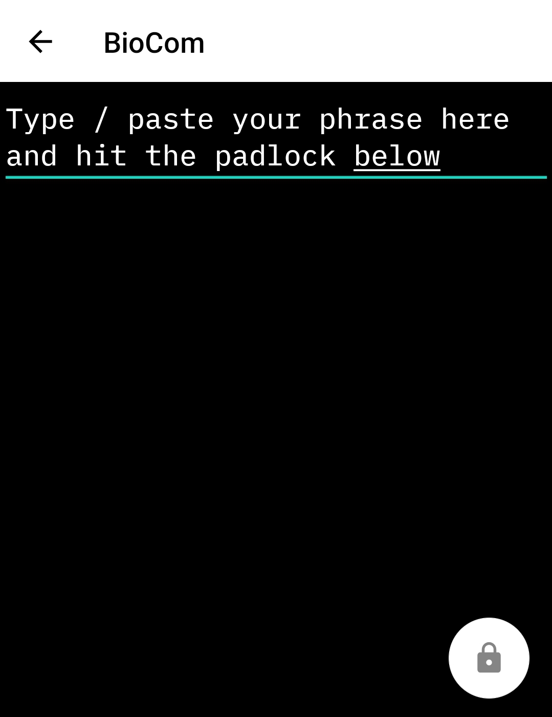

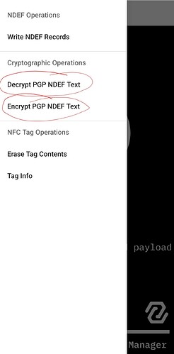

You could try BioCom
https://play.google.com/store/apps/details?id=com.hoker.biocom
I haven’t tried for a while,
@hoker might have a how to :man_shrugging:
But something like this
Then write the NDEF record
