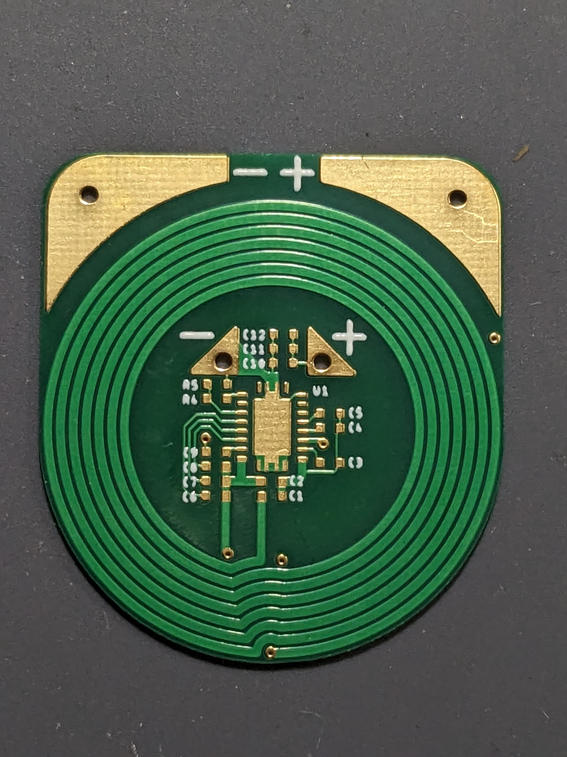

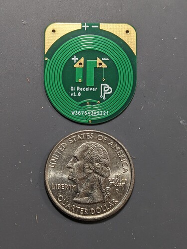

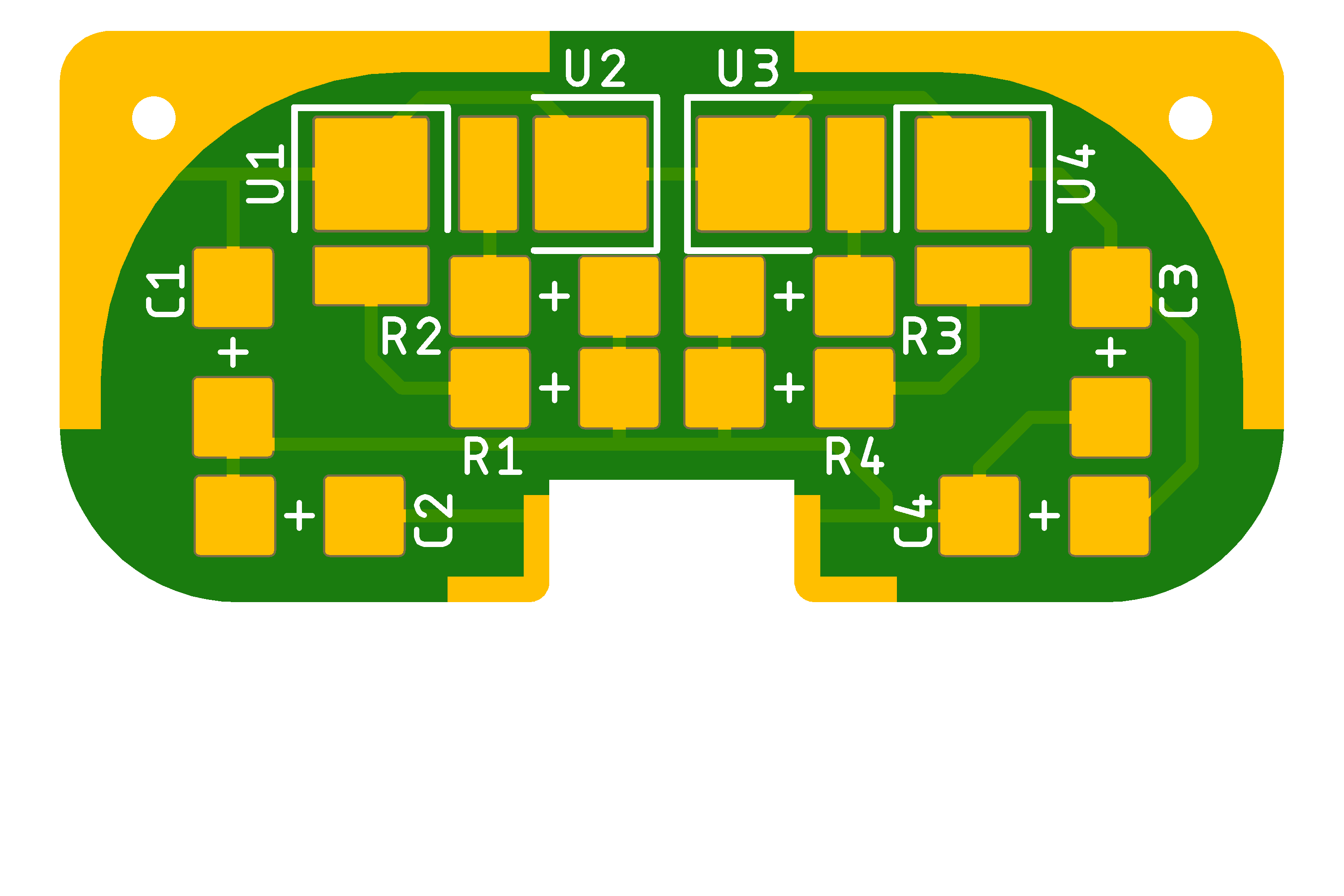

Forgot to mention that I designed a new version that’s much smaller and should have similar or better performance. Can expect 400mA at 5V. It’ll arrive in a day or two. Gonna bring some to grindfest.
It’s 0.6mm thick with the tallest part being 1mm. The total size is 31 x 26mm. Miana already made an LED add on board.

Is this just the Qi power component, no data or transmit module yet?
Regardless it looks sexy and I can’t wait

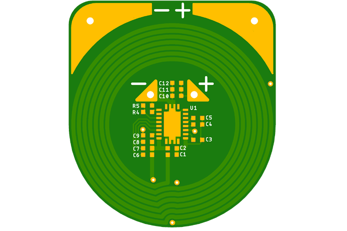

The previous version that I shared was pretty good, but it was really just a proof of concept. I’ve refined and miniaturized the design a bit. I’m kind of pushing the limits of how small a Qi antenna can be though, so we’ll see.
Yeah, this is simply for power delivery. I made it for the bodybytes, but it can be used for a lot of different projects. I may even populate a bunch on my CNC Pick & Place and sell them to hobbyists. Not sure. For now though they’re coming to grindfest and people might have other implant ideas they would be suitable for.

Getting consistent 500mA at 5V and the heat (on the chip) is manageable. Maybe 680mA at 3.3V, but the heat gets a bit out of hand. I need to make one more pass to fix a resistor, then I’ll be making them available for people to play with.
Here’s a module Miana made for it already
20230609_211513
Wouldn’t heat dissipate faster through the body (which is essentially like water-cooling) than in open air? So the in-vivo temperature threshold might be higher than expected. I’m not sure what kind of temperature internal cells can sustain for short periods like that…
That’s the plan. The entire heat dissipation right now is convection with the air. In the body it would be entirely conduction so probably better. Basically water cooled. You can see I added as much of a ground plane as I could afford on the bottom.
This unit will also likely be available for hobbyist projects outside the body though, since I can crank them out on my pick and place machine. In that case the max draw would be more relevant for the lifespan of the device.
