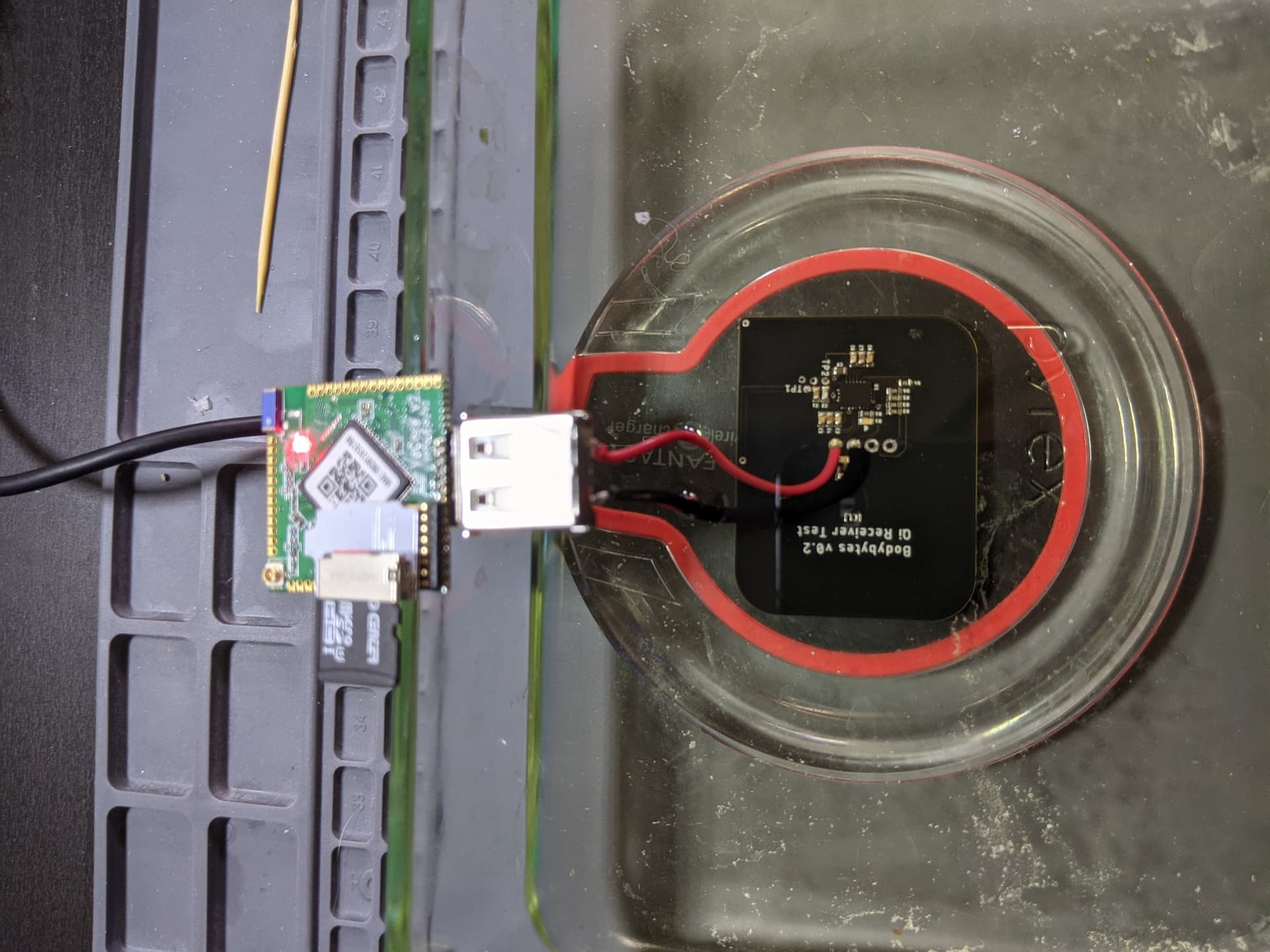

Not able to ssh in while it’s powered from the Qi charger. I used a battery monitor on my phone to see what kind of current the Qi charger is outputting. Here’s the conditions when I hook my phone up to a standard AC/DC adapter
Here’s the conditions when I hook it up to the Qi charger with a USB-A port attached
It looks like the current limit (which I had planned to be around 750mA) is actually turning out to be too low for the VoCore to get fully booted up. Maybe I can change the ILIM resistors (R4 and R5). Regardless the Qi receiver chip gets a bit warm. I’m not certain if having it inside the body will be good or bad for heat dissapation (I’m thinking good).
So I tested some stuff out. First I changed the R4 ILIM resistor from 330Ω to 140Ω. This would set the upper current limit to 1.07A (which I don’t think this antenna can achieve). The vocore still booted, was solid for 5 seconds, fast flash for 5 seconds, slow flash for 5 seconds, then it would soft reboot.

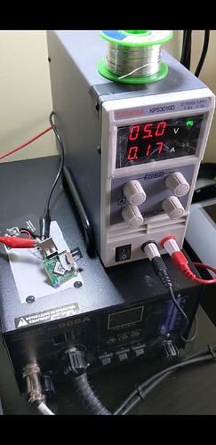

I then powered it from my power supply to investigate the power draw. Booting up peaked at 170mA and then settled at 120mA. It also didn’t go above 170mA while streaming video via gossa.
I then thought it might have been a thermal shutdown, because the chip was getting hot enough to hurt my fingertip. I immersed it in some oil which kept the chip very cool, but I still experienced the exact same soft reboot issue.

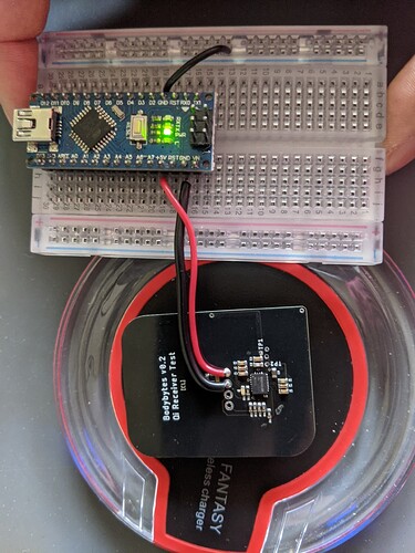

I then hooked a 1F supercapacitor up to the output and the vocore booted fully no problem. Looks like we need a bigger resevoir. I tried all the way us to 536uF and it still wasn’t enough. Now I’m going to look at what kind of capacitor bank I can make in a reasonable form factor. I’m thinking tantalum capacitors might do the trick. I’ll keep you posted.

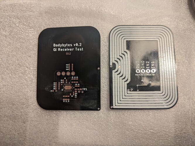

For now I wanted to share the Qi receiver PCB design as is. It could definitely use a bit of cleaning up if you’re intending to use it for any real application (remove the bodybytes specific silk and document layer markings, and maybe switch from 0603 passives to 0402), but it works pretty well as is. You can expect to source 250mA easily with this design. Feel free to use and modify it for whatever purposes you see fit. I don’t care if you credit me.
See this post earlier in the thread for C1 and C2 capacitor values:
QiReceiver[SCH].pdf (46.3 KB)
QiReceiverPCBFiles[bq51013a].zip (14.3 KB)
