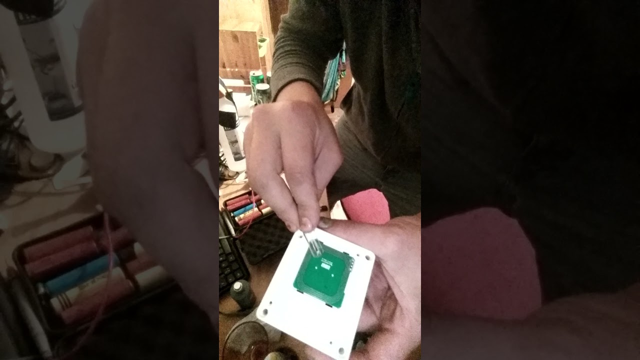

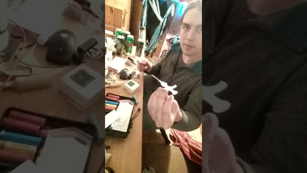

mrln used this HV boost converter device to create a spark gap that was so noisy in the EM spectrum that it fried not only an HF field detector, but a third party NTAG216 glassie
Here is several pieces of video evidence they submitted
I will dispurse the bounty reward to @mrln in whatever format they prefer, and renew it for any other forum members who can do so with a method other than the spark gap created by a chinesium high voltage boost converter.

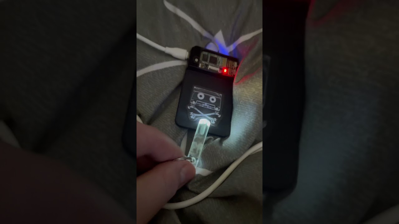

im guessing this doesnt count? <please count please count< it works in skin too which was a factor!
its an nfckill with 8 seconds of exposure not tested on skin but theory states it should work gonna get some pork and try it at some point
That counts, second completed bounty!
