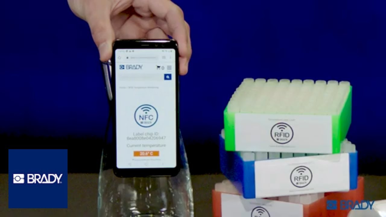

I have a pack of those NFC sensors on order for evaluation (the smaller NFC version, not the larger UHF one). Nifty little product. If you want to see it in action, here’s Brady’s marketing video:

Ok cool, that’s what I thought. They don’t look terribly different from a bullseye.
I’m ordering a bunch to assess a few things - range of course, how fragile it is (wouldn’t want to implant something that big that’ll fail within a week), and a slew of other things.
But most importanty, what I need exactly to get the temperature back: I don’t want some app / protocol that’ll prevent me from using my implant with my own code, or a buggy custom Android app that’s only available on Google Play that’ll quit working 2 years down the line if I don’t get the latest superduper cellphone.
The way I think it works is, when you scan it, it creates a NDEF with URL on the fly that points to a Brady server, with the current temperature in a GET parameter. That’s the only way Brady can claim no app is needed, and to achieve a scan history with a fully passive transponder. In the video, it looks very much like a browser with a URL line. Also, the sales literature says the address is configurable.
If that’s how it works, then either I can configure it to point to my own server, or I can intercept the URL easily with Tasker to extract and display the temperature, so it doesn’t hit Brady’s server. That would be perfect. But I want to make 100% certain that’s how it works.
