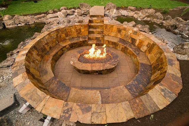

so i decided to rename the thread, and finally build this. a sunken stone fire pit…

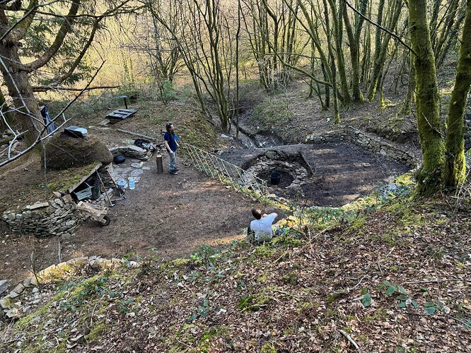

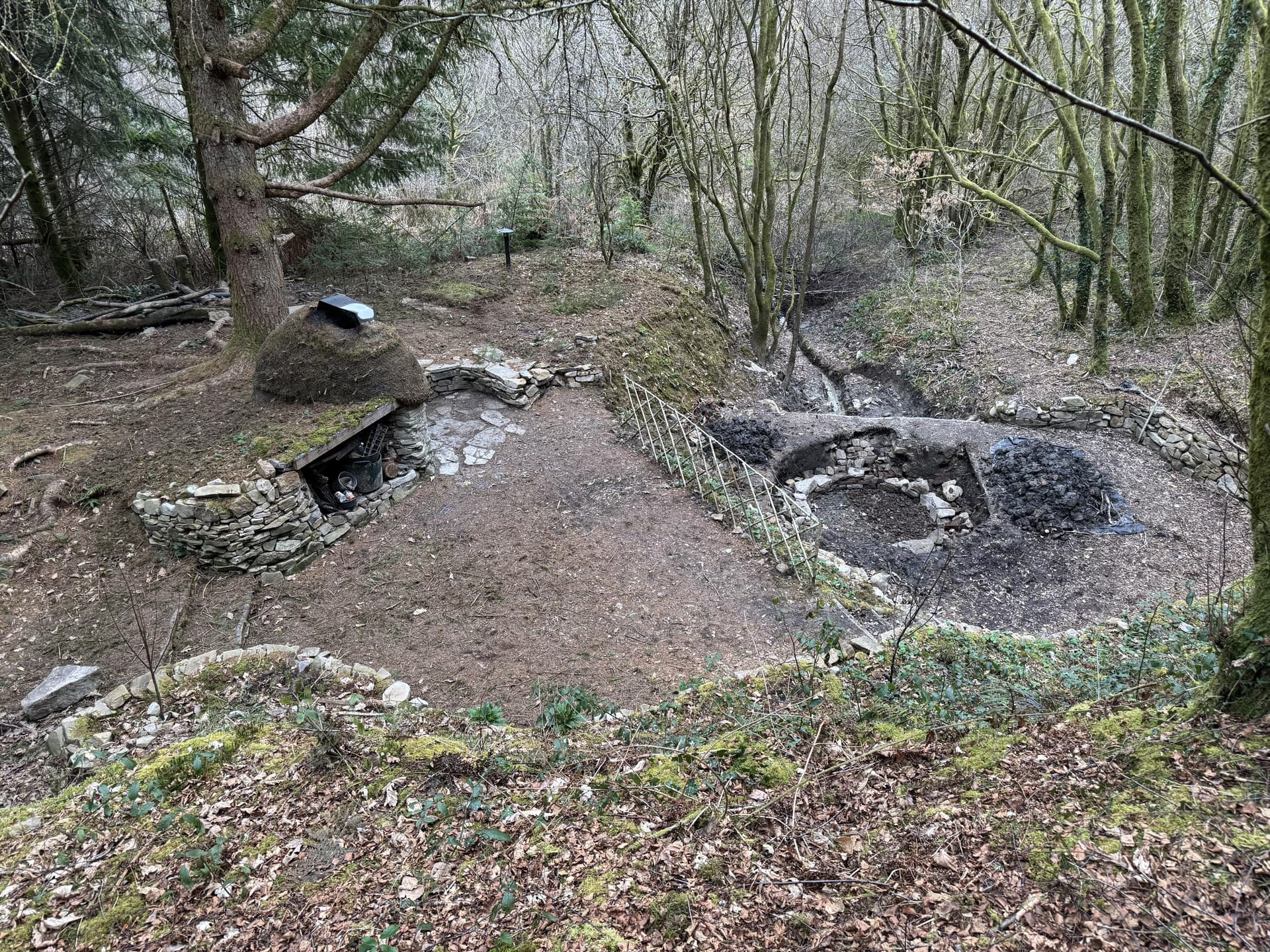

This is the garden of my tree house, my special secret space in the middle of no where… some of you know about it others will not. this year ive decided to make this area pretty before the hand of nature touches it, to take full advantage of the growing season. so i will be building the fire pit, turfing the area and planting a load of plants,and doing some things to the underground log cabin that we made last year. feel free to join me on this ongoing adventure… lets go…

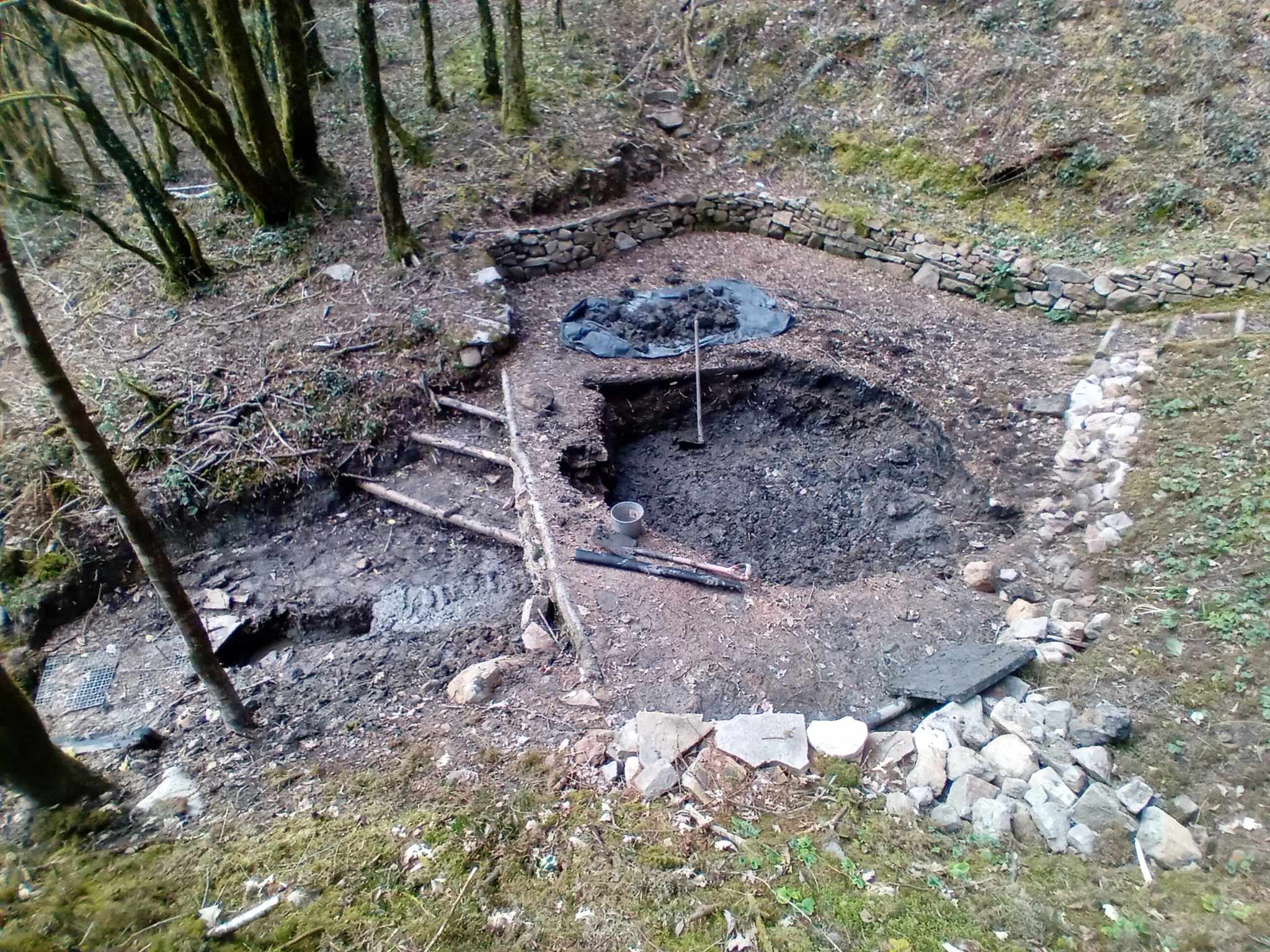

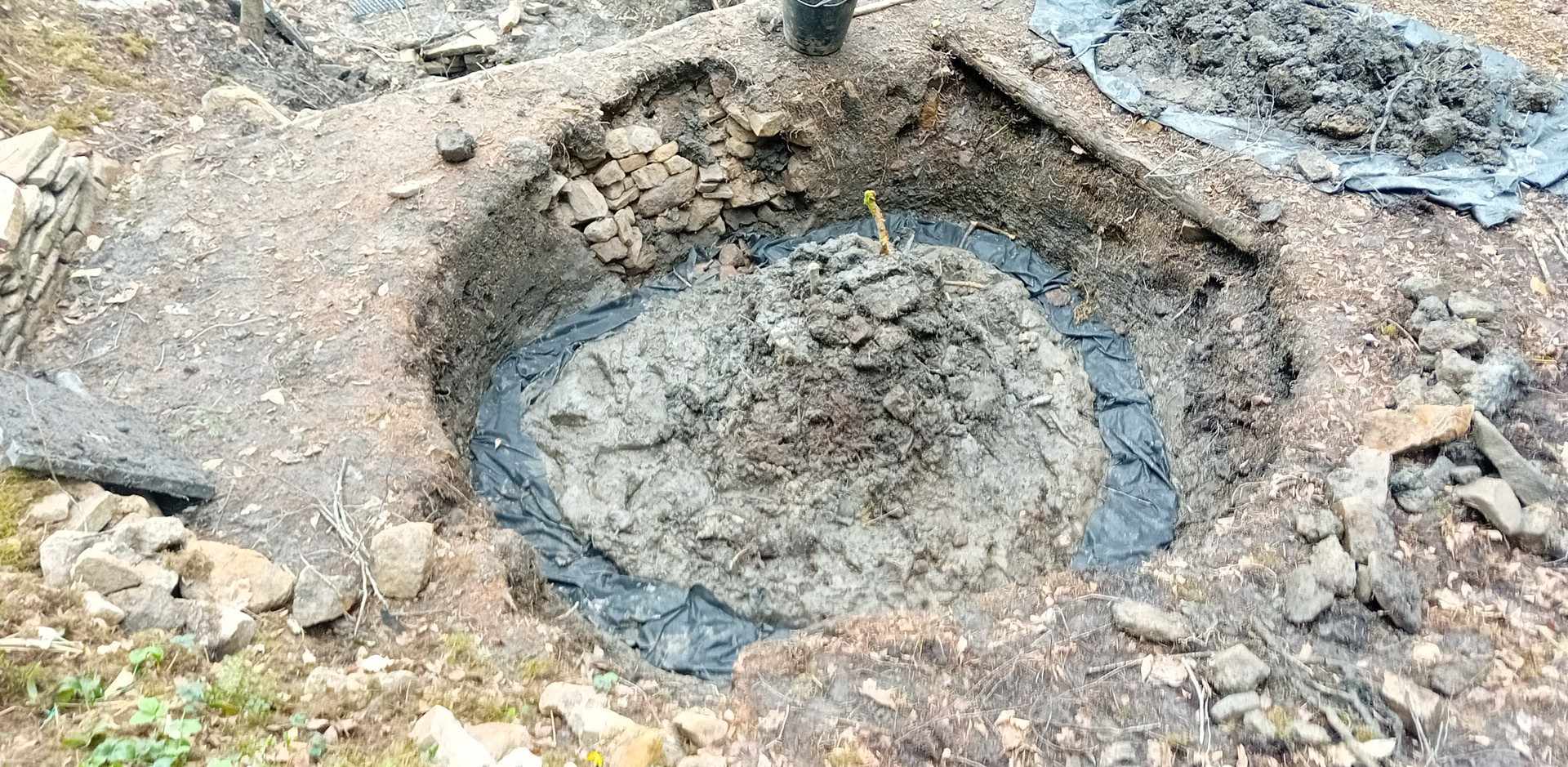

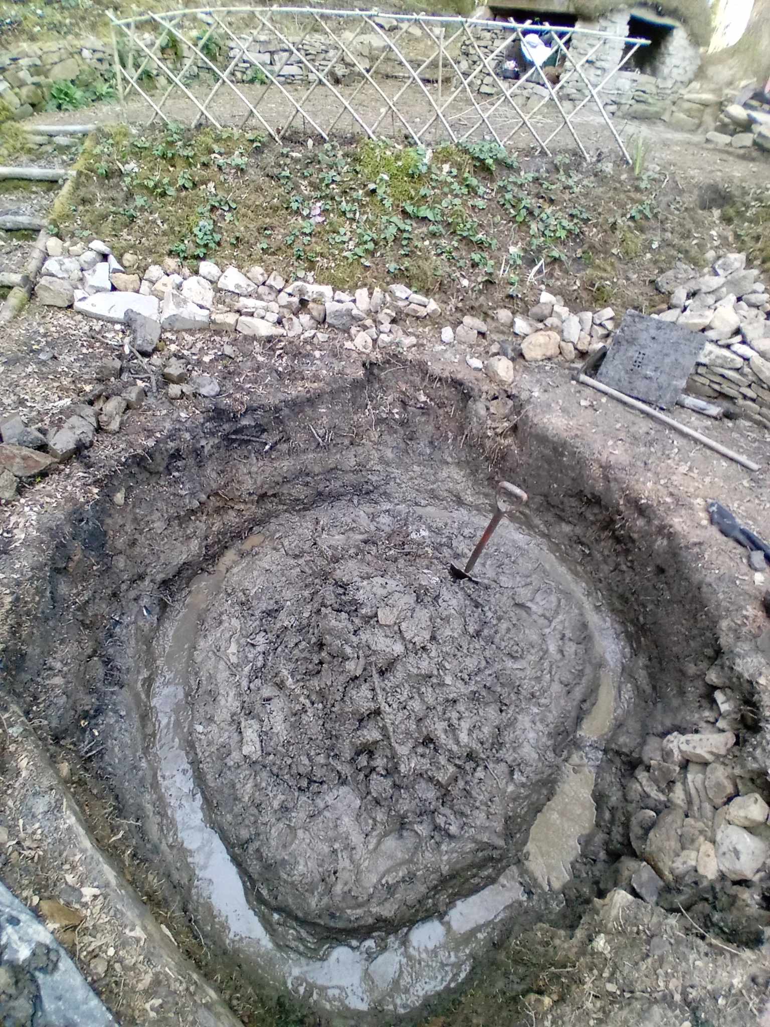

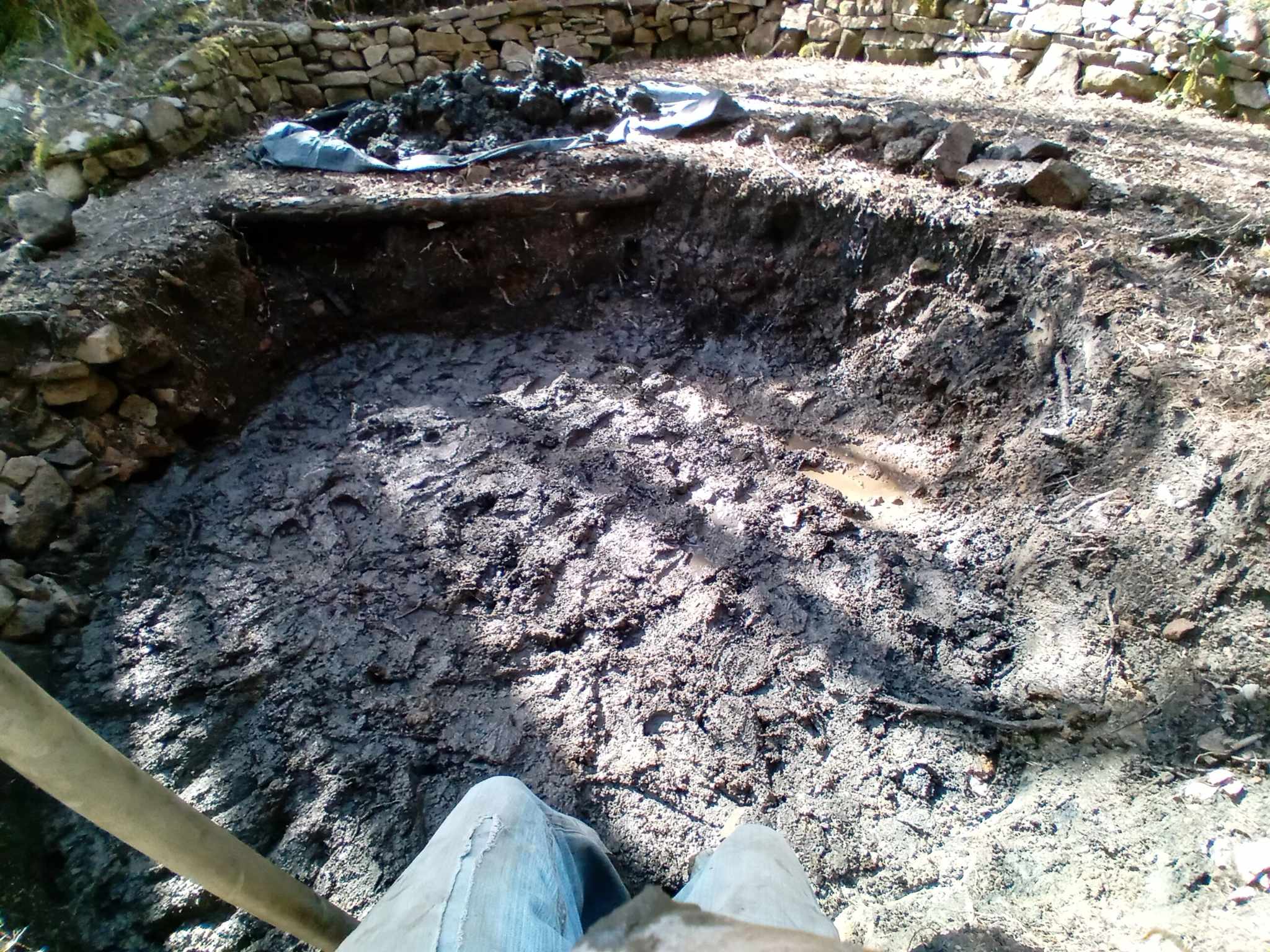

so here is my muddy hole i dug last season, its pure clay and its icky and made the lower phase boggy. so we dug a huge hole and installed a french drainage system. this seems to have done the trick, so first this needed to be dug level and a nice mote added to lower the watershed.

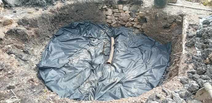

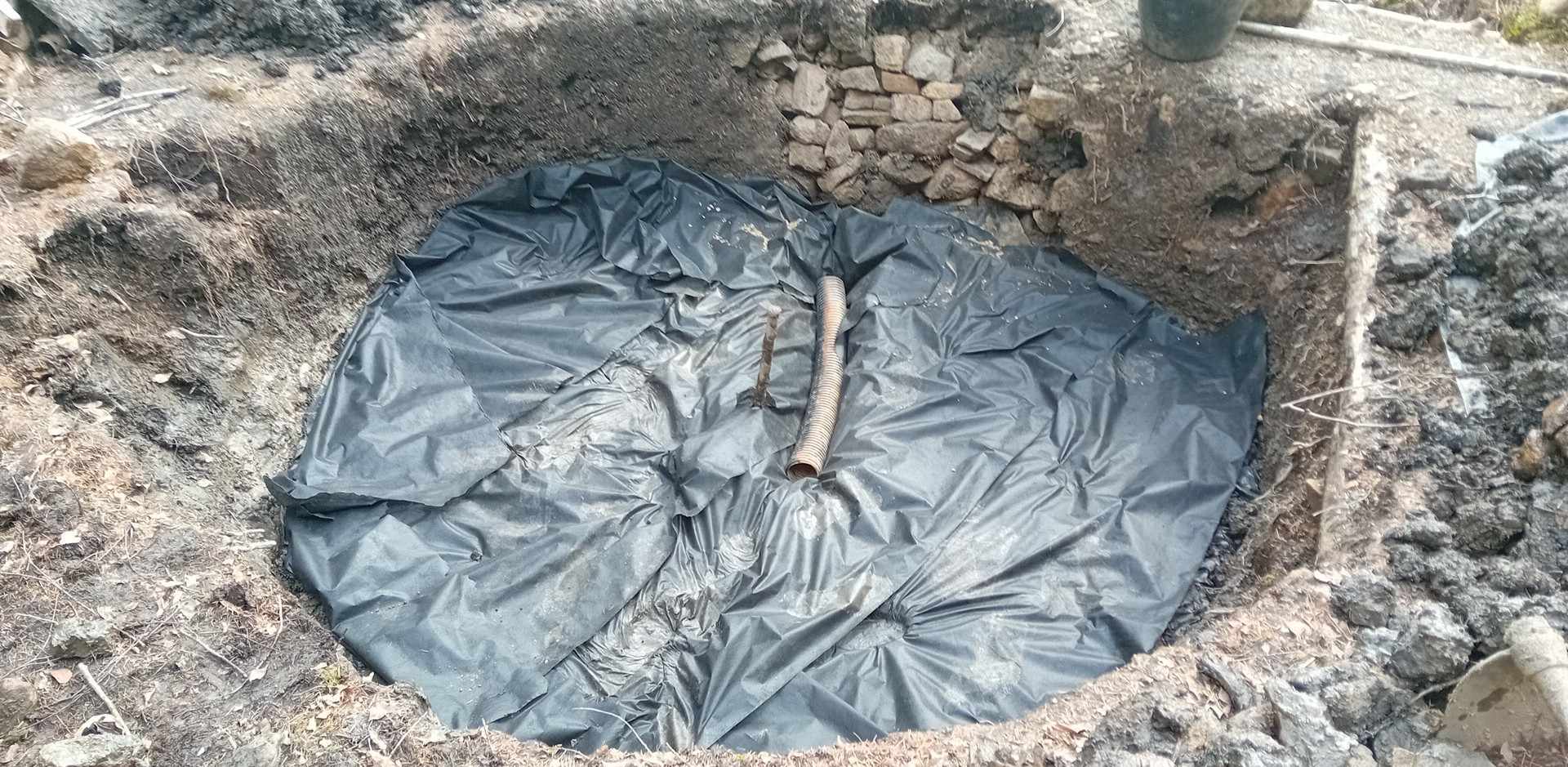

nom nom nom, i was caked in mud after this, now we line the hole with membrane and fill it full of gravel that needs to be hand collected… that took ages…
more digging to get it as level as i can before covering with more membrane and added a perforated pipe…

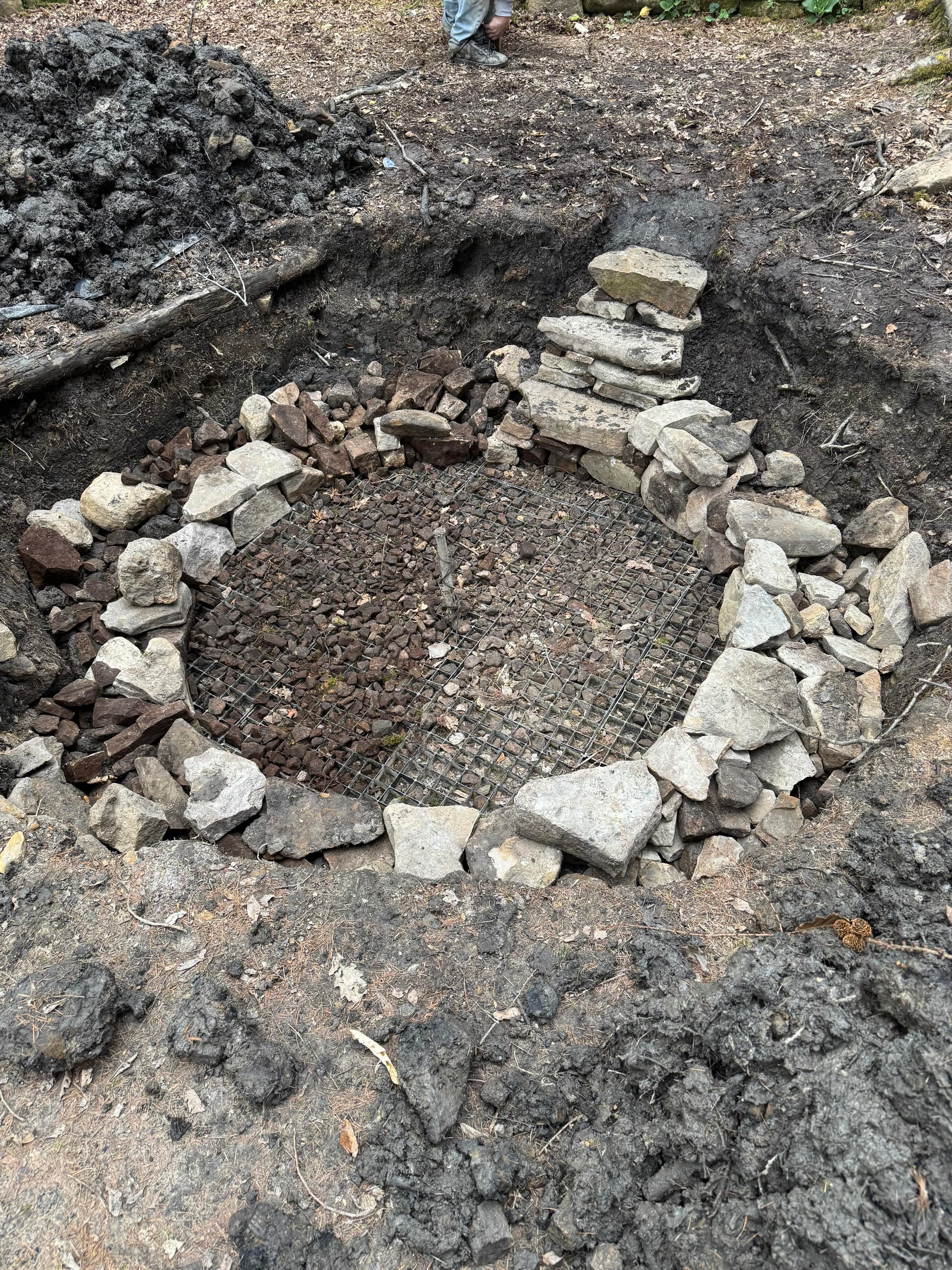

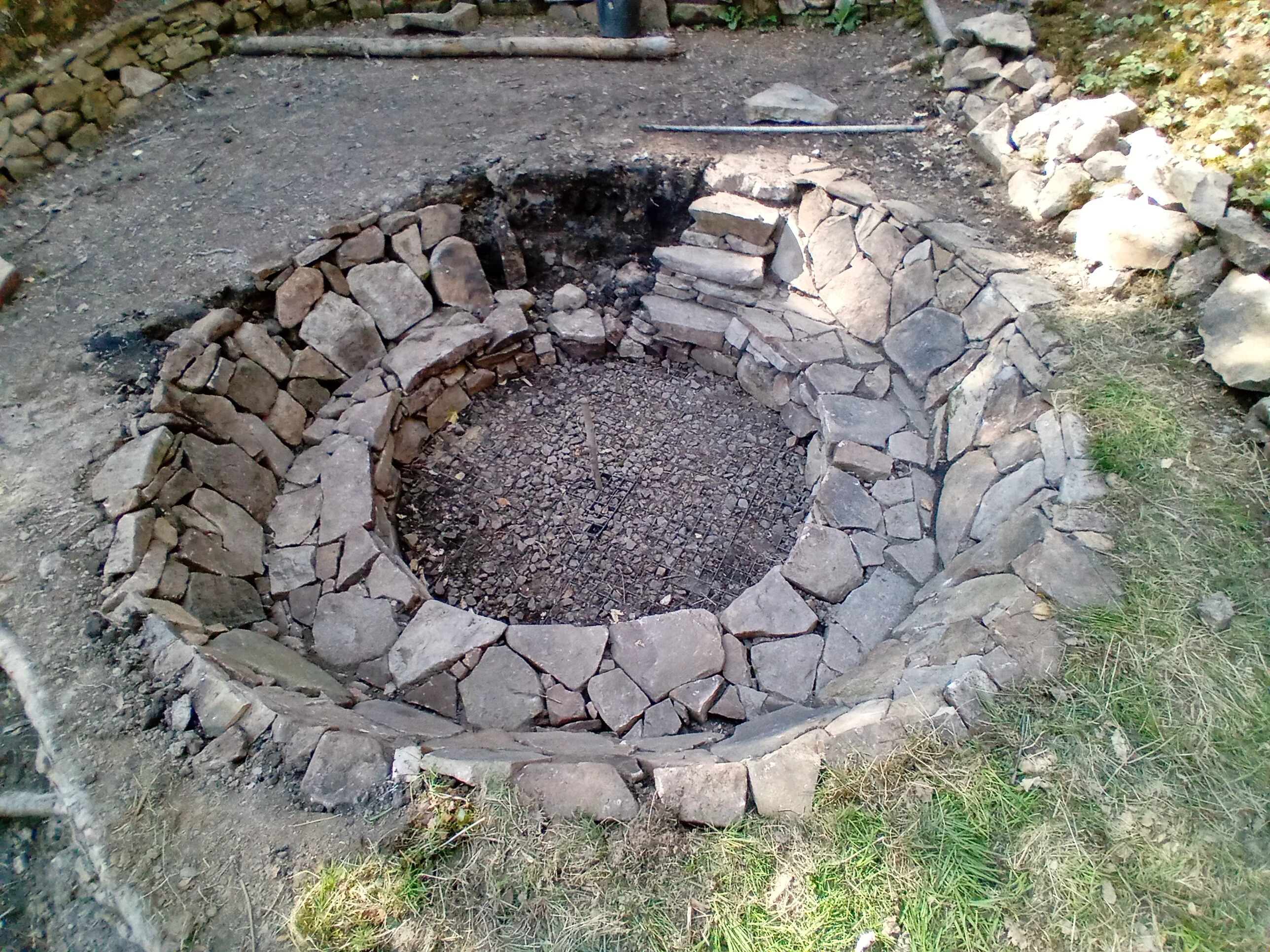

spent the rest of the afternoon playing teteras with the stones. untill i ran out,
Sunday, ill move all the dirt and continue with the stone work. i aim to get the round bench complete . see ya sunday :smiley:

Oh and heres the cabin…

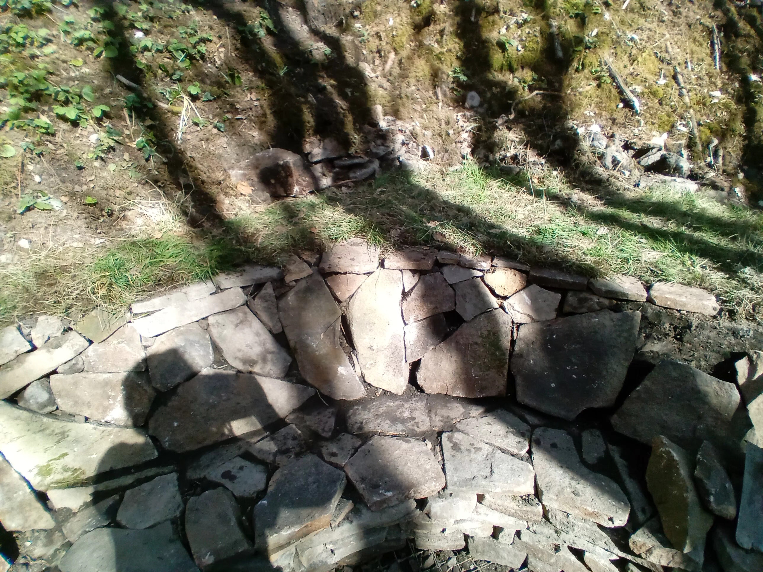

Sunday rolls apon us. And 2 tone of stone later…
Tomoz i plan to turf this level from localy harvested grass… and green it up a bit. Will also shave the lean of the seats and stay bricking that too…

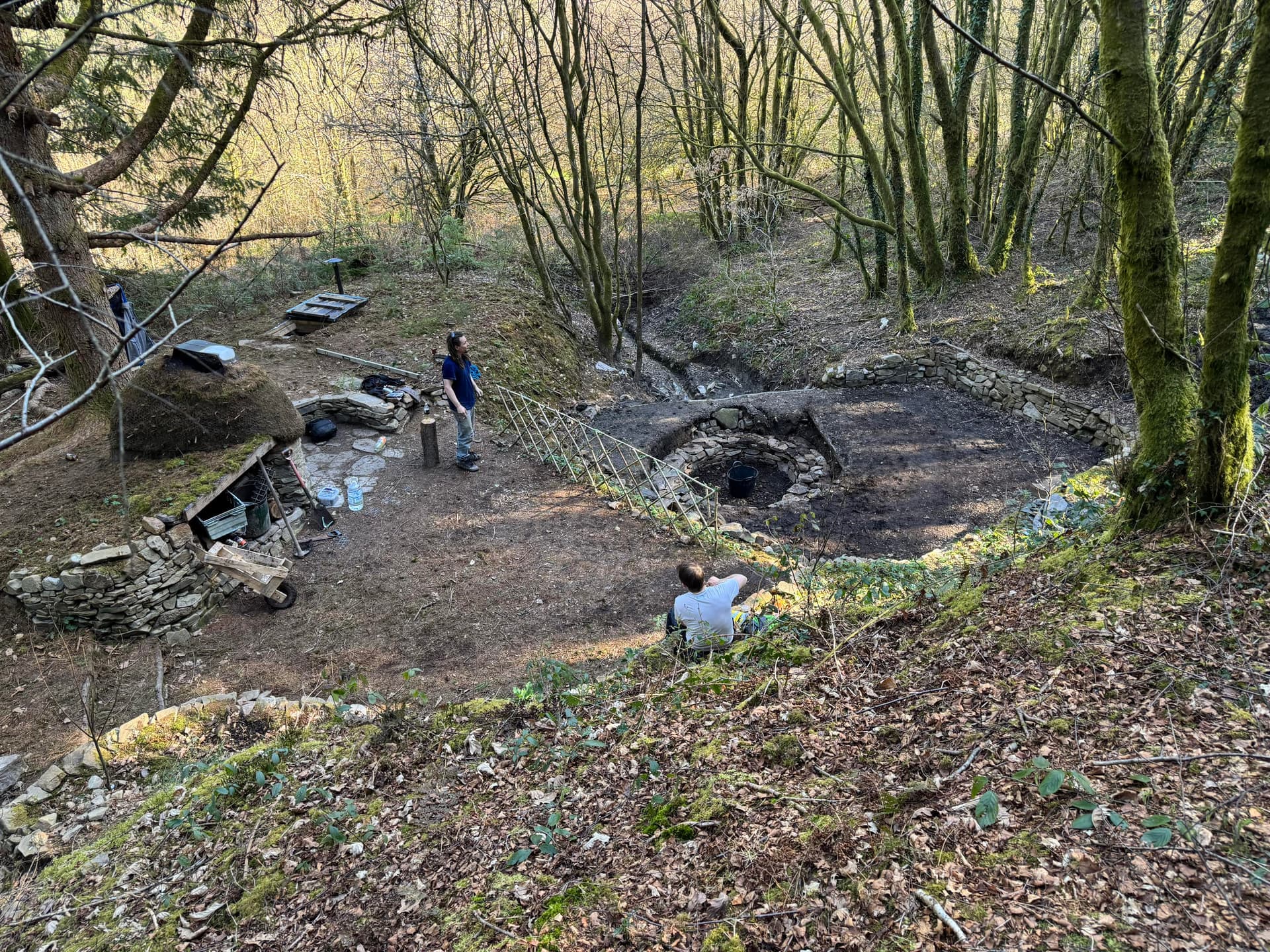

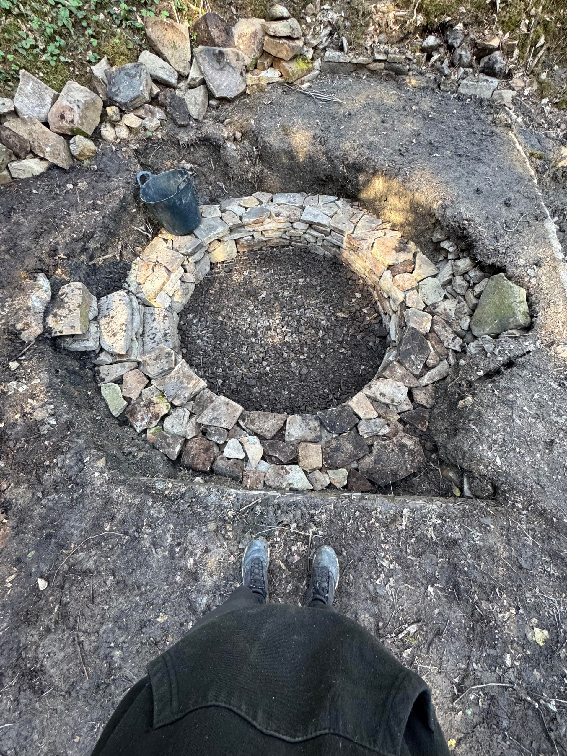

Solo mission today. Got a bit done. Its starting to tske shape…

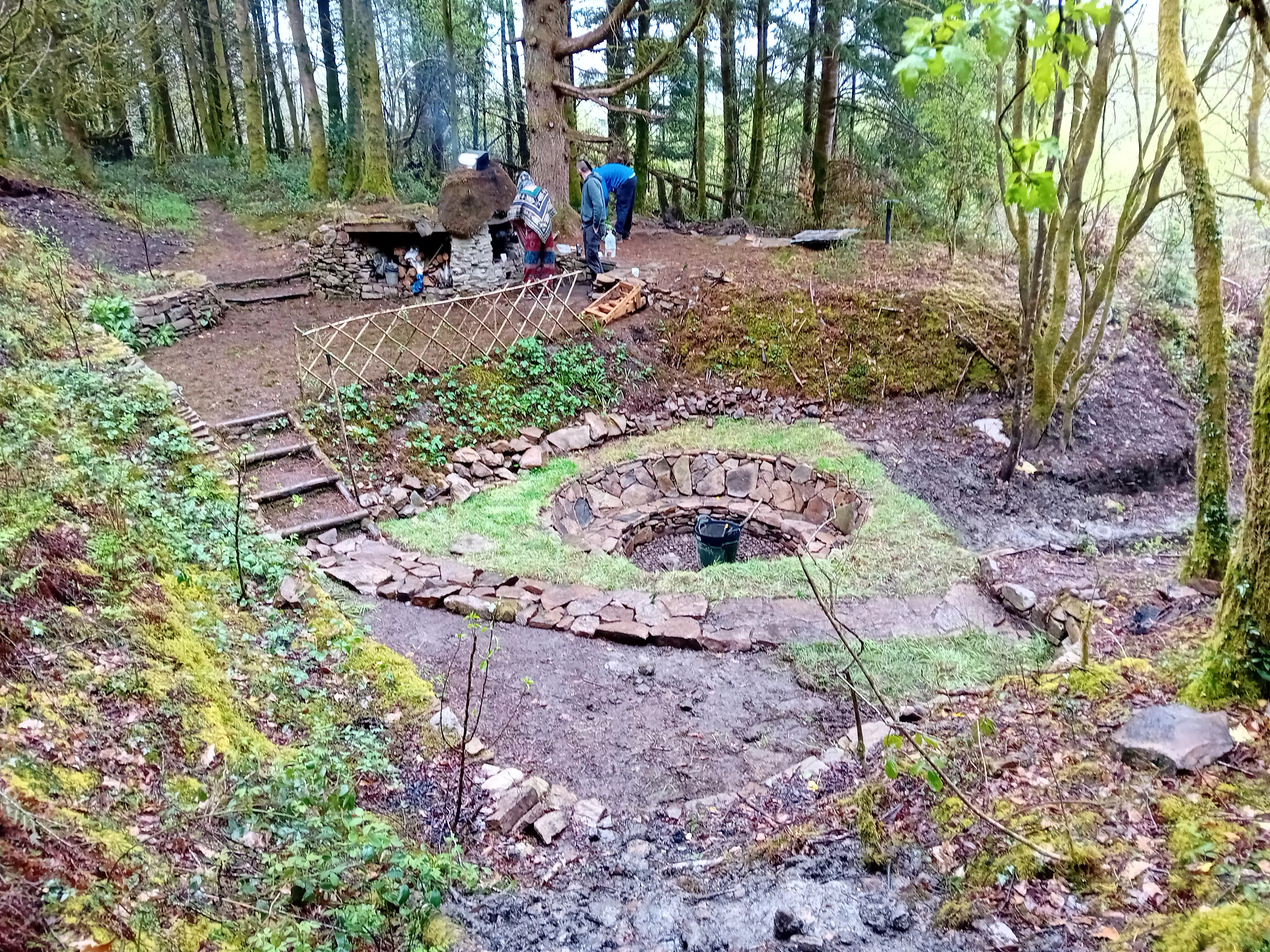

Ànother day of playing lego with heavy stones… 75% complete…

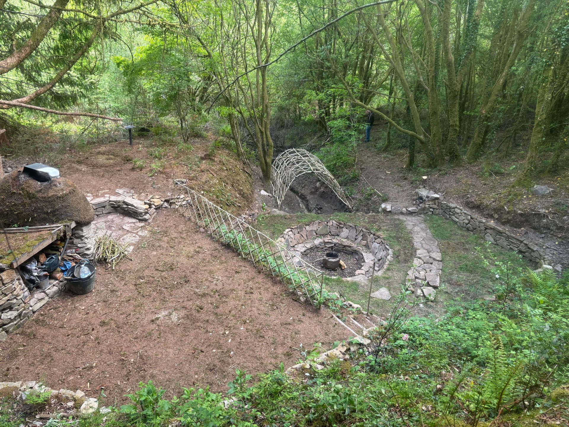

hello

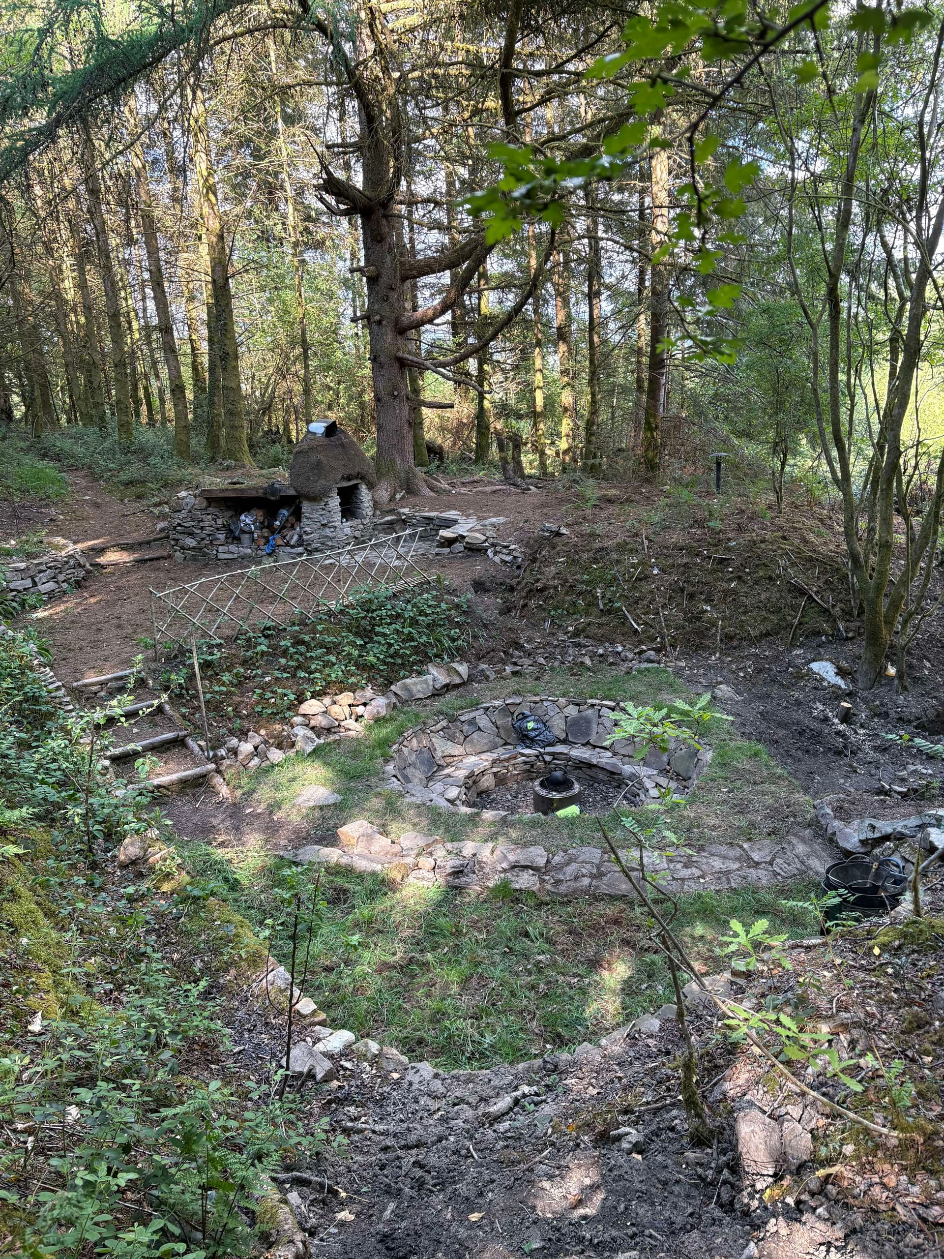

before
after

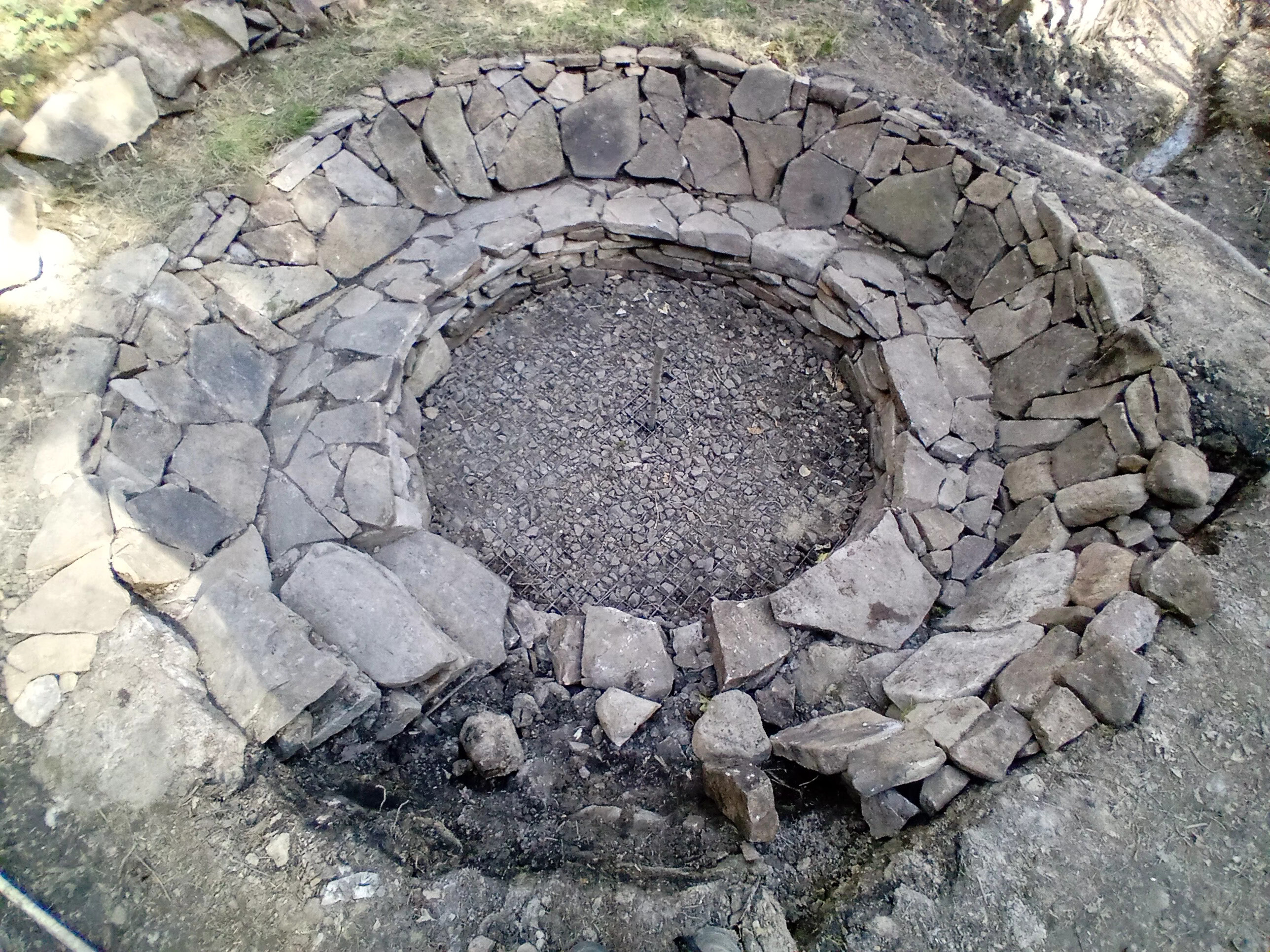

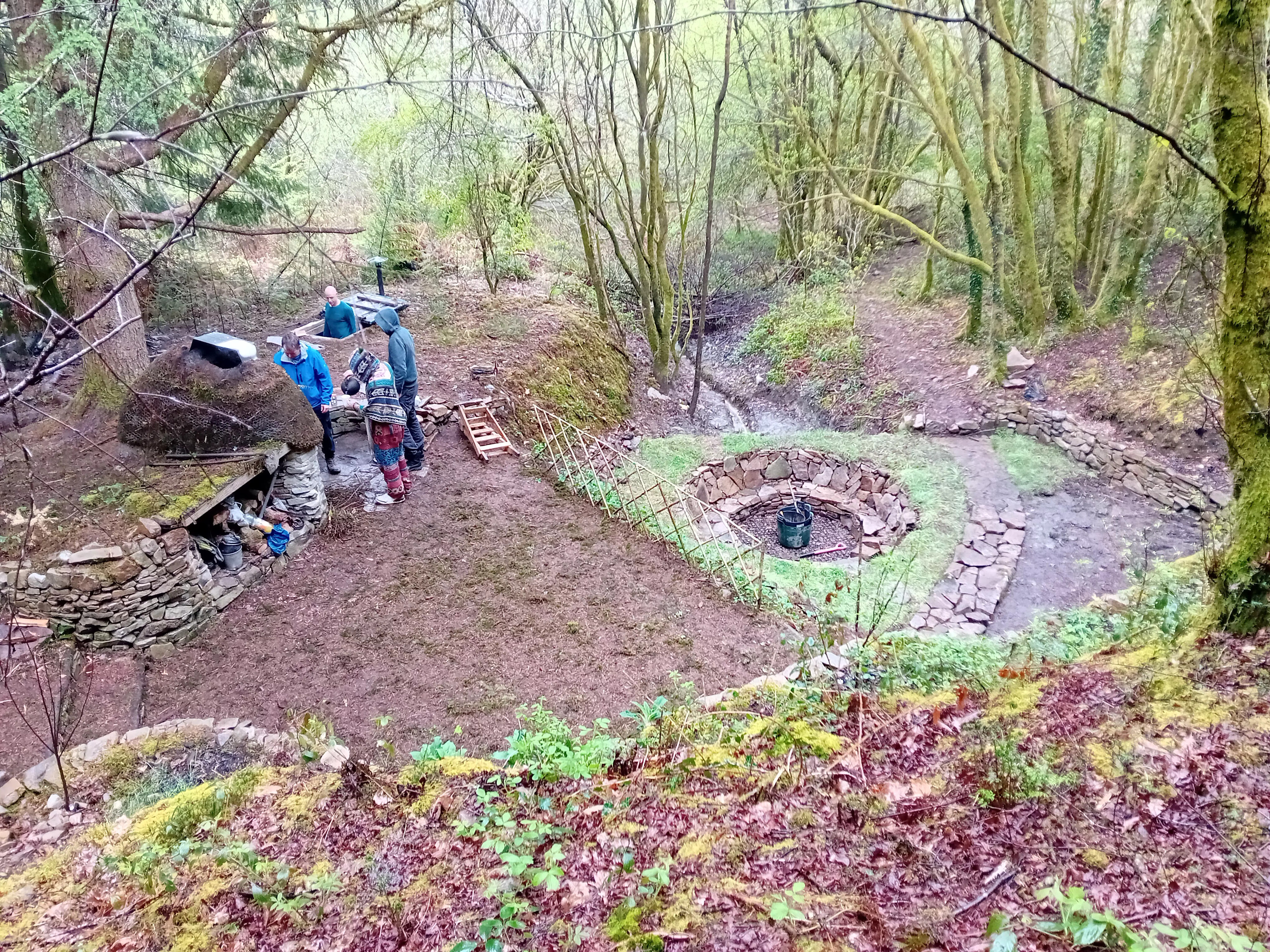

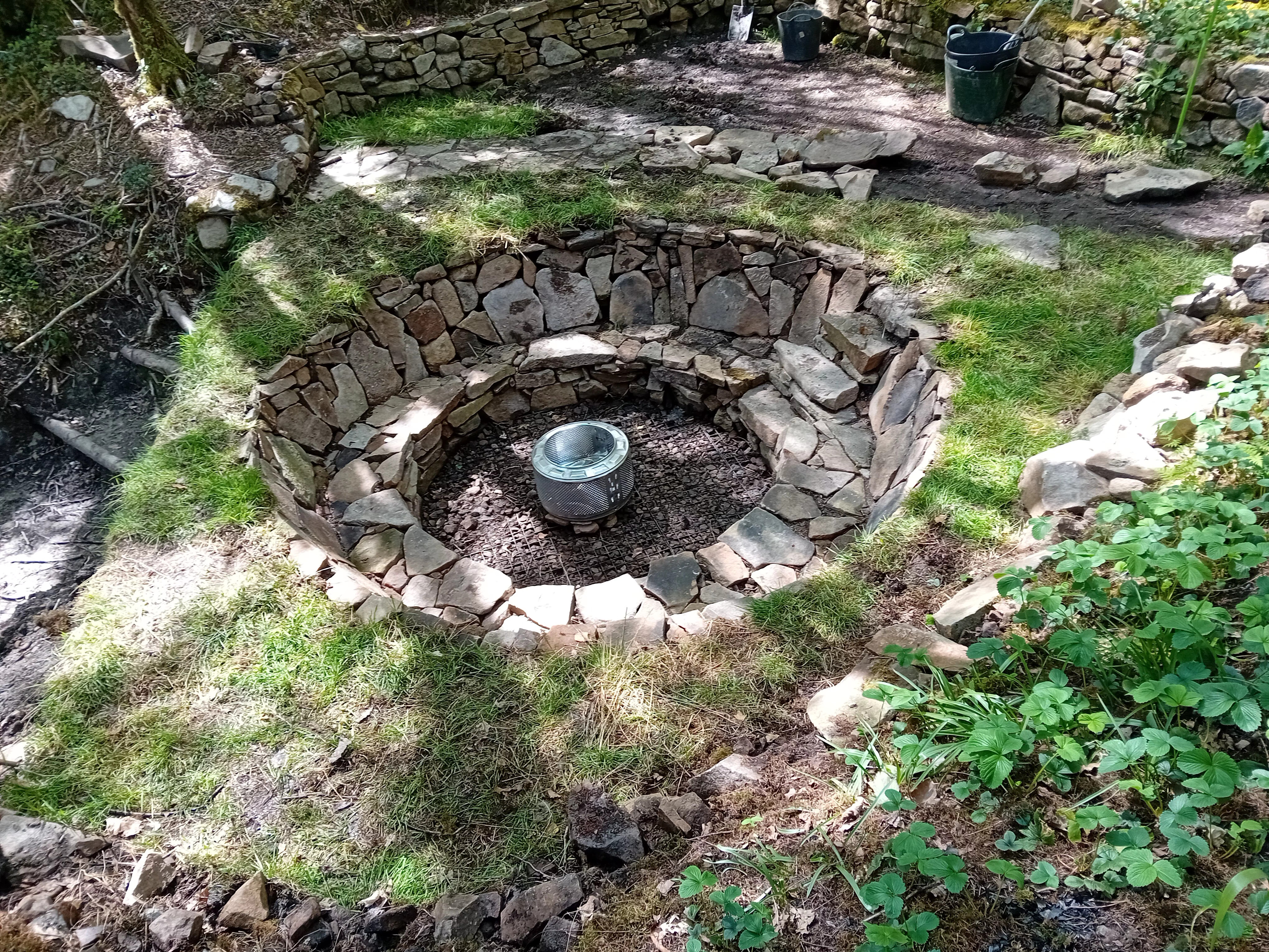

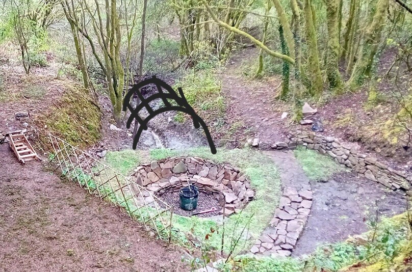

Pits finished. Burner installed. Still path and grass to finish…

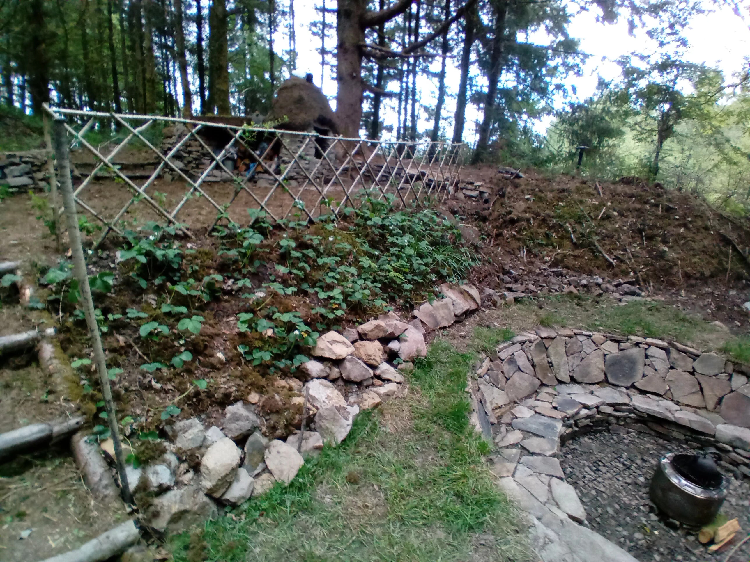

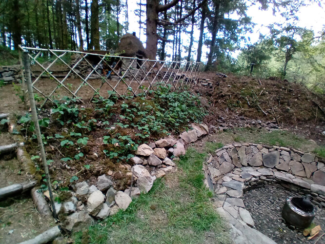

Grass complete. 1 more day to finish the stone pathway. Probibly thursday… but progress is good.
Looking at your before-after-pics it blows my mind that not only did you dig a fire pit (and an underground cabin), but also you’re the god of the spring and the grass grows when you command it to.

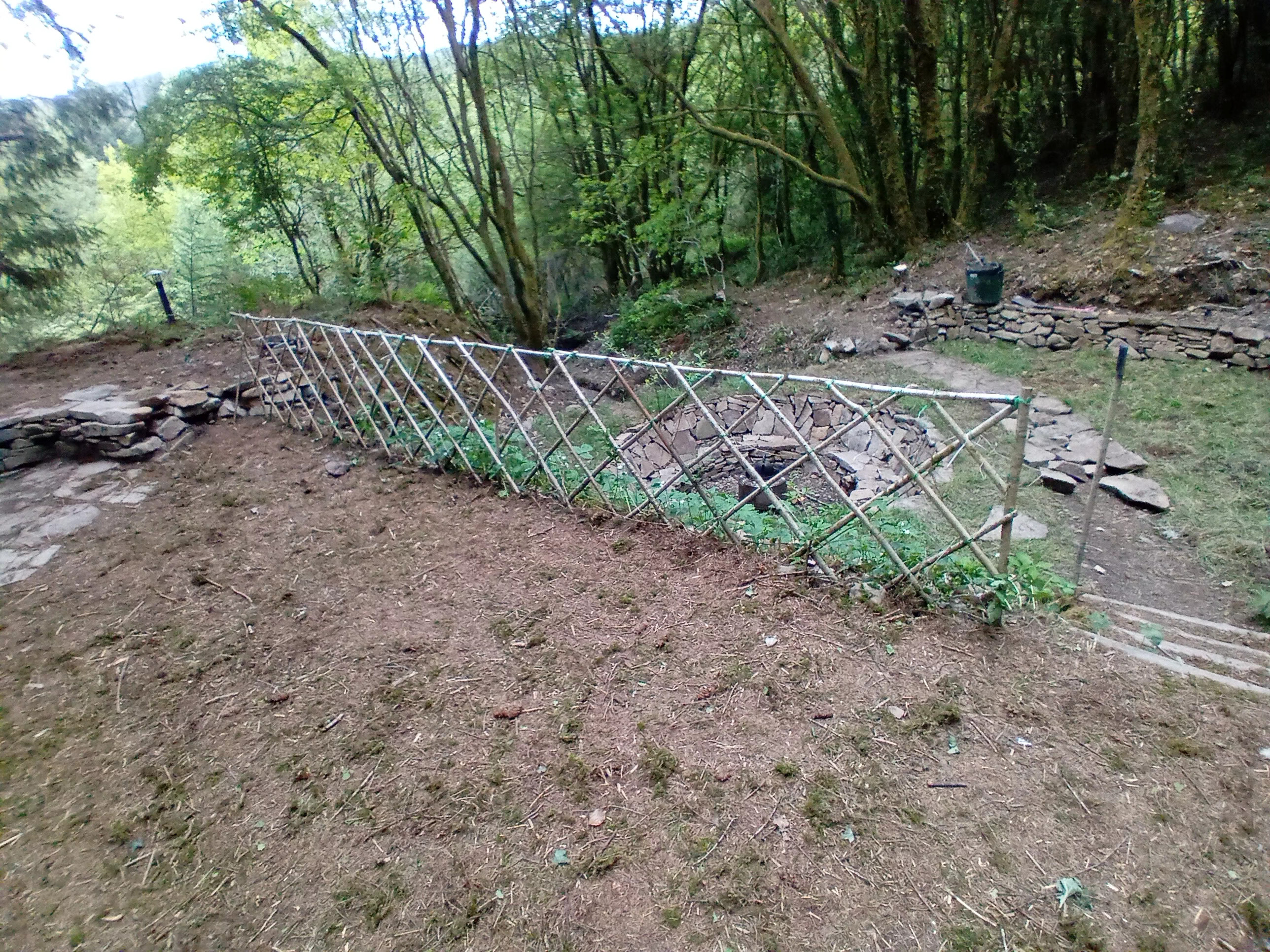

You flatter me . Went up for a hour yestiday after work. Finished the fence. May go up today to finish the stone walk way

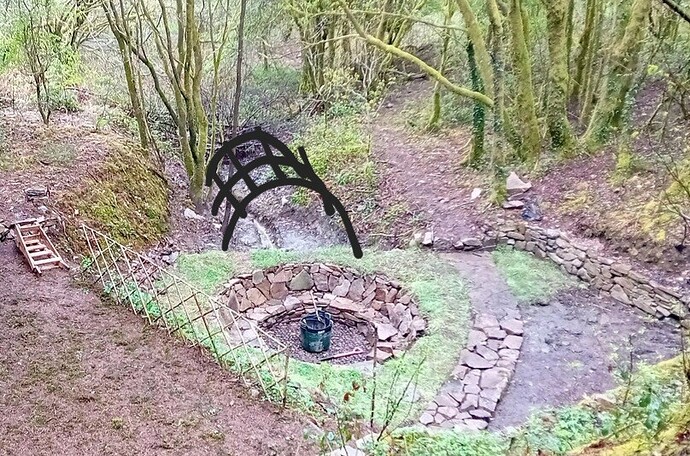

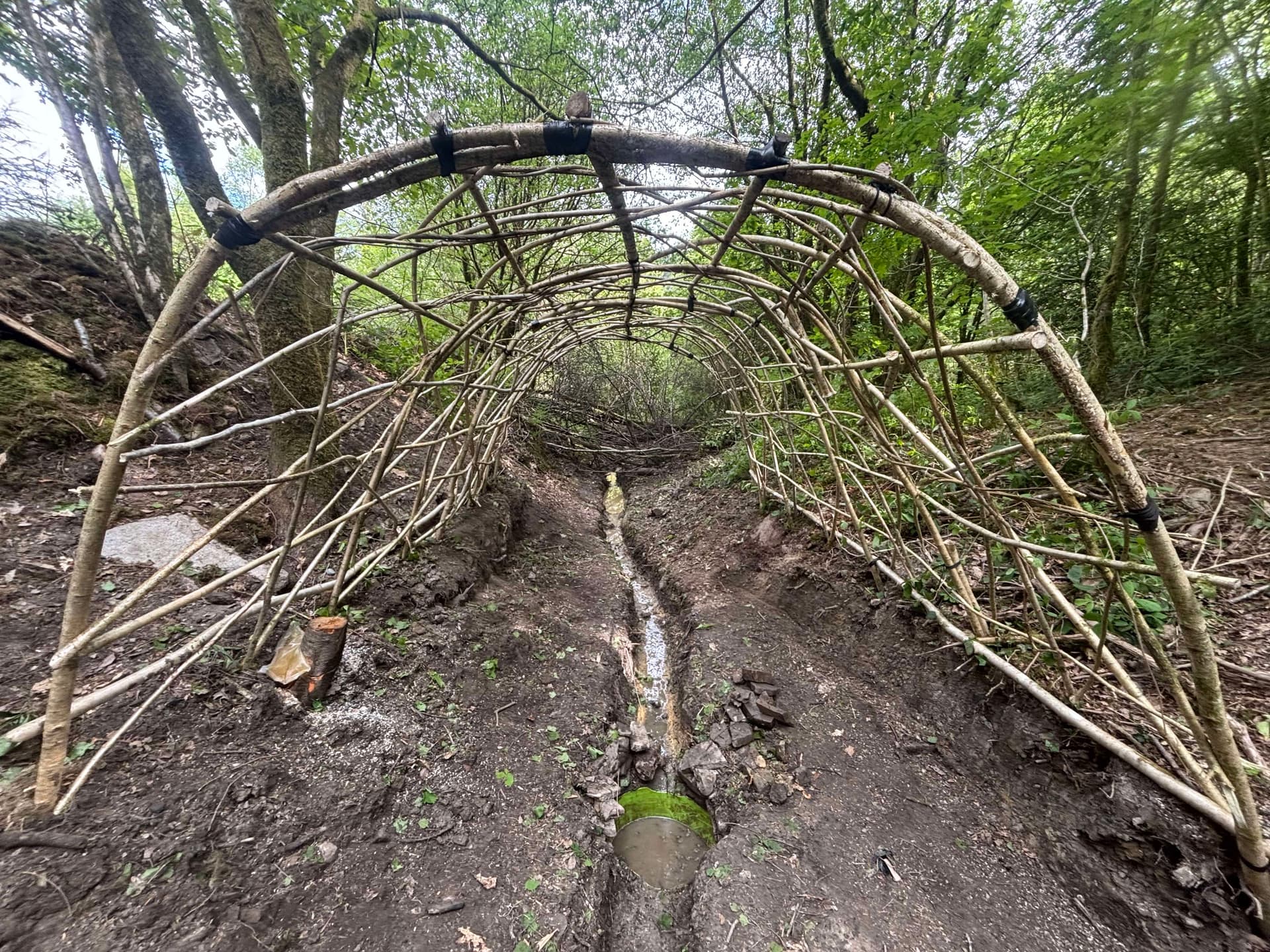

Next job is to make one of thos new fangled willow archway/tunnels. Which hides the well and should make a nice humid shaded area. For the deep summer.
That was quick…
