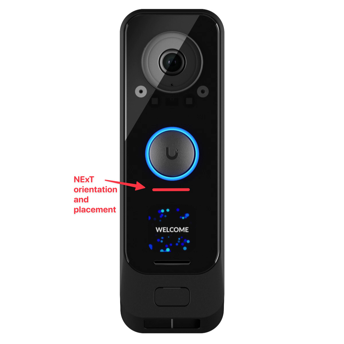

In case it helps anyone, here is the sweet spot for the placement of xSeries tags on the G4 Doorbell Pro
I can confirm the G4 Doorbell Pro also works with my FlexUG4 when configured as NTAG216 or MF Classic.
I believe @StarGazer1258 got his working with an xSIID.
Works with both my xM1 and xSIID. Haven’t tested my Spark 2 yet, but it seems it’s just reading the UID, so I bet it’ll work too.
