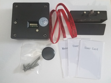

This is what the Sifely lock looks like. It is slightly different from the picture.
I’ve been too busy (lazy) with two kids and life to do a proper review, but there’s a few unique cabinet lock options now available. This one has a remote mount sensor, which allows for some interesting solutions if you can DIY.
It uses Mifare Classic 1k keys so it works perfect with my very fresh xM1 (installed today).
