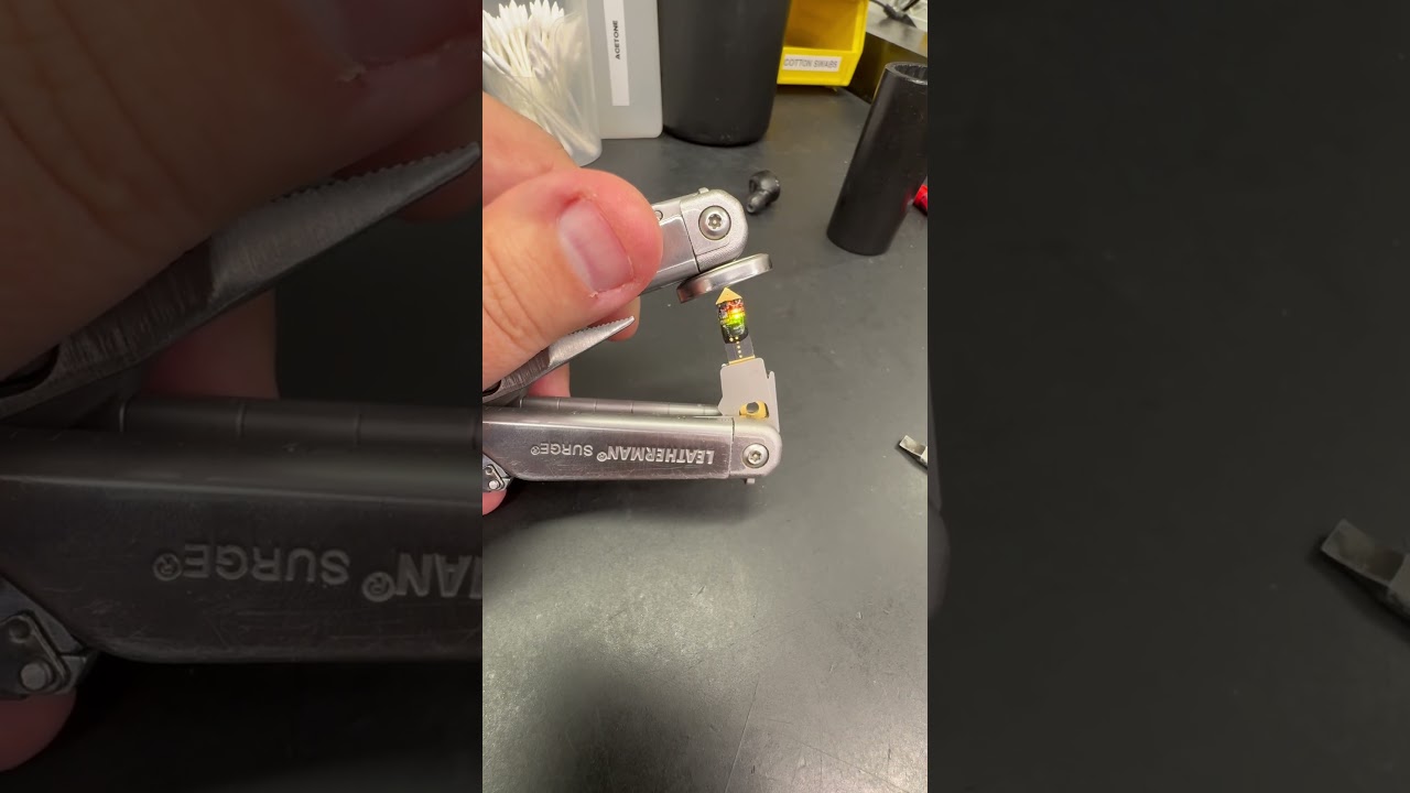

Is it a fresh battery?
Presumably a fresh battery… pulled the tab on it… but could be old stock I guess
I just remembered I have my Leatherman voltage bit… I’ll check voltage fwiw
FWIW
I think I changed my chinese factory one for a quality label one
3v even
brand new/ quality Voltage should start are 3.1-3.2, it will have lost capacity too.
Swap that bitch out, and try again
