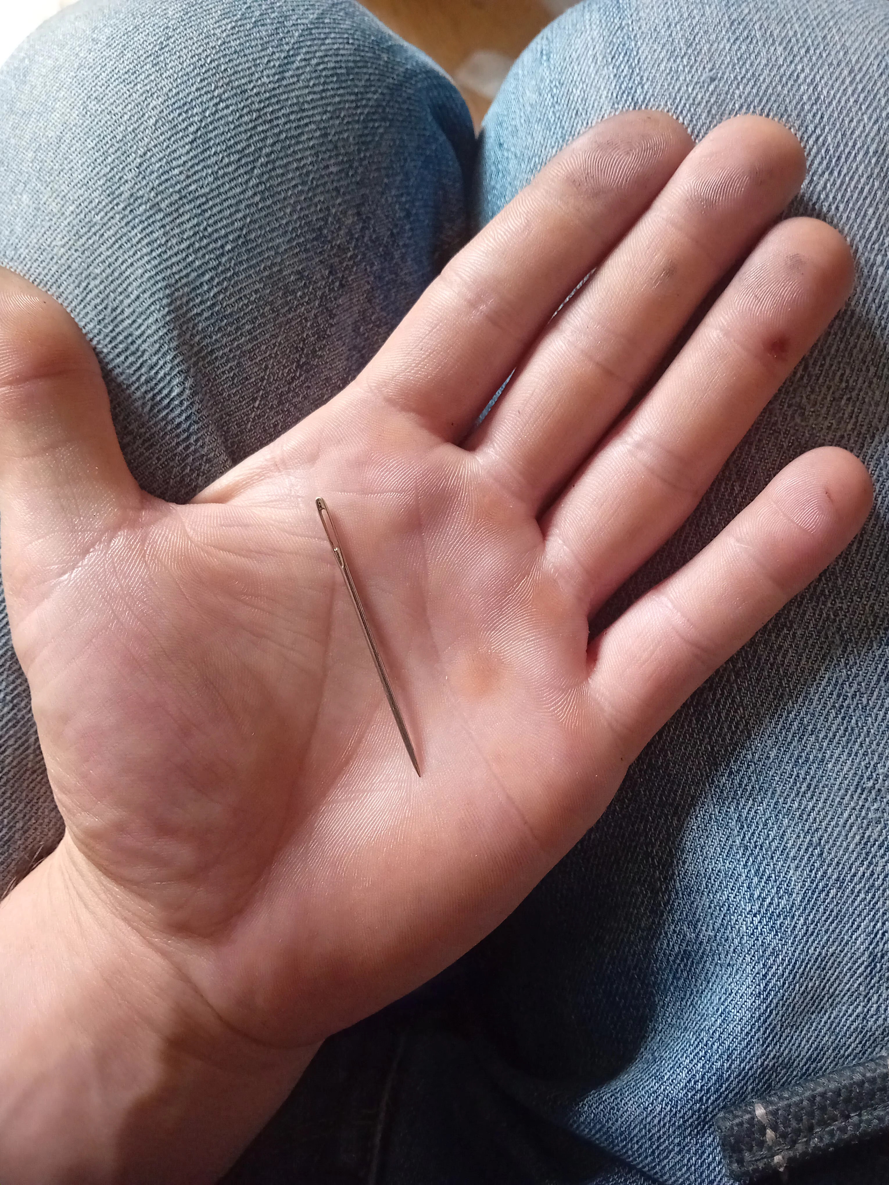

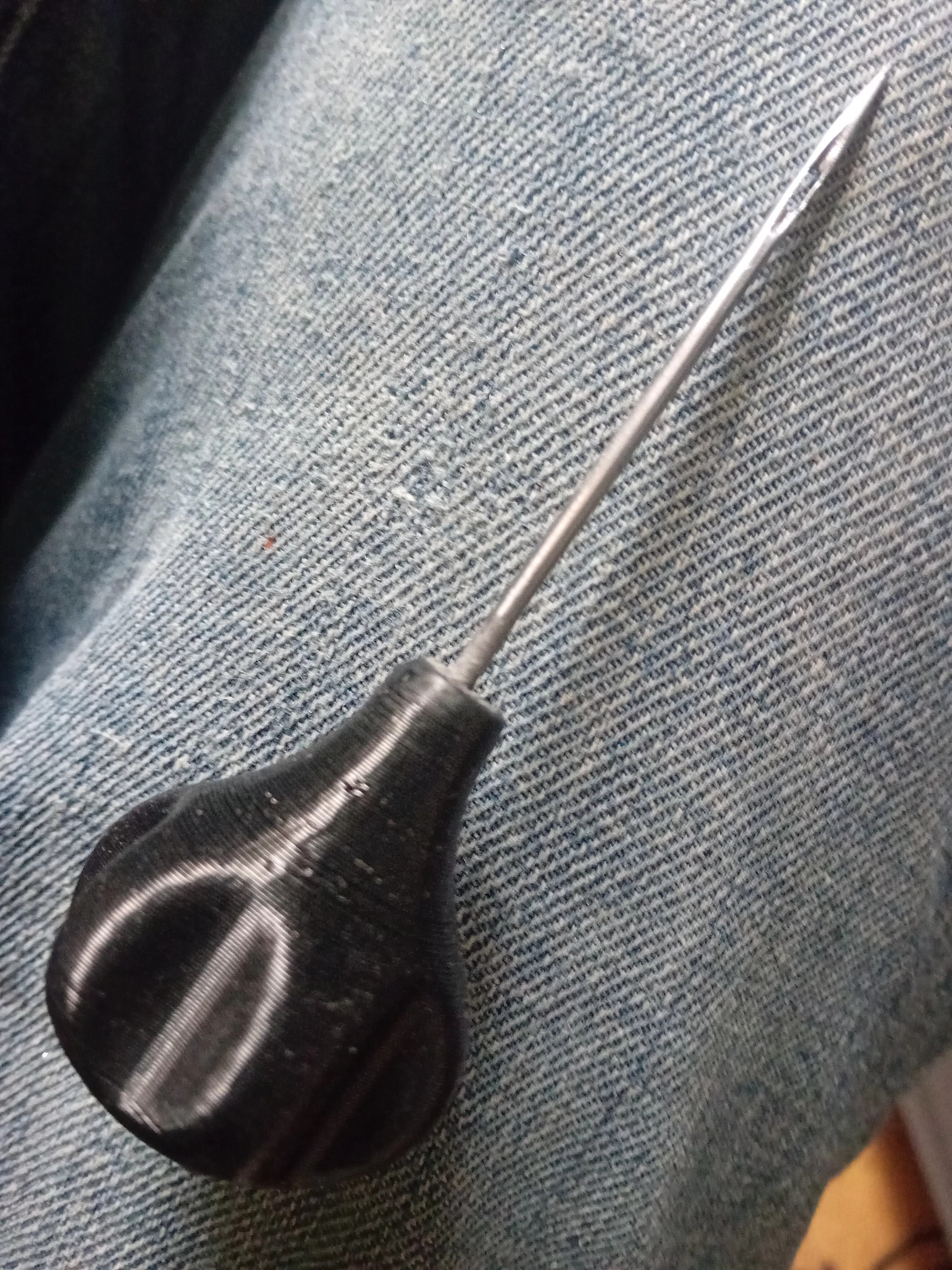

So I plan to make it in the next hour. I’ll attempt to dremel a needle eye into a piece of stiff 2mm wire bent and snapped of a bit of arris fencing. I’ll then attempt to sharpen and Polish it. While I cad and print an ergonomic handle… it should just fit in the hole be bent over and glued in place.
If you have any tips or advice. Make it quick. You know what im like :wink: meep meep neeeooowm
needles done. Waiting on the handle to print.
Completed - 300 exp , 26ap. Level up

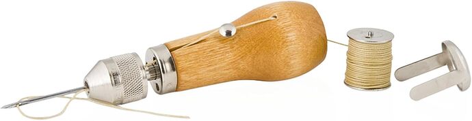

Reminds me of the Speedy Stitch sewing awl for heavy cloth/tarps etc.
Yeh i have looked at awls. But they were either too thick. Or the eye was too small.
after making the needle eye longer. primary user approves

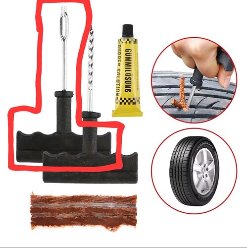

tyre repair punch
Cost a couple of £
I used one on a bike in Vietnam, If it can punch through Rubber tires, your dreads will pose no issue.

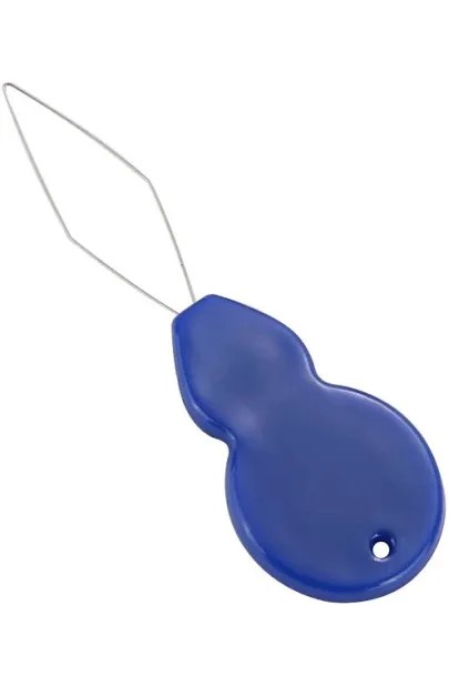

you could bigify one of these needle threaders,
Made of thin spring steel with a wide opening to make inserting loose hairs into it easier, then you push that through the eye of the needle, hold the hair, withdraw the threader…
