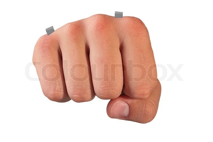

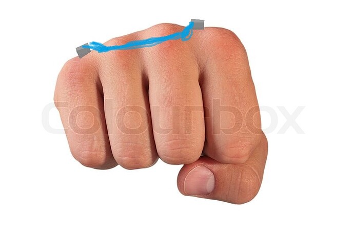

Edit: Uhhh… no. That’s not what I’m proposing. I’m proposing something that’s insulated from the skin and positioned far enough away so as to work like a regular stun gun, only difference is that it’s attached to the hand instead of simply being held by it. I can create my own diagram if need be and post it tomorrow
As for preventing it from moving around… I wonder just how far you can go with the silicone, like could you wrap it around the finger bone? Like a ring under the skin? Hmmm
Ok gimme a minute and let me get on a computer to make a picture about this
this is what you are proposing

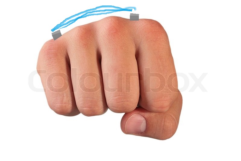

you think that this will happen
remember, you are made of stuff MUCH MUCH more conductive than the air, and electricy will follow the path of least resistance which is this
