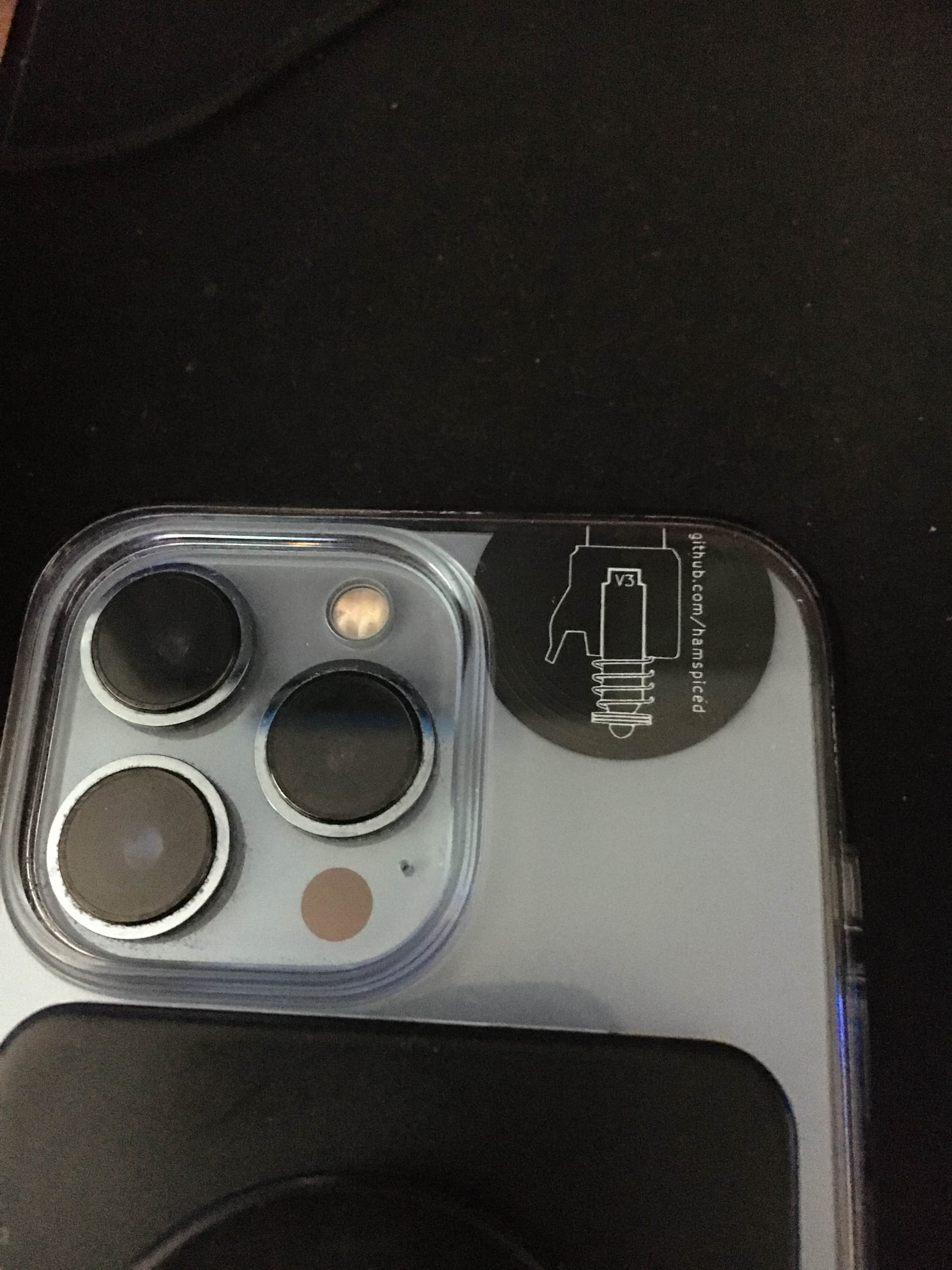

You can remedy this through the use of the RSP by placing once of the stickers on the outside of your case, you should be able to start getting reads through the case with your iphone.
[photo from here Wiki - Repeater Placement Guide]

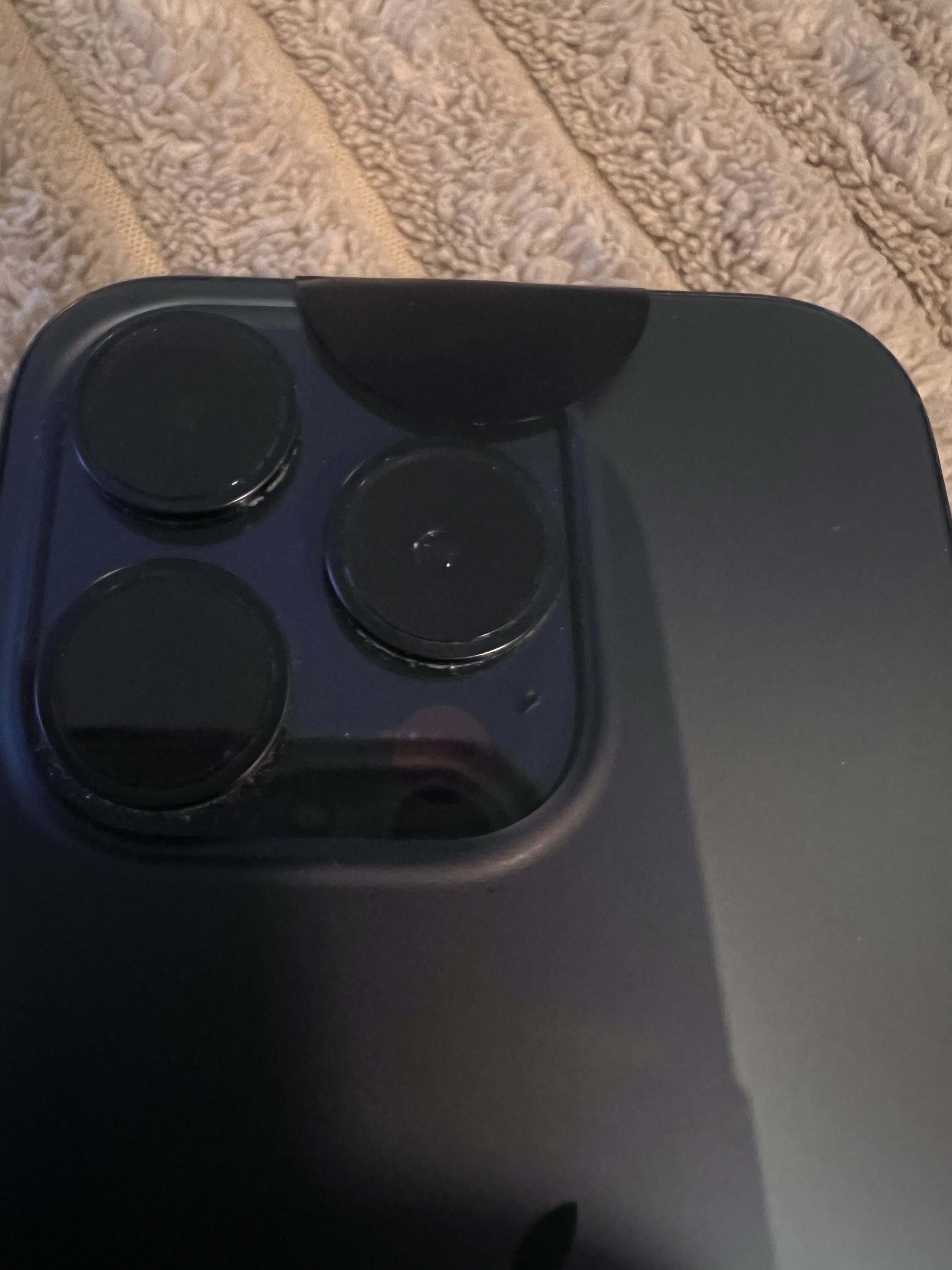

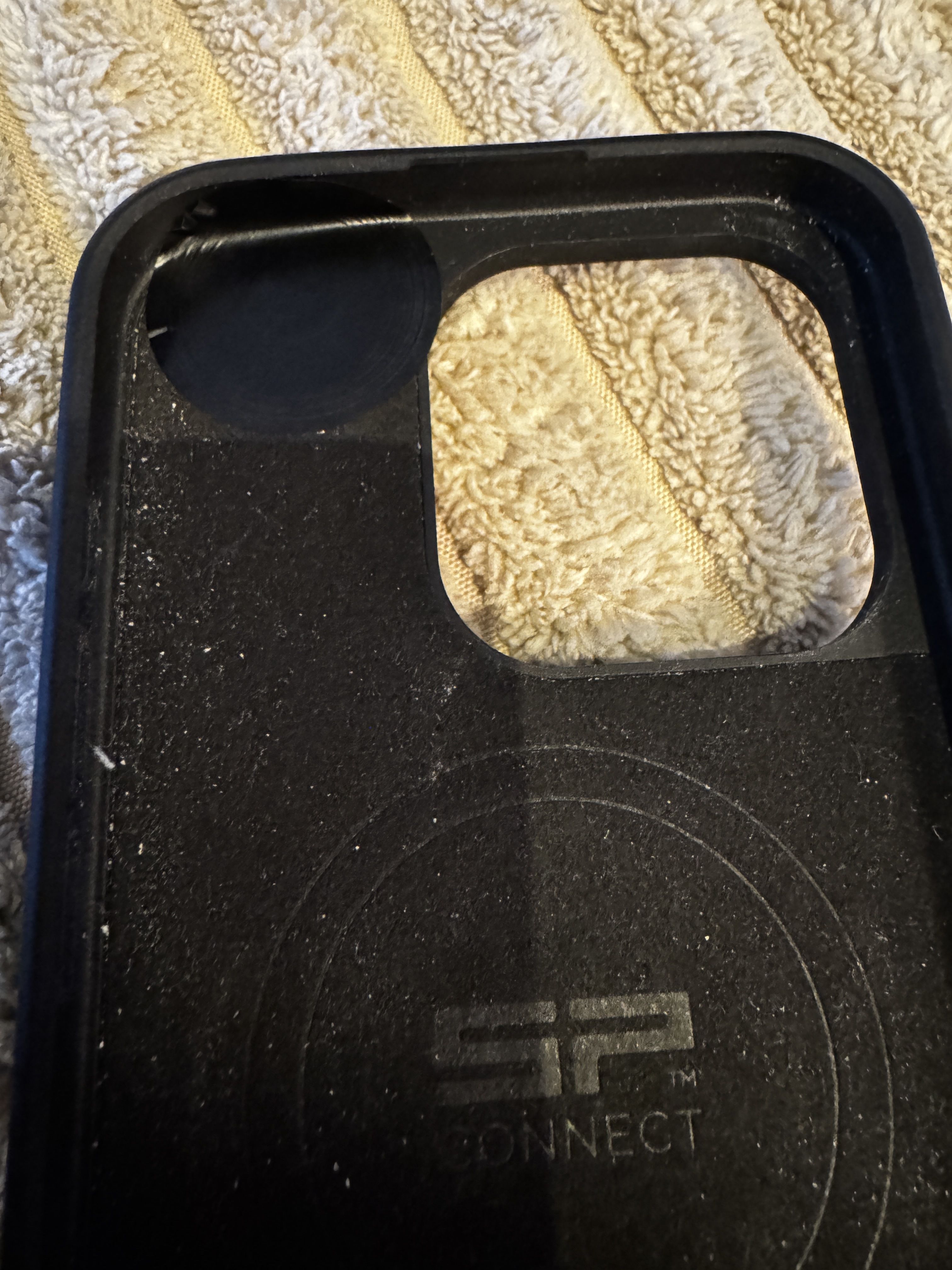

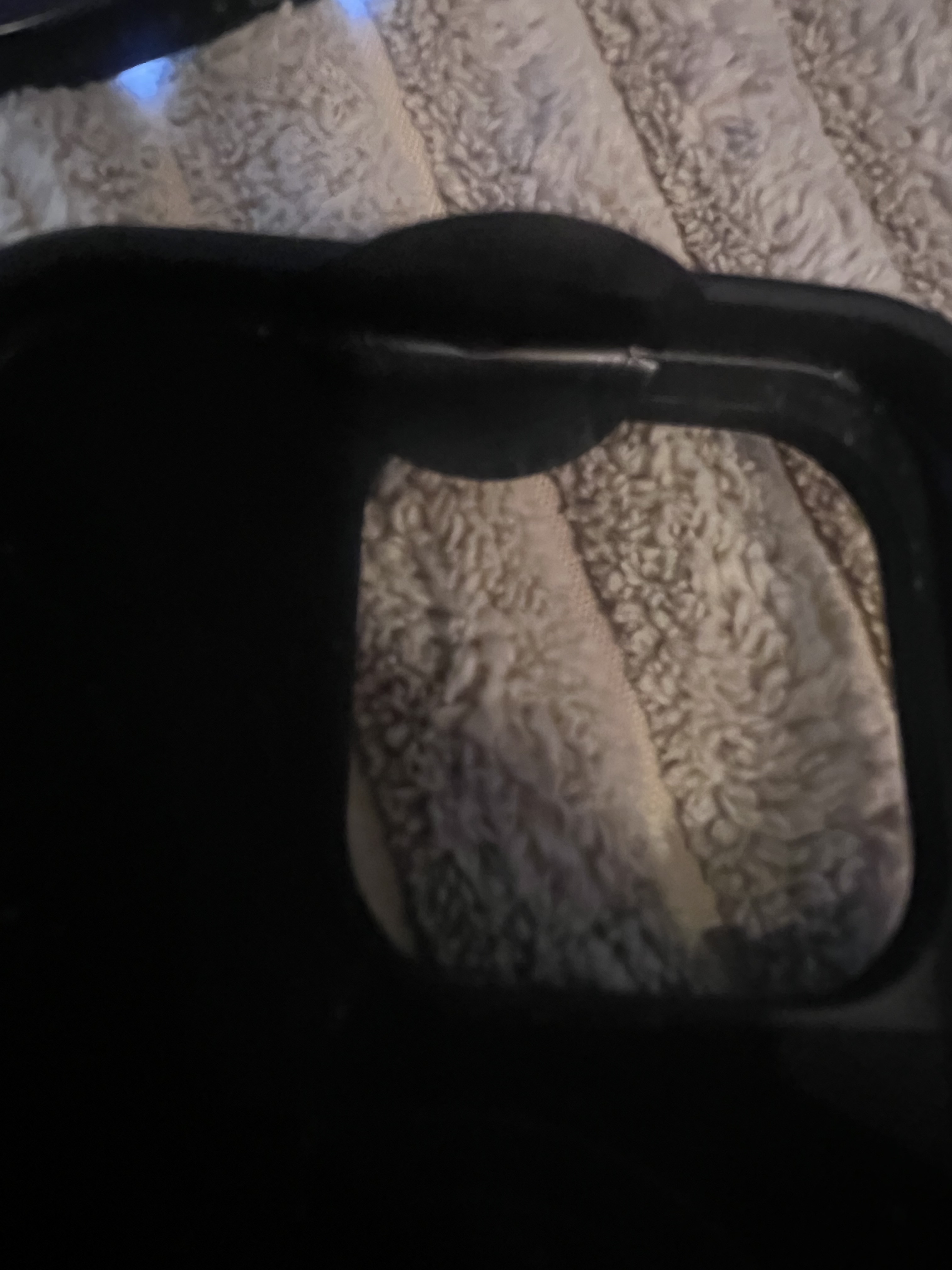

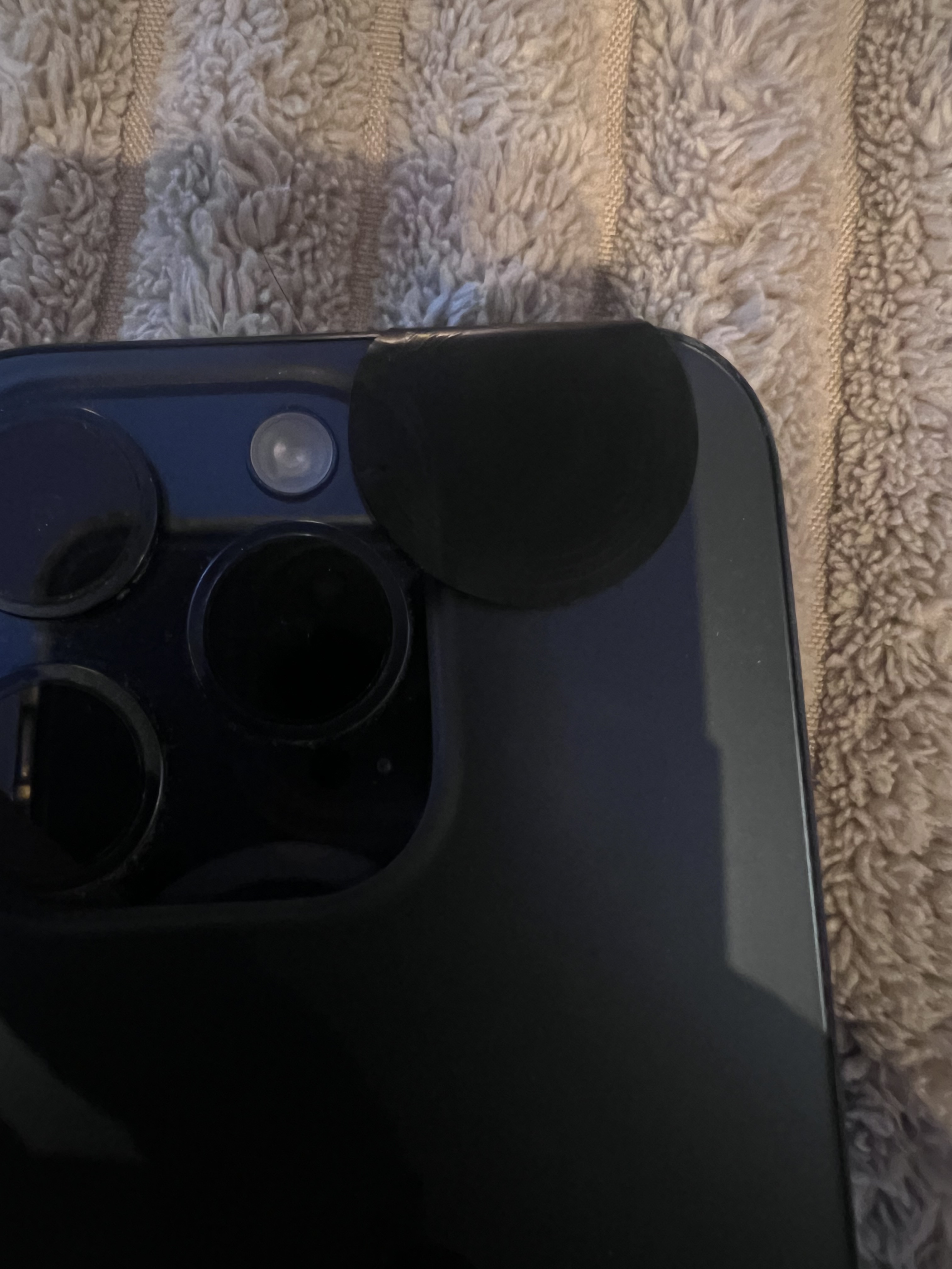

I bought me a fresh set of those stickers.
They don’t improve the readings. Even worse: the phone cant read the implant at all. Not with a case and not without a case. Tried them in different positions on the phone and inside the case.
Hey @Retc Positioning of the stickers matters 100%. Did you get a Field Detector with them? They really help knowing where the appropriate spot to place the sticker is, as well as knowing when the phone is actively scanning for the implant.
This one here should give you the best range if placed on the outside of the case in this particular orientation. I know it seems silly but the positioning matters when it is down to millimeters.
