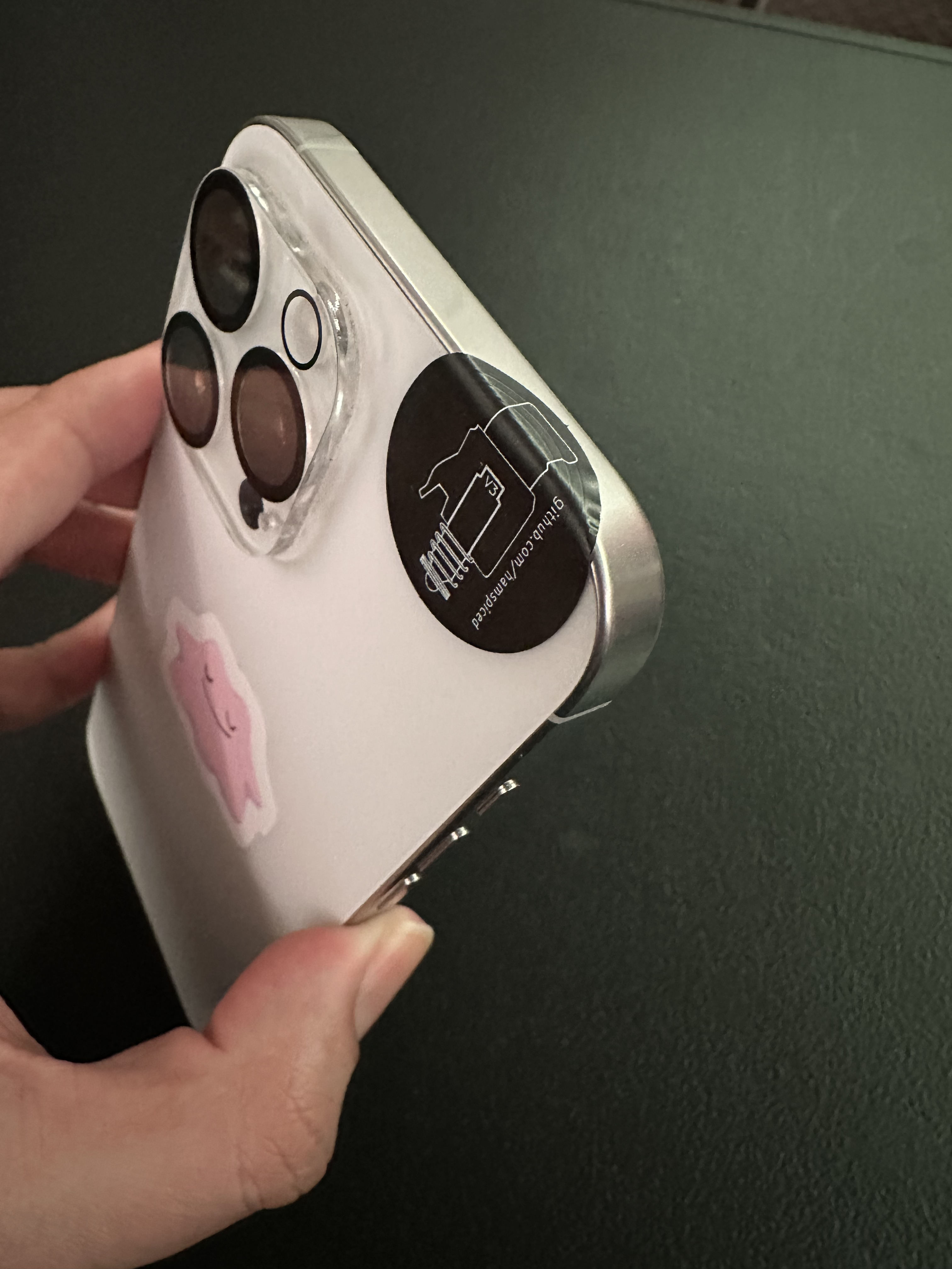

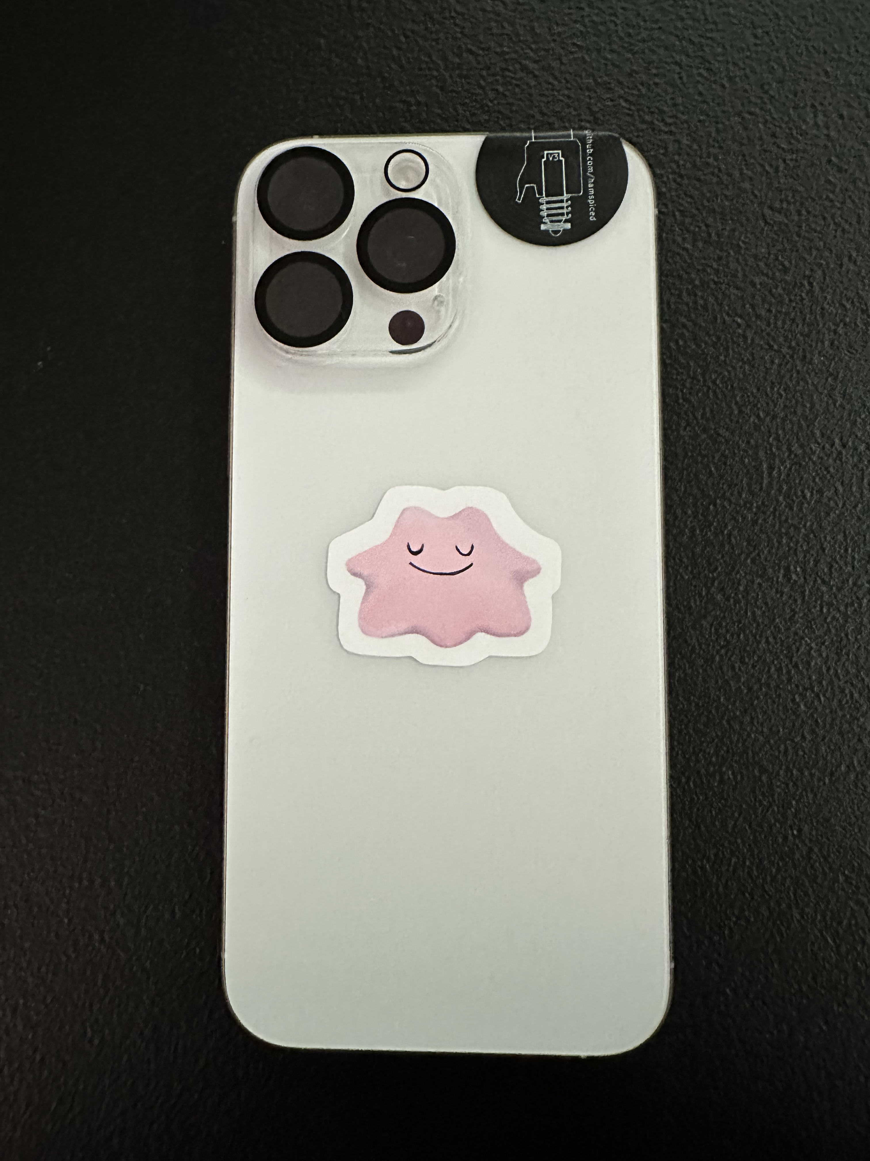

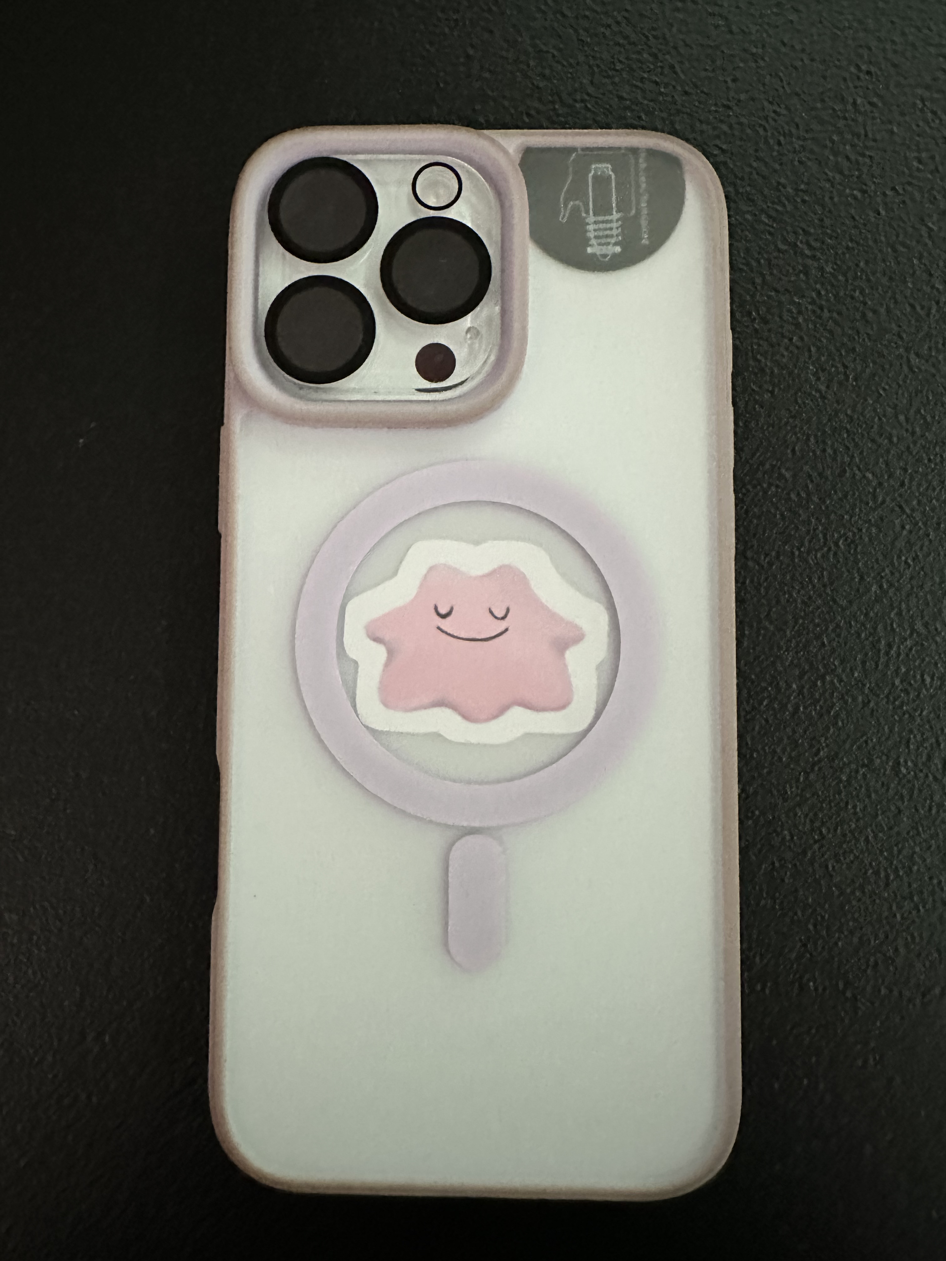

fwiw, I have my apex flex in my right forearm. About 2 inches or so up from my wrist. I wasn’t able to get a read on my iPhone 14 Pro or my iPhone 16 Pro at all until I put a resonator sticker on, even without a case on. Now I can reliably read my apex (with a case on) in yubico auth for TOTP and elsewhere for passkeys. It’s not 100%, but probably 98%? And when it fails it usually is related to me moving the phone out of range before reading is actually complete.
Before I got it installed, I taped a java smart card to my arm in different spots and scanned it with my phone to see what felt most natural for regular use. That’s how I landed on where I did for placement.
How long did that transition from not being able to read it to reliable reads take?
Once I got the sticker on my phone, it was just a few days to get used to the positioning. Certainly doesn’t help that I sometimes use it on a pixel as well so my muscle memory messes with me sometimes. I didn’t get a sticker on my iPhone until a few weeks after I got the apex installed, I was relying on my pixel to interact with my apex during that time.
Something I forgot to add in my last post: the sticker improved the performance on my iPhone so much that I can even read my apex through most of my sweaters. Comes in real handy when I don’t want to roll up my sleeve.
Nice! Can you post a picture of exactly where your sticker is on your iPhone?
For sure!
