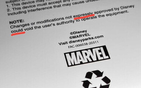

they added a sticker saying no implants
Absolutely destroyed. 10/10, the mouse knows all.
Problem with changing now is they’d have to replace the readers at every fastpass ride, every park turnstile, and every hotel room door. They’ve already said they’re not recouping the cost of the initial install as much as they’d hoped.
Also @amal, my wife cleaned up my “clutter” so I’m still looking for that card. When I find it I’ll pm you for an address.
Sounds like at least little bit of “legal” wiggle room.
