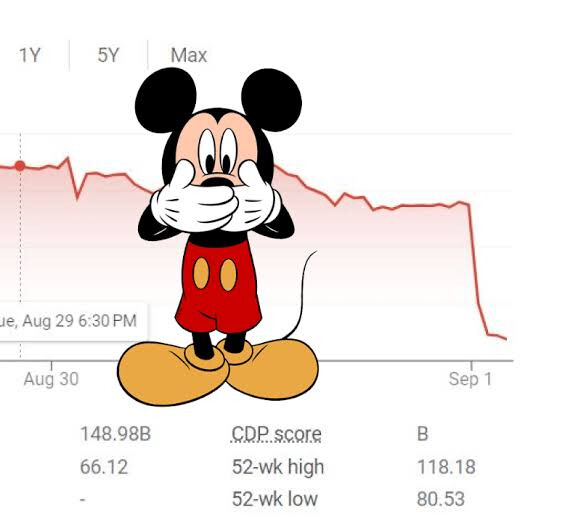

They ruin everything
:rofl: I hope their shares keep plummeting and the execs making stupid decisions are fired.
WAKE UP DISNEY YOU PACK OF CUNTS!!!
This is one of the most hilarious things…I’ve ever seen. Huge Disney L
@amal @Pilgrimsmaster @Hamspiced @enginerd we have neutralized the mouse.
