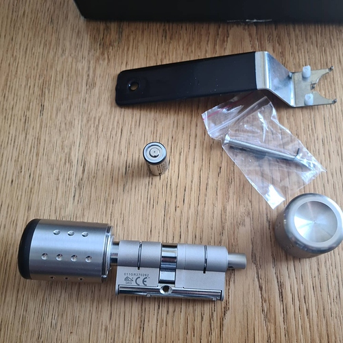

The Wilka lock confuses me. Is it a replacement for a deadbolt or for a knob?
I have the Wilka lock. You need to buy it from DIGIWELL to get the perfect version. It lights green (only RFID Vetsion)
Blue: RFID & Bluetooth i got furst tve wrong vetsion - the bluetooth works only with the flexmplants.
The lock will work with the NExT
It just replaces the internal cylinder in the door. Only one part of the locking mechanism.
The door and handle are not replaced. When you order from Digiwell like myself and @JennyMcLane did, you need the internal and external measurements for your door to make sure the length is correct and fits your door.

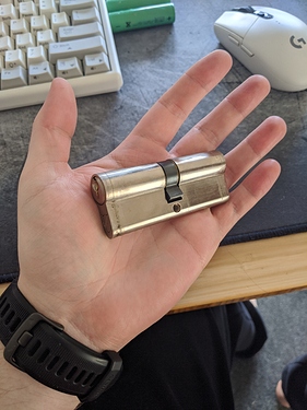

Just make sure your house doesn’t look too conspicuous or obviously full of stuff with a high resale value, because those cylinders are about as burglar-proof as a door chain.
Depends on what kind of door and frame you have. If you have one of these locks and use it with a door what has a single locking point it doesn’t really mean much. You can just break in with brute force.
Having said that, I don’t think I know anyone who has ever had their house or apartment broken into where I live.
It’s not a door problem, it’s a cylinder problem. The issue is that, by design, the entire locking mechanism is on the outside. One good whack with a sledgehammer, and all you need it a pair of pliers or a large flat screwdriver to turn the tailpiece of the cam.
Those integrated NFC cylinders are very convenient, but they also provide a really easy-to-exploit point of weakness for a burglar to attack. And because of their obvious shape, putting one of those things on your door is like putting a sign on your house that says “this house is an easy target” for anyone walking by with less than good intentions.
So yeah, okay for an apartment or a house in a very peaceful neighborhood, possibly. But anywhere else, not so much…
Why the lock isn‘t save for a house? You need a fob etc to get in. If you damage the handle there is the cylinder itself in the door.
