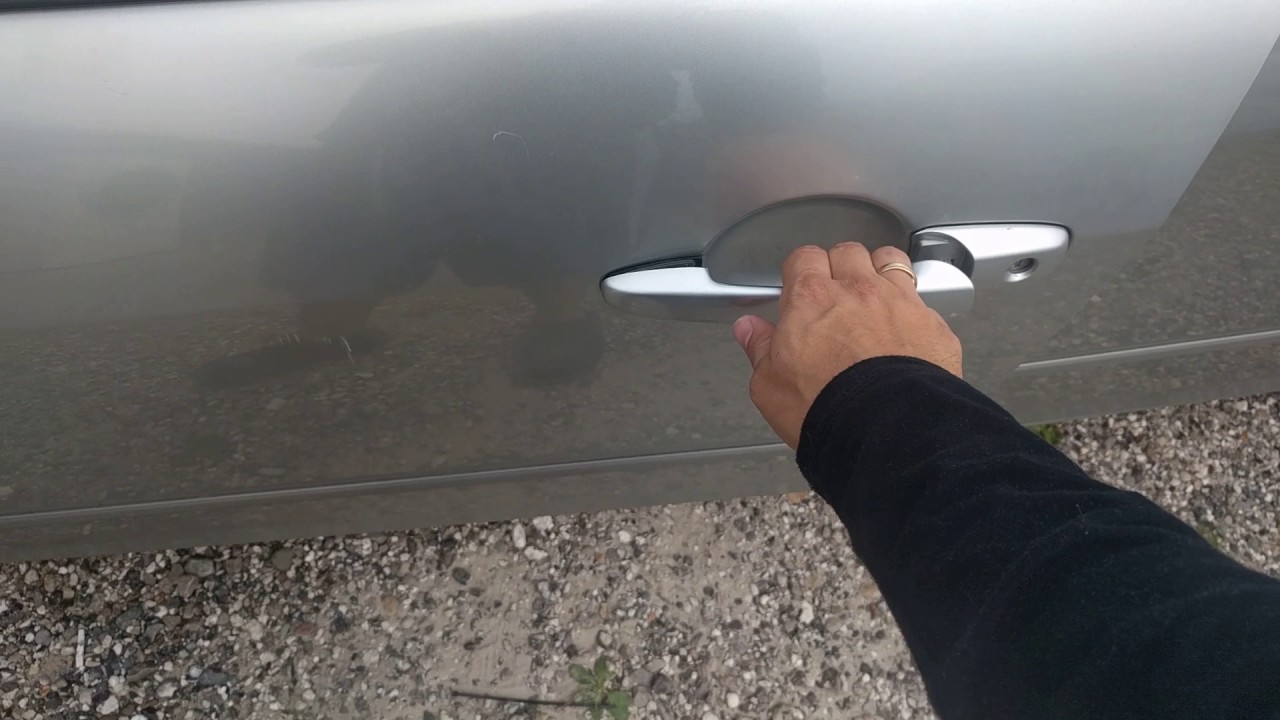

@Mariarangok That was a nice quick read through the windscreen!
It would be awesome if you could share your setup in the project section. Another option for people to follow through.

Whooos should clarify, the last link is not me, it’s a Scandinavian dude using a Next to open his ID lock and car apparently. Wish I knew how to set that up, but I’m nowhere near that technical. Luckily the lock is pretty easy to install and I’m decent with a drill.
