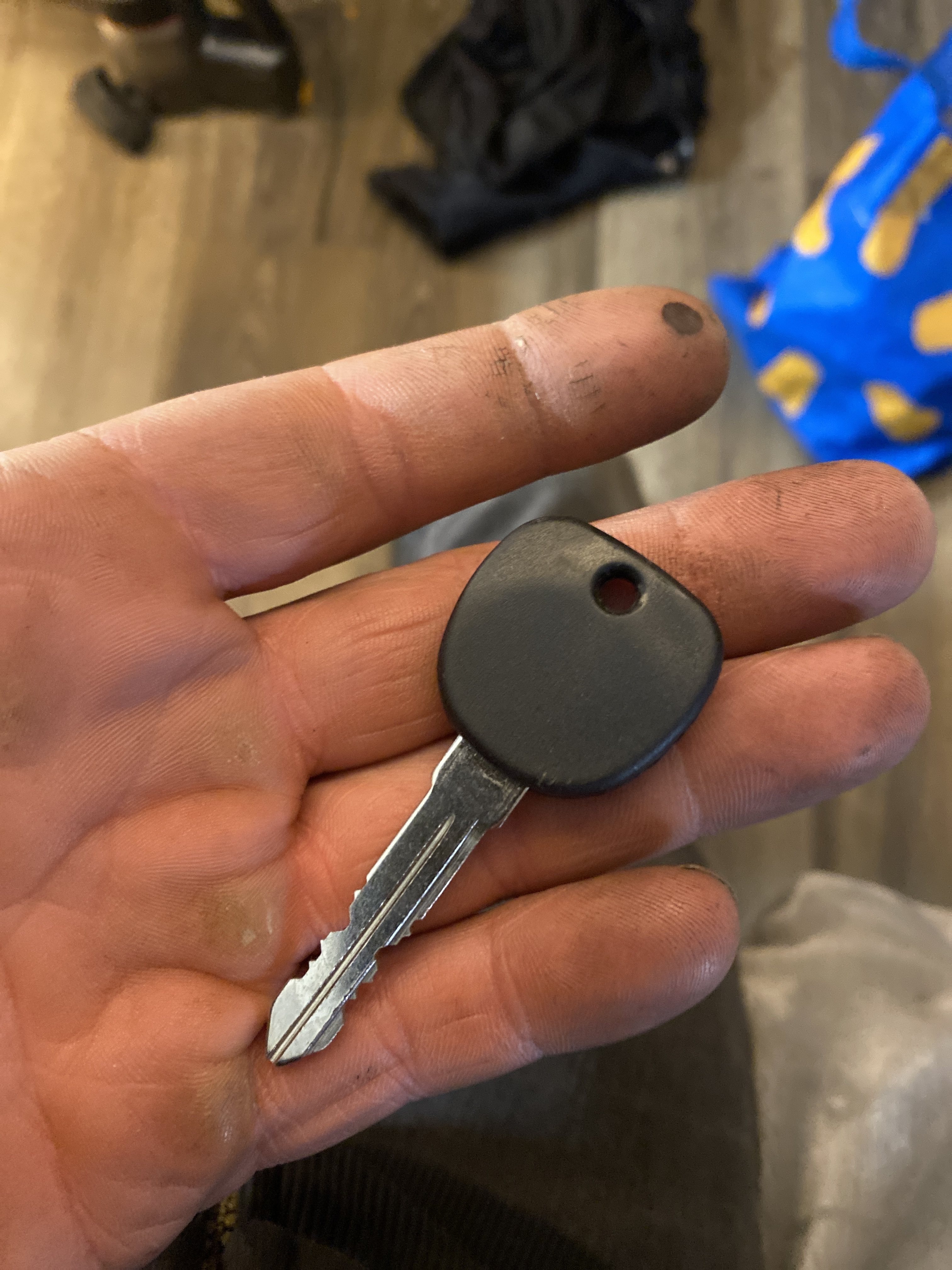

I’ve read around that my year Chevy has this thing called pass lock it’s actually built in the ignition cylinder housing I guess also called VATS these are the keys I gave for my truck they are after market because I got a new cylinder housing and also lock cylinder so do I still need to take a chip out also i do have a bypass module for the remote starts I have its an idata link here’s a pic of that too would that work?
This sounds to me like the wire may which is wrapped around is being used to read a chip in the key to disable the immobiliser. Without knowing how the key is set up, are yo able to wrap that wire around the key itself (or the key head where the chip is likely to be) and see if pressing the button starts?

I would expect it to be in the key. If it was in the cylinder, it wouldn’t really serve as a security feature. The entire idea of an immobiliser is that you can pick or force the ignition lock (or bypass it) and the car won’t start. Having the chip in the cylinder would defeat this.
Can you try putting that wire around the head of your key and see if it then starts? Your current set up is getting the engine to crank, correct?
If it starts then we can likely come up with some ideas on what to do with that wire and key so your immobiliser is not in a constant state of disabled.

Yes I just replaced the cylinder housing and the cylinder and it came with the key and I had to do the reliance procedure I’m able to start it now with just a key, but the push button will only crank it won’t start
Ok. This still sounds like an immobiliser problem with it not reading the key chip.
Have you replaced the keyed ignition system or is that still in place? If it’s in place, try inserting the key but using the push button to start.
There will be some type of antenna in the ignition housing which reads the key chip. I suspect that is what is missing on your push button set up.
