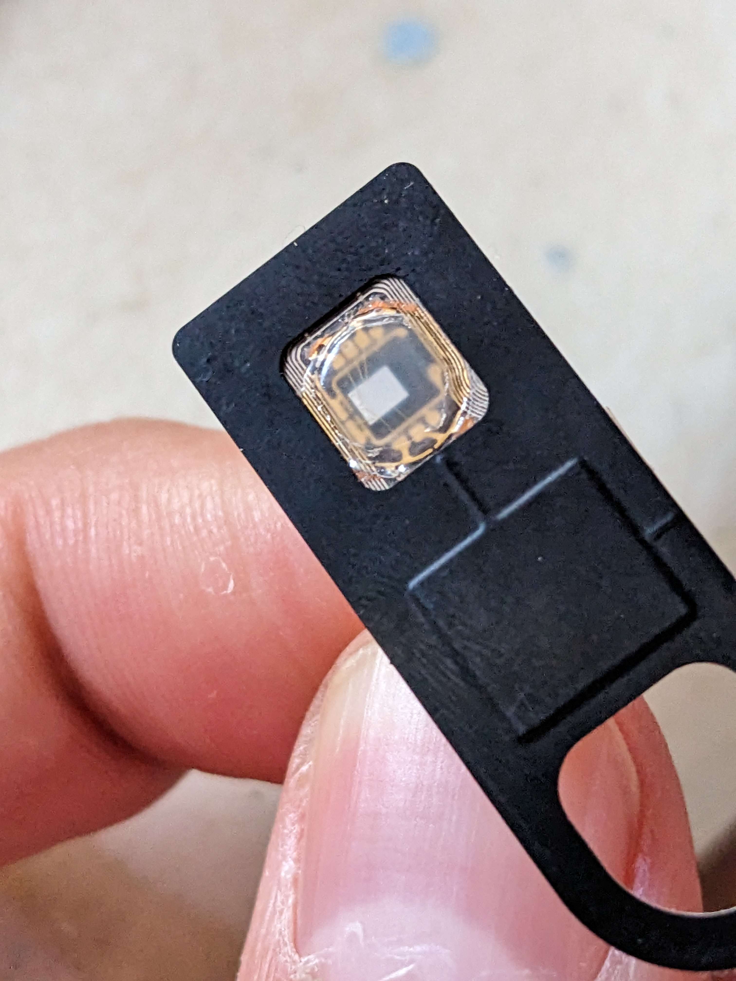

If you want I have a small (32 x 12mm) flex PCB that can work with the chips in certain kinds of cards to make them tap to pay in a smaller form factor. It would be difficult to do chip insert after you do that though.

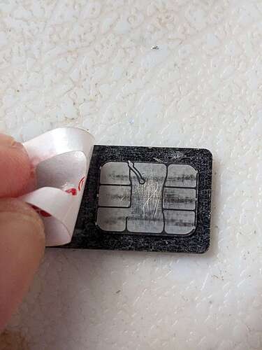

The white US bank card is the correct type for me to be able to miniaturize it. It has that small trace on the middle right pad that indicates it is a Coil on Module (CoM) card.

The conversion service that Dangerous Things offers is for converting specific types of cards into implants by encapsulating them in a body safe plastic. At the moment this option I’m presenting isn’t available through the conversion service, and you probably wouldn’t want to if it was because you’d be paying for encapsulation you’re not planning to use.
I can send you one of these resonant repeater flex PCBs that you can use to accomplish what you’re asking for. You would need to stick that card in acetone, and after ~30 minutes you should be able to pull the contact interface out of the plastic, exposing the little antenna on the back. The PCBs I made have adhesive on the back, so you can stick the contact interface to it like you see in those pictures above and it will work like a card (but with reduced read range).
The PCBs are a bit flimsy (intentionally, because they’re made to be turned into implants), so I recommend after all that is done you stick the PCB to something rigid or encase it in something for strength.
These PCBs did cost a lot to develop, so I would have to charge 15USD + shipping over PayPal for them. Anybody else who wants one I’m willing to do the same arrangement.
