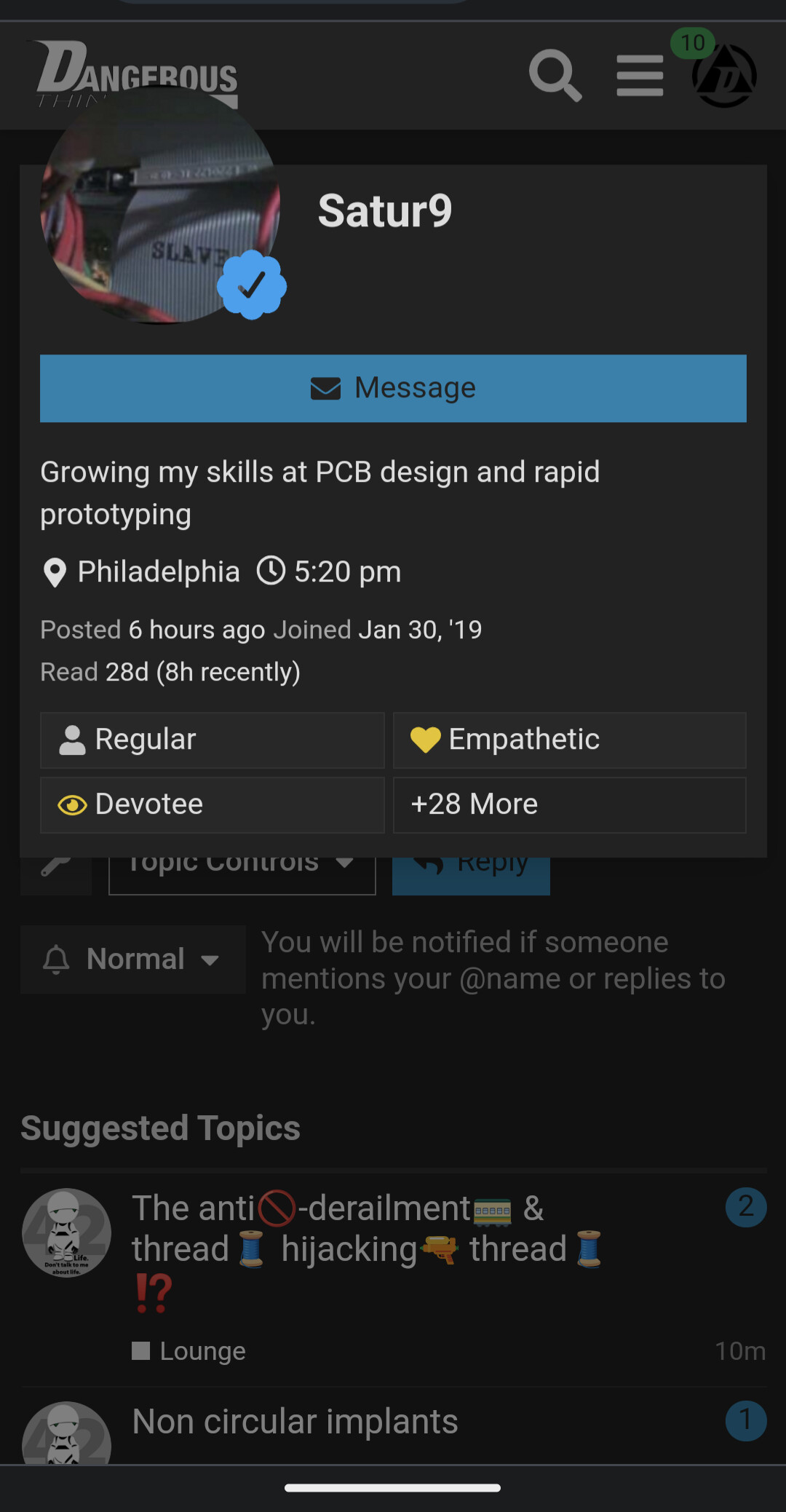

You should be able to DM him by tapping his avatar / icon. This pop-up should be displayed;
Tap the message button to send a DM

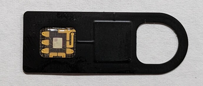

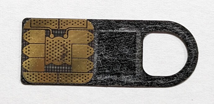

U have a photo of it?
It’s 12mm x 32mm. It’s pictured here with a CoM module placed correctly. This works like a normal tap to pay card, but with reduced read range. It still works on all the readers I’ve encountered though.

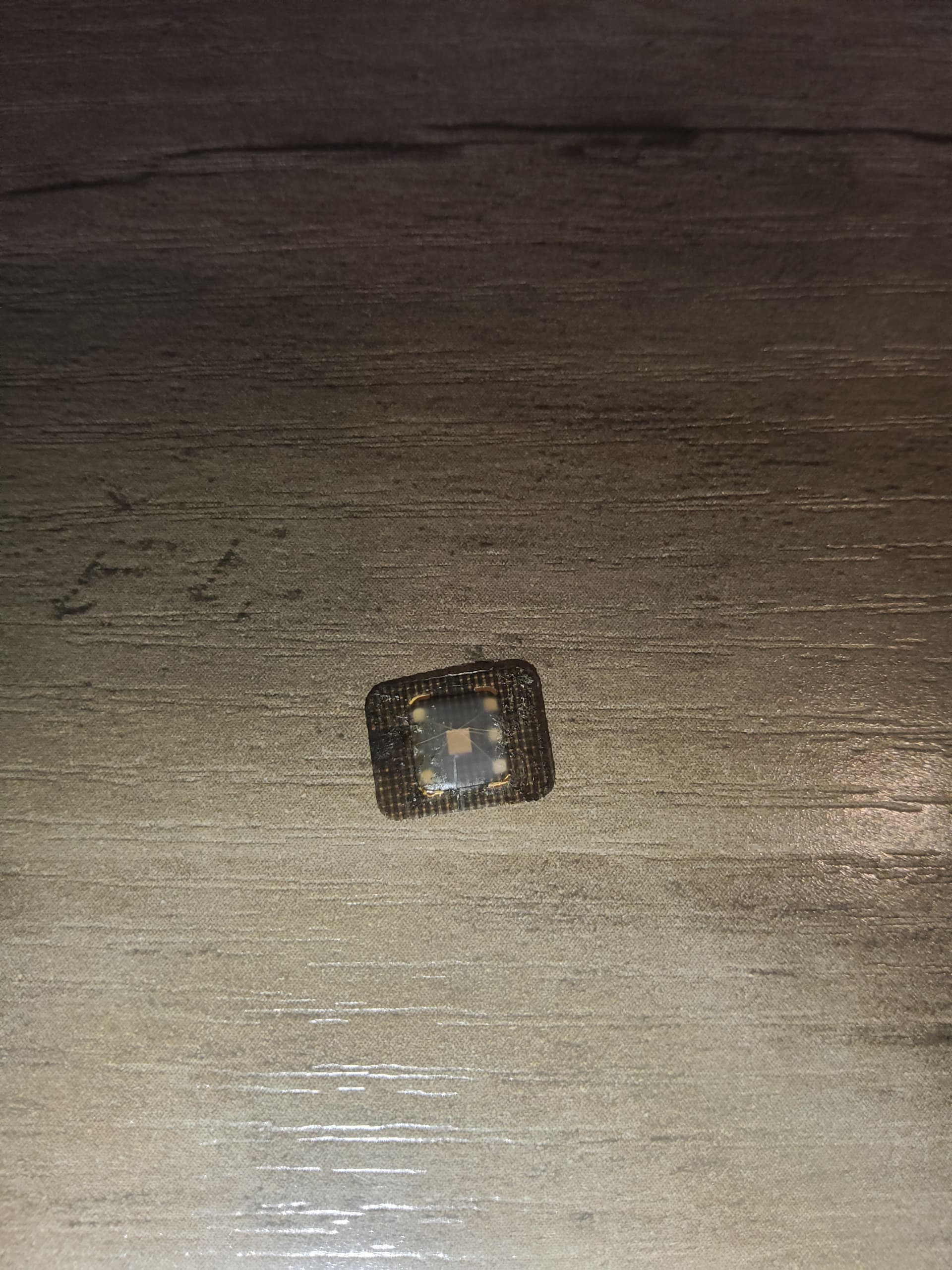

Im trying to do the exact same thing as @Trefor and reducing the size of my Credit card by taking out the chip
I have taken it out here is how it looks
I wonder if the PCB would work with this too
Nope, that is not a CoM chip. Look for the little squiggly trace that indicates there’s a small antenna on the back
Thanks for your reply
Just curious is there anyway to get this chip to work outside the card
Like soldering the antenna back on etc.
Is this what you meant by squiggly linem
Does this identify if it is CoM?
Yes
