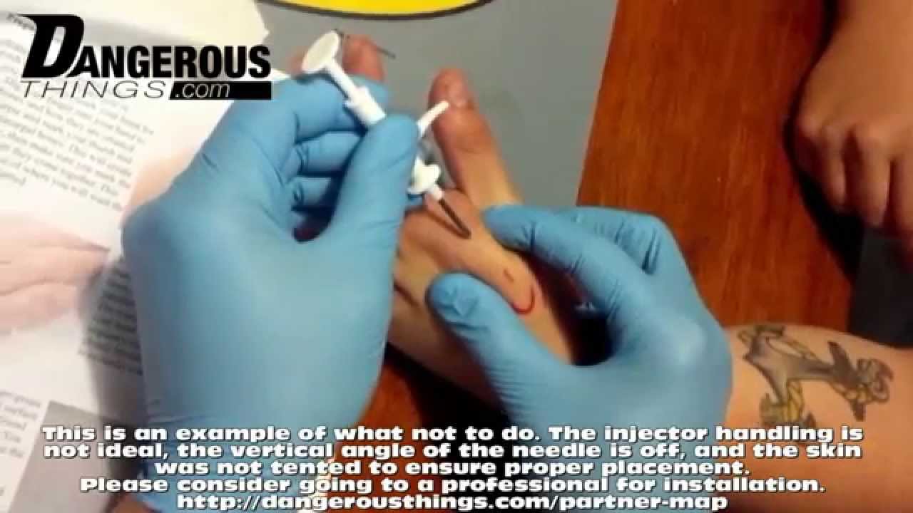

Problematic Install #1
This first video is of a professional body piercer who definitely has issues with cross-contamination.

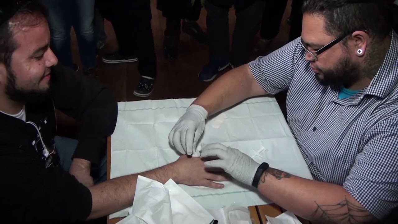

Problematic Install #2
There are multiple problems with the procedure. Primarily, the injection angle was wrong, and the needle went way too deep into tissue. The wide swath of tissue being squeezed up, vs the skin being tented upward, likely contributed to the final needle depth. The tag ended up being injected much too deeply, well below the fascia layer between dermis and muscle tissue.

Installation Event
I performed a series of installations on volunteers as part of a promotional event.
