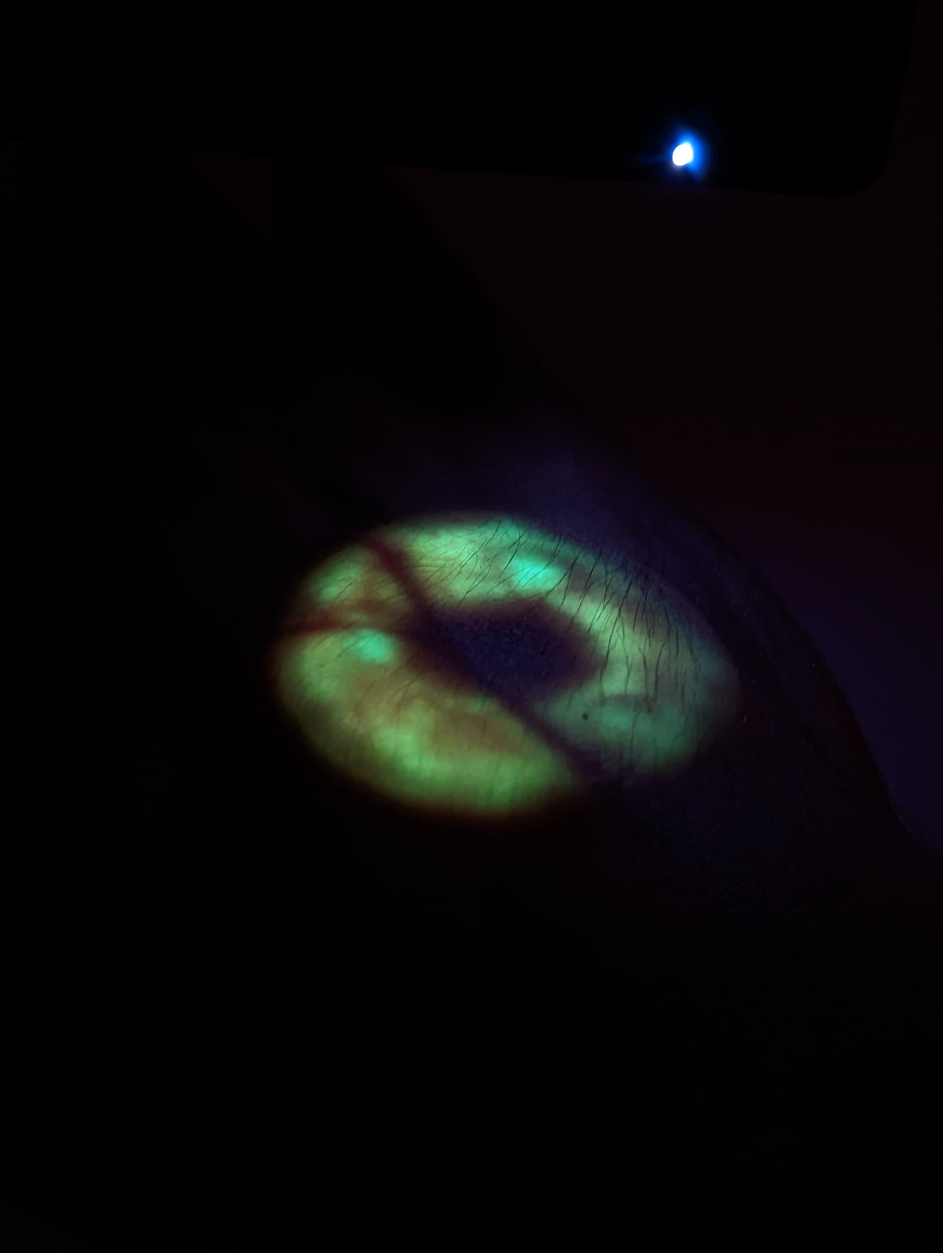

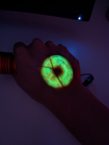

There were taken with the Pixel 6’s night mode + astrophotography. Enjoy!

I believe this was a super custom flexnext, and it was requested to add glow powder to it,
The flexnext isn’t offered any longer due to antenna issues

Also, I would temper your expectations, remember AZ said that was with the phones psuedo night vision setting… so it’s possibly much brighter than it would appear to the naked eye…. As well it looks like it was charged with a flashlight seconds before the picture…
Real world is probably less spectacular,

Afaik the powder was mixed to the resin that was used in this specific implant to make it more rigid in hope of extending the lifespan of the electronics.
It would also make it more uniform. As you might be able to see the glow is patchy and yes it was a pain to spread over the surface according to amal.

When I go to bed at night and my eyes get used to the dark for a couple minutes I can see a clear green donut. It’s dim but definitely visible for at least an hour (I’ve always fallen asleep before it goes too dim to be visibe). This is without charging it with a flashlight (just with the ambient light during the whole day).
When you charge it with a flash light it gets very bright for 5 minutes (the videos are totally representative of that) . At that point it is strong enough to shine green light on another another object. Then there is a steep drop-off in luminosity. After 15-30 it back to the level I described in the previous scenario and stays there for a long long time.
For reference 5 minutes after taking the last photo (the photo lasts 5minutes itself so 10min after charging it) it was clearly visible through 4 layers of bedsheets.
As for photo 1 (holding the flashlight) it’s not representative, pure Google algorith magic.
In the videos the ambient light is slightly exaggerated but the implant is pretty much how it is IRL.

The powder was in a resin that was used to coat the tag an leds in hope to make them stronger. The three brighter sports you see are the resin bumps on top of each led. The polymer coating was added overtop. That’s why it’s thicker and stiffer than a standard flexNext.
