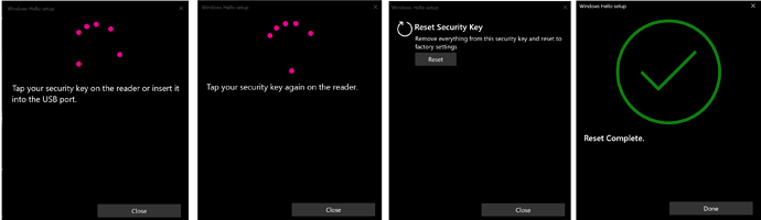

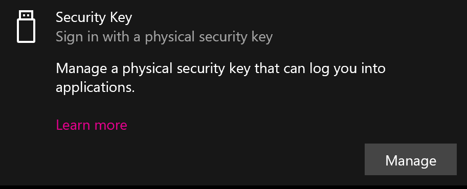

Device: PC + ACR122u
OS: windows 10 pro
software: windows hello
apex applet: fido
result. im able to read it and ‘reset the security key’ but unable to use further
pressing manage just has me reset the security key again
Windows Hello is not supported, and wont be until we finish up the implementation and acquire a certification from both FIDO and Microsoft, which is a long, expensive, and bureaucratic process.
(But we will)
… one we do plan on going through :slight_smile:
Edit: I was dumb, and didn’t hold it there long enough, in my defense “tap” doesn’t suggest to leave it there for a few seconds. Everything works when you do that.
