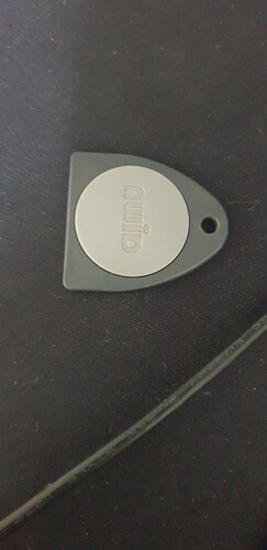

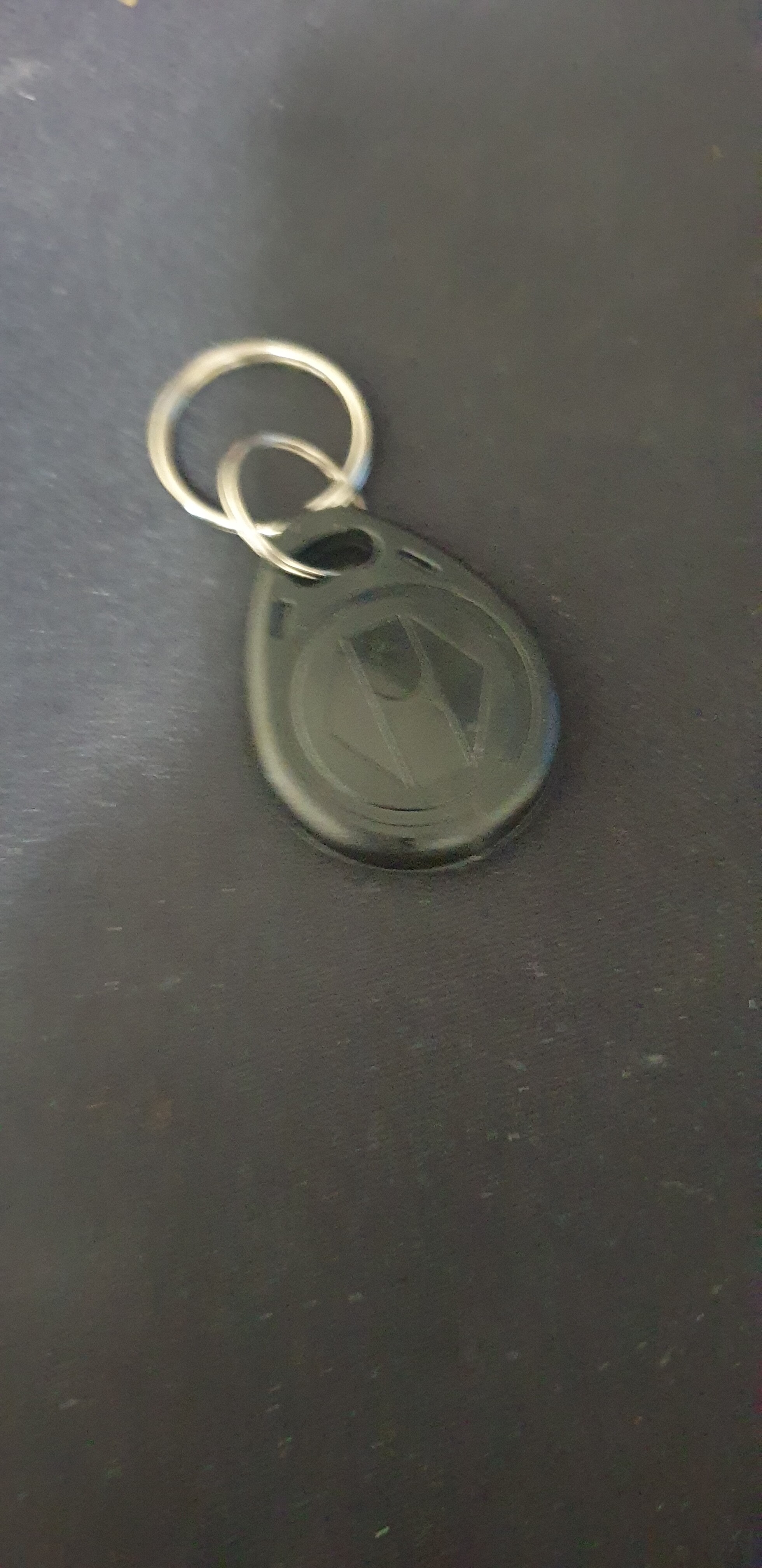

I have AWID fob which is LF and i want to duplicate with rewritable fob. But i dont know the commands

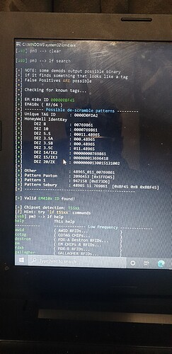

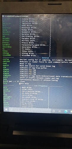

It search the key found his id now when i wrote lf clone the other menu comes up
you can paste by right clicking (not ctrl+v) :slight_smile:

Does the proxmark return the same ID when you read the T5577 after you wrote to it?
yes
Can you answer this :arrow_double_up: ?
The scan that resulted in this ID 00000BBF45
was that from this? ( My guess)
Or this?

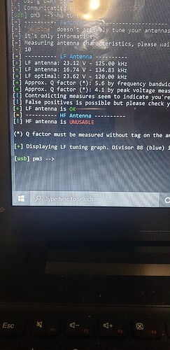

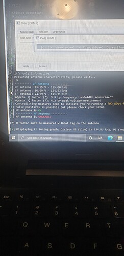

I have installed proxspace its v3.10 when i check antenna with hw tune and its shows LF antenna ok but HF is UNUSABLE
Any solution

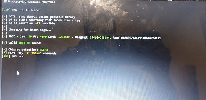

Hey guys i have read AWID fob on my proxmark 3 it shows like this.
So my question is how can i clone this ? Thanks.
lf awid clone --fmt 50 --fc 4000 --cn 1223410
Thank you soo much bro. Finally its clone and fob is working perfectly. But do i have to put different command for different fob if yes then what are the different commands.
And one more question i tried to check my proxmark 3 antenna with hw tune command and it showed LF antenna OK but HF antenna is UNUSABLE . Any solution ?
