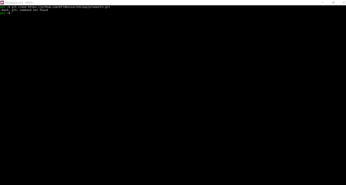

I get this message every time I try to get the Iceman firmware from Github. It cannot find it. Help is appreciated. Thank you.
Did you download the latest release of ProxSpace?
I ask because the top of your screenshot shows v3.5, but the latest release is v3.10

Check out the step by step guide and make sure you didn’t skip setting up the environment you’ll need. I followed the steps while the video played a few times and was able to get it going by following directions exactly.
If you’re interested on what’s under the hood:
“git command not found” is a Linux way of saying it has looked through all of your possible binary folders as set in your PATH environment variable for something named git, and it got nothing after searching each. /bin;/usr/bin etc…
If the rest of your Linux environment is good, you can do a “sudo apt-get install git” but I think the guide explicitly tells you to download a particular release.
I checked it out. I got everything up and ready. I had a brain fart for a bit. Thank you though.
