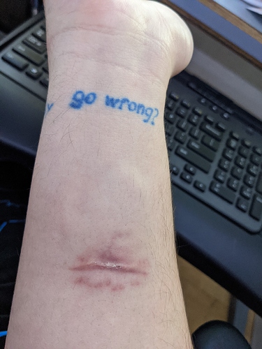

Wrist, pic attached.

Sorry to ask, but I’m not sure what I’m looking at: did you implant it on the inside of your wrist? As opposed to the wristwatch side that is, of course it’s inside your wrist :slight_smile:

Valid point, the way my wrist is bent there is confusing. Yeah, watch clasp sits over “Wrong”
The good news is, your failure now makes sense :slight_smile:
The bad news is, it sure looks like a failure of the bullseye :frowning:
