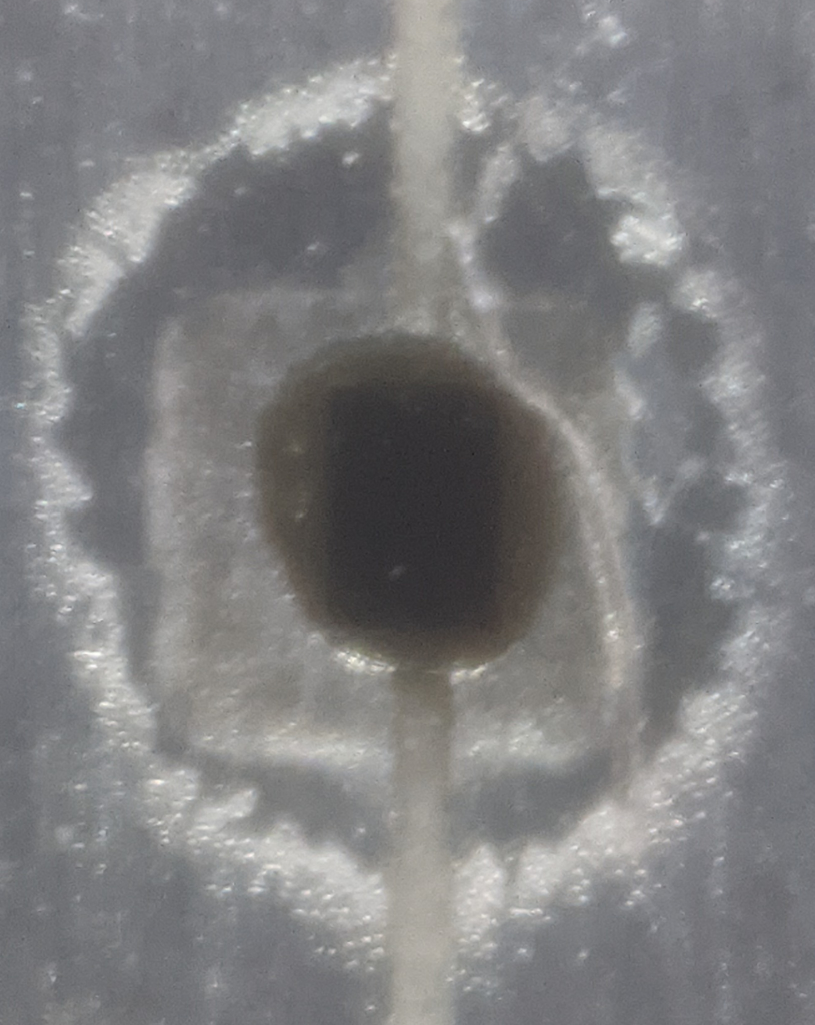

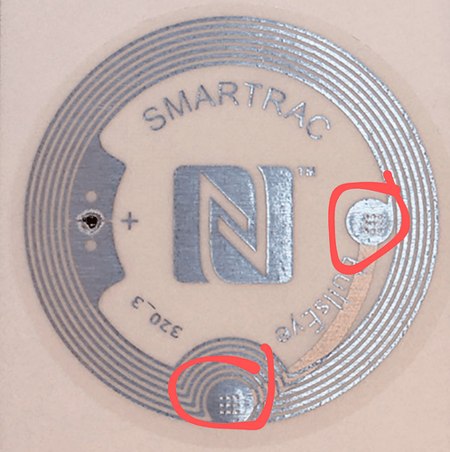

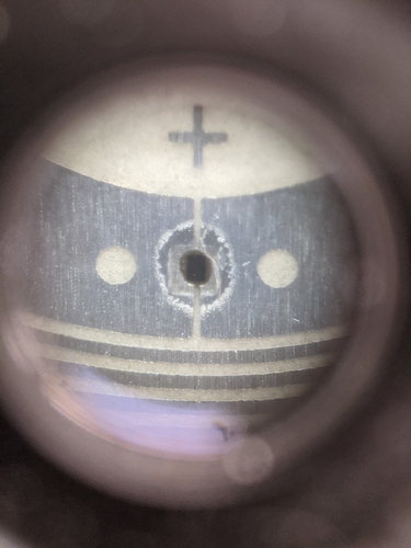

Actually it’s not going to change much about the center. The NTAG216 chip is a tiny black spec off to one side and it’s attached to the antenna using flip chip process. It’s actually super interesting as they use anisotropic or “z-axis” glue that is only conductive in the z-axis. This means you can drop a glob of it down and slap an IC with pads overtop pads on a pcb and just glue it down and it’ll work. This is a close up of the ntag216 on the bullseye… with a small PET film overtop creating a kind of halo around it.
The thought is that this fragile little connection is being broken. The remedy I will attempt is to remove the pet film over the chip and apply a thick wide blob of UV cure resin overtop to help protect it. More labor intensive for sure.

It’s also possible the barrels of these vias are cracking. Depends on if they used a riveting technique for the flex PCB or whether they used conventional electroless copper techniques.
