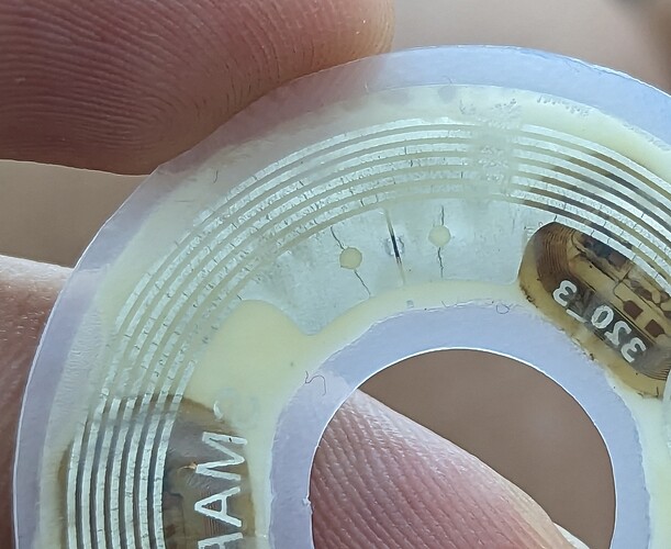

Here’s a closeup of the deterioration from flexing on the bull’s eye tag on my do-next. I think the two large pads are split in half where the little hole is. I can also see similar cuts throughout the thin antenna trace. (~2 years).

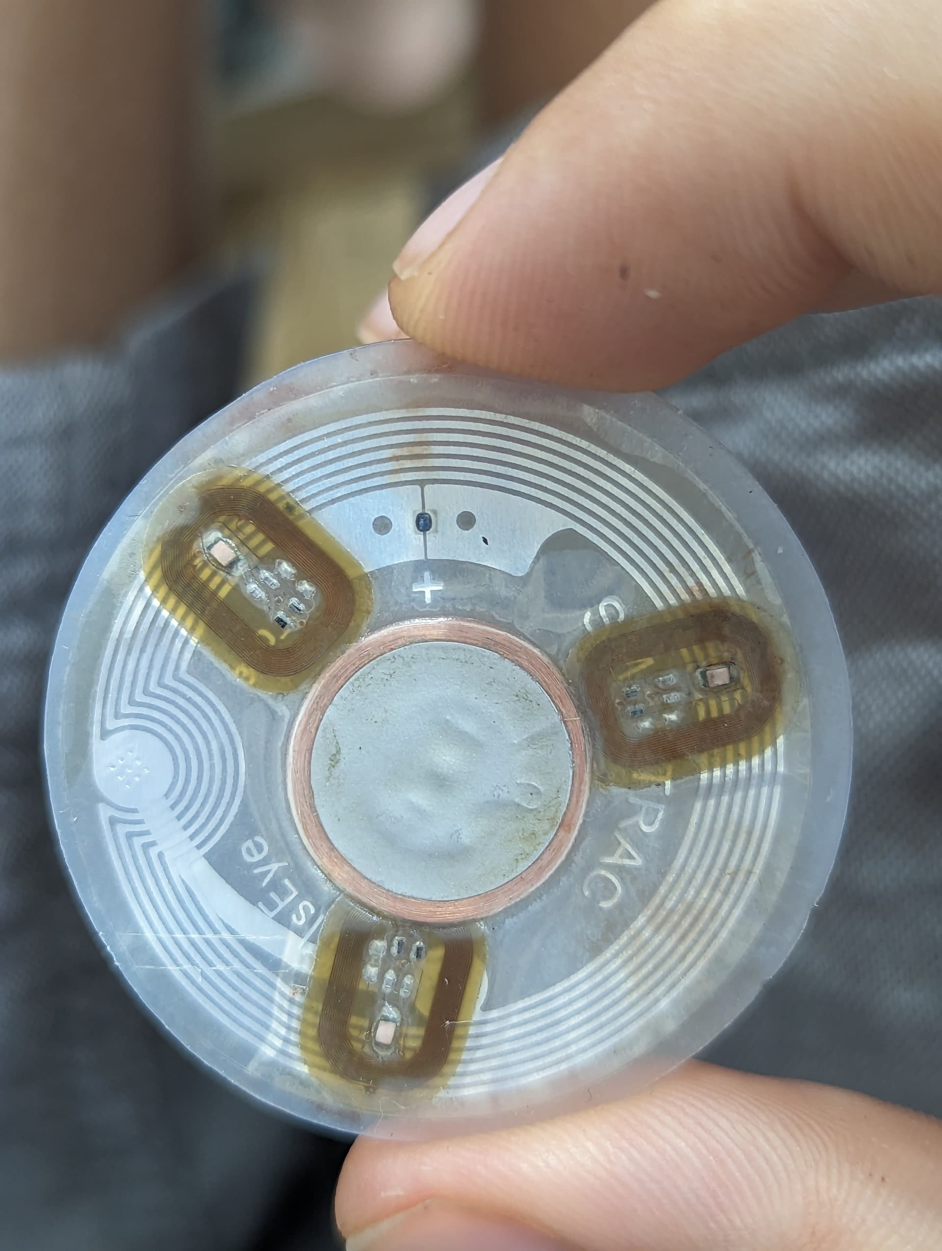

For reference here’s the still functional tag of my first flex next that only stayed in-vivo a few months
that antenna is traaaaashhhed… wow. i’m actually surprised it got that bad from what could only be assumed as “minimal flexing”… but just enough that it clearly obliterated the entire antenna. it is just printed silver ink… but still… wow.
I’m not a fan of printed silver ink but it’s used in many keyboards, monochrome LCDs, and calculators. I think that Casio managed to make some models entirely out of that stuff.
