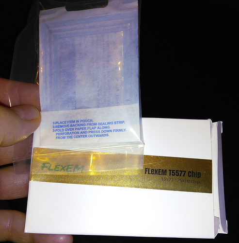

Amal, that there is my yet unimplanted FlexEM: Is that the same packaging? Should I hit the help button also or is it cool?
Same issue… the flap is there. Hit the help button and we’ll get it sorted. Include your flexEM order number I’m the request and if you have moved since the order include your new address.
Okay very groovy. I’ll get right on that.
Thanks!
