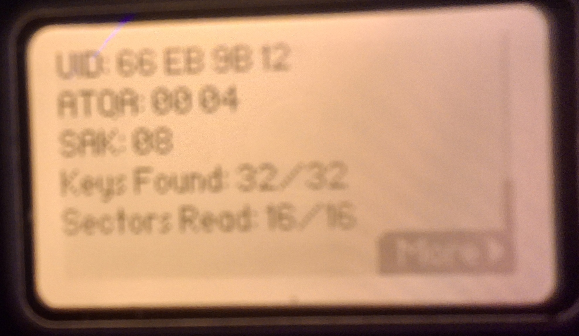

I’ve found myself at a resort in cabo mexico and i would like to copy my key card and maybe write it to my implant ( next & xmagic) i have a flipper with momentum
Its not worked so far. I emulate and it’s not working also im a bit tipsy btw

What have you tried so far? Is your xMagic a gen1a?
Not working how? Does the reader react to it at all?
I get no lights on the door reader when i press emulate
Im not shure of the gen1 or 2 but its les than a year old
Good sign, means it could be a bad connection instead of a bad emulation
Apps > NFC > NFC Magic > Check Magic Tag

Ok flipper says success on the write
But if i can’t open the door with the flipper on emulate hows it going to work on the implant?
Since the flipper didn’t seem to react as a bad tag, it seems to me that the door just wasn’t getting a good connection to the flipper
Whether you’ll be able to get a good connection with the xMagic, who knows

flipper emulation sucks at mifare classic on non spec sturn readers (low quality, battery powered, design over function, bunch of reasons) we made a command for this
TLDR; the flipper emulation not working is not exactly abnormal.
if your implant isn’t working: you’ve not got sak swapping going on your key so that’s not the issue with your implant. it is likely the reader is too low in quality/design to be able to communicate with an implant so small.
unfortunately this does just happen sometimes not all readers love implants.
