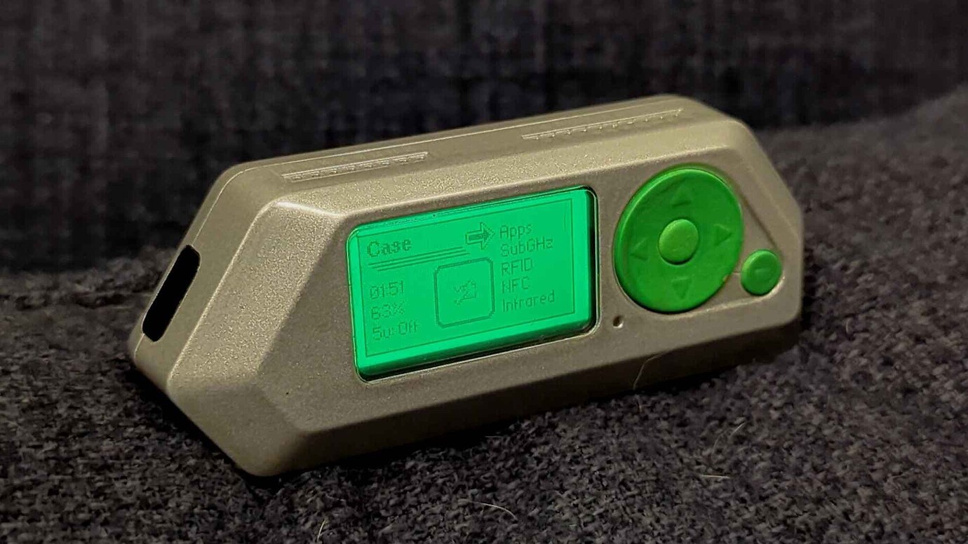

Flipper RGB Mod :flipperzero_white:
If it had stayed like that, I would have been fine with it, but it turned really matte after curing.

Sure, I can print and paint another shell and buttons. I’ll send you a message when I get around to it, probably in the next few weeks.
Might have been the resin formulation itself, but it may also have been the composition of your wash station liquid. If you want really clean prints it can be worth using clean liquid and even upping the concentration of iso propyl. It can damage the surface structurally, but makes certain resins really shine
Id be happy to have it right out of the wash and cure, no paint.
