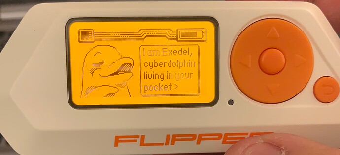

Well, mine arrived…
The good: it reads my NFC ring no problem.
The bad:
  1. so far it doesn’t read my LF ring.
  2. My flipper is called p00nu.
Make of this what you will.
if your LF ring is anything that’s not em410x, em42xx, HID26bit (h10301) or indala you’re SOL for the time being
Forgot to mention my flippers name
