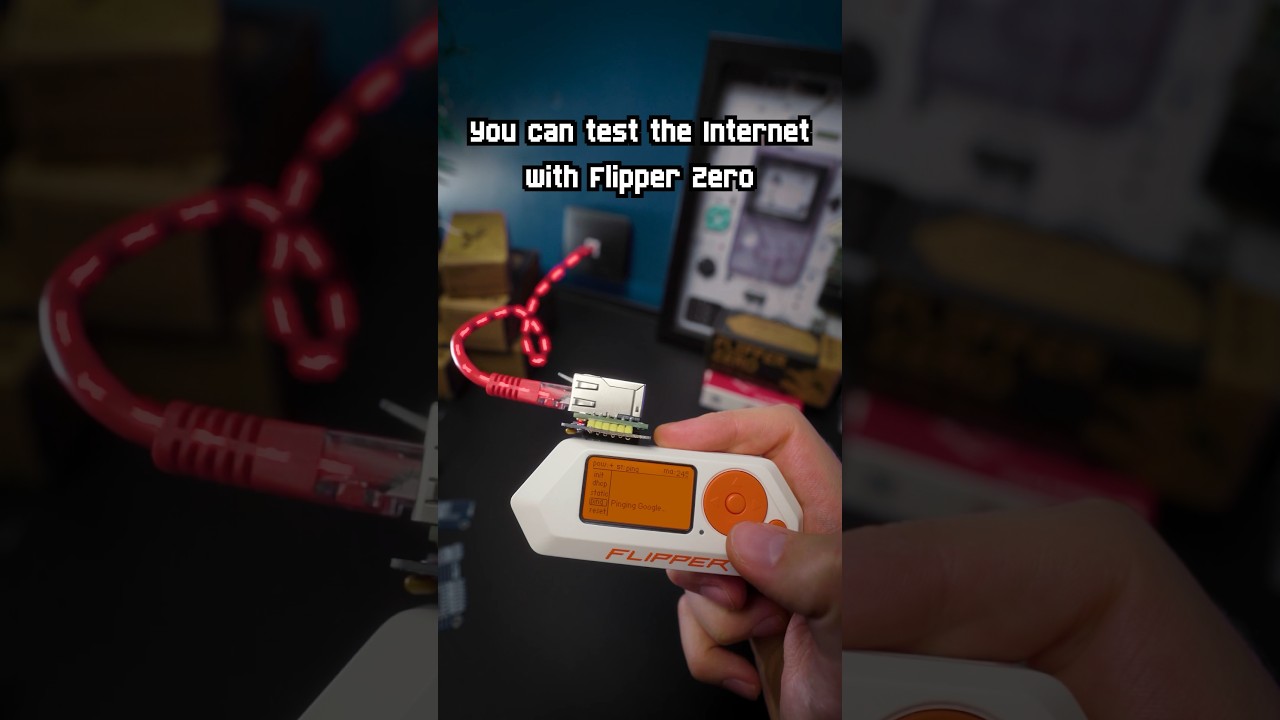

I just saw this potentially handy little mod for the Flipper
