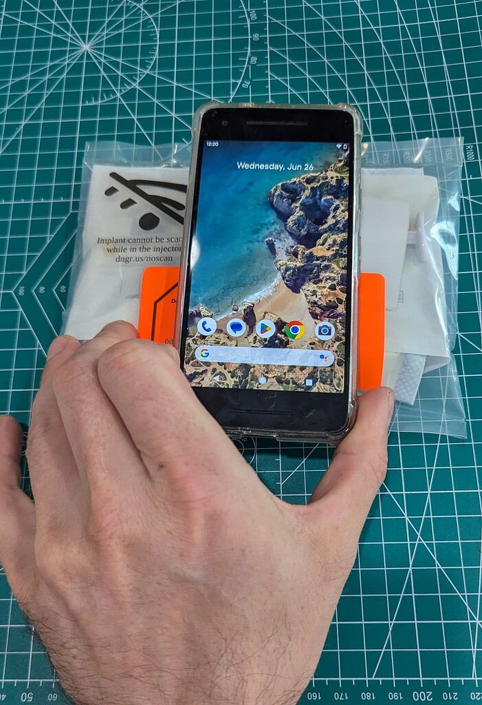

@tac0s Been a while since I bought an implant, but is this disclaimer included anywhere with the implant when it’s shipped? Might be worth having a bright orange business card with that warning and a qr code to the forum included with each purchase
:wink:
Edit: Happy to fine tune it if ya’ll have some better phrasing or other ideas.
Great minds and what not :grin:
It looms like the orange sticker just says the contents are sterile, and the bag just says you can’t scan the implant while its in the syringe. Is there anywhere in the packaging that explicitly states to wait a few weeks before scanning?
Not at the moment. This has cut down on those posts dramatically. Rather than turn it into a smattering of stickers covering the whole thing, I’m more inclined to do a “watch this first” video link. Try and keep it <2 minutes. But if we all think more stickers is the better approach… Happy to give it a go.
I think asking the customer to scan a qr code and watch a video is a bit of an ask compared to reading a quick statement, but I agree the video will be more informative
It makes sense, however, the more we put on there, the more likely a message is to get lost in the noise. My rationale was, “I can get away with one more for sure, but this is a slippery slope.”
We’ll let it marinate for the weekend and I’ll circle back Monday.
