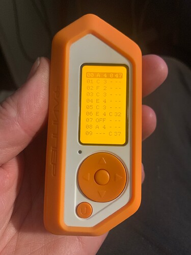

I updated the firmware, played around for a bit, then loaded Xtreme and was exploring that when I ended up here…
No combination of key presses seems to dislodge it.
Any ideas on how to get out of here?!
Have you tried DFU mode? It’s for the stock firmware but presumably Xtreme left that in as a safety measure:
But first, try doing the following:
  1. Unplug the USB cable from your Flipper Zero if connected
  2. Press and hold the OK and BACK buttons for 30 seconds. It is normal if your Flipper Zero has no indications on the screen.
  3. Connect your Flipper Zero to a computer via a USB cable. The computer should detect your Flipper Zero as a DFU device.
Thank you both for the support. Rebooted and it all seems to be working fine now. :rat:
