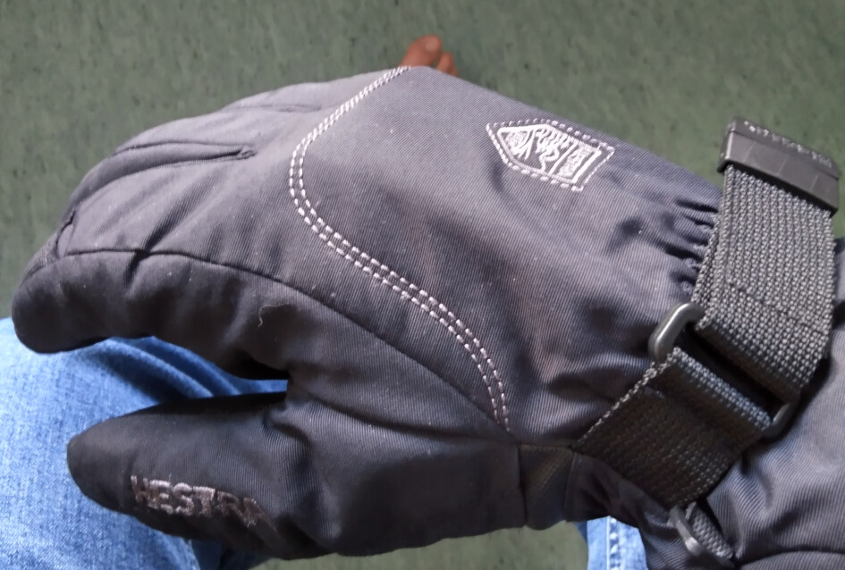

Okay so I took my PM3 to work with me this morning. I’ll grab a reader <-> card exchange in the bus tonite with my NFC gauntlet of doom:
The PM3 and the bus card taped to it just about fit inside my glove, which shouldn’t look too odd since it’s like 5 degrees out today. The lump inside the glove does look odd though. Hopefully the driver won’t get suspicious.

Also, I had the Proxmark3 in the palm of my NFC gauntlet of doom this time, and my legit transport card on the back. So I tried it once by palming the reader (and staying there for an inordinate amount of time to get a good read), then flipped my hand around and paid for my fare normally. The drivers weren’t too impressed with that trick, but they said nothing.
Finally, I discovered that a PM3 is a great hand warmer for the winter inside a glove. I might buy another one for my other hand
