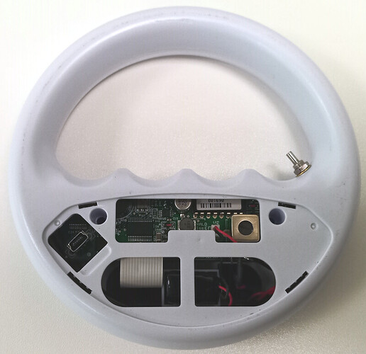

I installed a reset switch on my Halo, so I can crash it again and recover it easily:

Could you share the USB commands/API you received from iD Porte? Just got a Halo scanner, and wanna play with the USB interface
amal
September 9, 2026, 4:09pm
25
That account is anonymized and not active on the forum anymore but relevant code is;
if c in "\r\n":
if uid:
main_in_q.put((LISTENER_UIDS_UPDATE, (listener_id, (uid,))))
uid = ""
elif c in hexdigits and len(uid) < 256:
uid += c.upper()
def halo_listener(main_in_q, listener_id, params):
"""Read UIDs from a Halo Scanner connected to USB and send the list of active
UIDs to the main process
# Modules
import serial
setproctitle("sirfidal_listener_{}".format(listener_id))
log(VERBOSITY_NORMAL, listener_id, "Started")
The halo.py file shown in the video is;
halo.py (1.3 KB)
