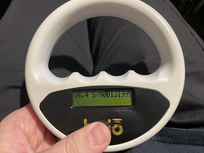

I tested with my xEM implants (T5577 chip in “EM mode”) and some LF keyfobs that came included with the xEM access controller v1.
My Halo reader has firmware version 6.4
Yeah, mine seems to read genuine EM4xxx tags and T5577 tags en EM mode just fine too. I wonder if the manufacturer knows exactly what their device can do. It’s entirely possible that they sourced the reader part of the device from a third-party and only test EM4305’s on it, because they only care about the animal tag market.
