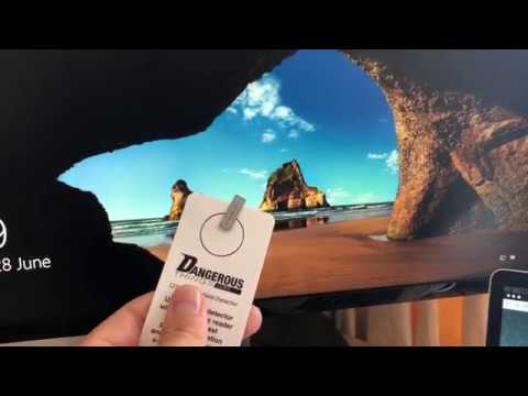

Correct !
This was a couple of years back but had it setup with the free version for demos etc.
Not a Vivokey but an option!
https://www.biohackingforhumans.com/2020/02/rfid-windows-10-unlock.html
Islog Logon works for a standalone PC, but it doesn’t handle domain logons. At least the community version doesn’t. That’s why I wanted to evaluate - and pay for, had it worked - the non-free version. But apparently them guys don’t want nobody’s business.
